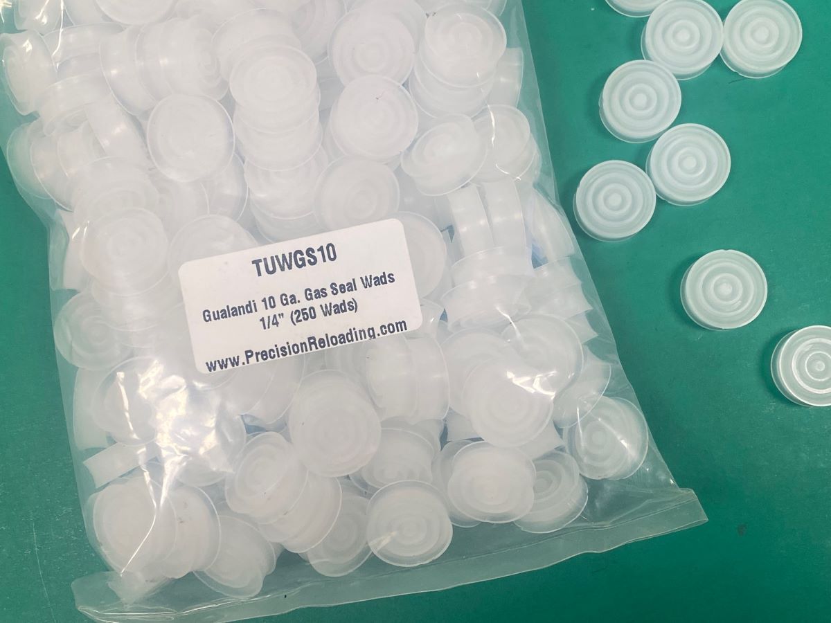

Anyone into loading heavy charges of bare lead or bismuth etc shot into 10g 2-7/8" hulls would do well to use a gas seal between the powder and fiber wad(s). Only 1/4" thickness and very efficient at "sealing the gas chamber" whether with folded or roll crimps. frank

Looks like a modern-day incarnation of the old Alcan PGS wad that replaced the nitro card wad early in my shot shell loading career.

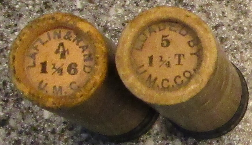

Probably forty years ago a seller at the Great Southern Weapons Fair at the Richmond Fair Grounds gave me a cigar box of old shotgun shells that he didn't want to carry home. What a terrible thing to do to a person!! Infected me with the shotshell collecting disease. Some shells from that cigar box.
Some Union Metallic Cartridge Co. 10-gauge shells from the first decade of the 20th century. NEW CLUB black powder --

NITRO CLUB bulk smokeless powder --
