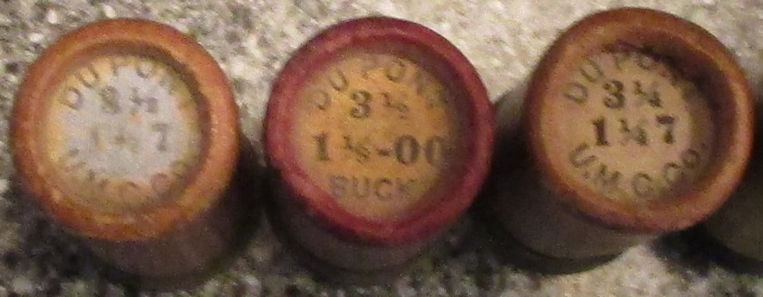

Probably forty years ago a seller at the Great Southern Weapons Fair at the Richmond Fair Grounds gave me a cigar box of old shotgun shells that he didn't want to carry home. What a terrible thing to do to a person!! Infected me with the shotshell collecting disease. Some shells from that cigar box.
Some Union Metallic Cartridge Co. 10-gauge shells from the first decade of the 20th century. NEW CLUB black powder --
NITRO CLUB bulk smokeless powder --
Winchester REPEATER of pre 1919 era loaded with Infallible dense smokeless powder --
REPEATER 10-Gauge, 28-grains Infallible, 1 1-8-ounce, #2, WRA Co.jpg (97.84 KiB) Viewed 11786 times
Posts: 2826
Re: Western 1 5/8 oz. wad column
Those are great, Dave. My grandfather used to tell me about using New Clubs hunting quail on our farm. Many years after he died I found a New Club shell head in a field here. I saved it because I know he was likely the last person to lay hands on it, as he pulled it out of the chamber, until I picked it up many, many years later. The New Club loads have always held a special place in my memory because of the stories he told me.
