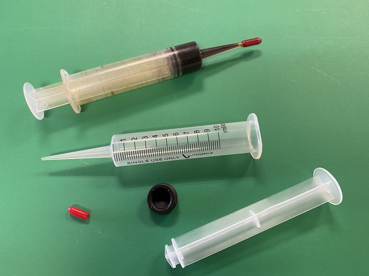

For lubing double guns as described here I use a 10 cc size polymer syringe, Brownells # 081-100-610 @ $14.99 for 6 syringes, retail cost. Remove the plunger, add some grease, no need to fill it completely, then replace the plunger. Let it stand with the tip UP in a warm place for a day or so; the grease will migrate back against the plunger. Then the air will be expelled when you push on it. For heavy grease I'll snip about 1/4" off the tip to get a larger diameter orifice.

Frank: I hate to ask this, but your photos really do help when you are teaching. Thanks, Ralph
Ralph
Has thanked: 1232 times
Re: grease
Ralph, I added a pic to my second reply.

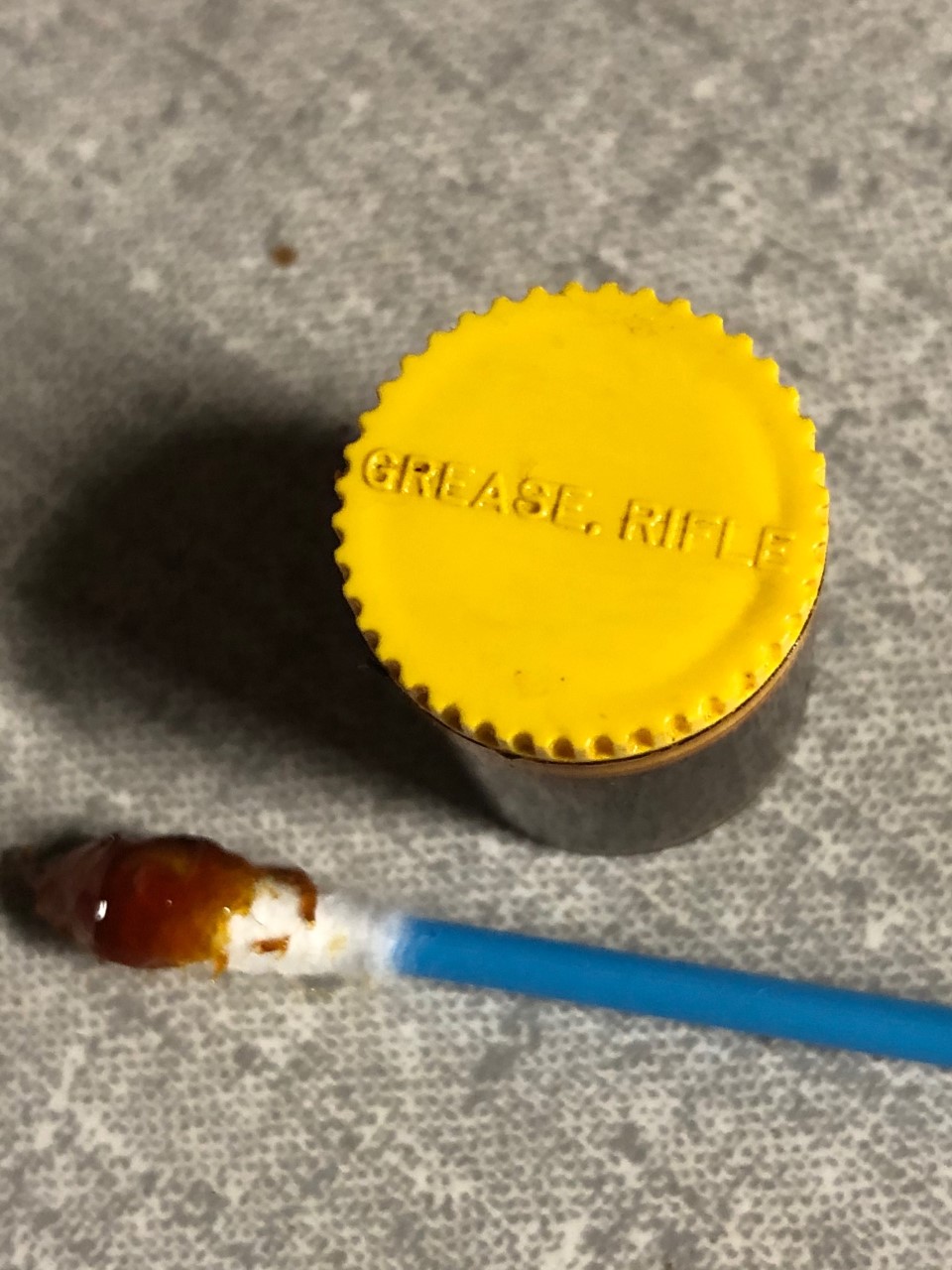

I've never thought too much about it and always used grease from one of those little milsurp grease pots that used to be ubiquitous at gun shows.
