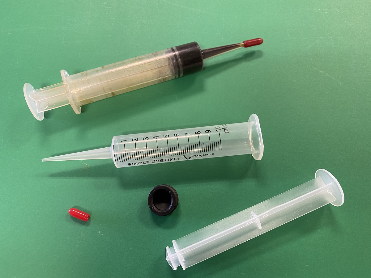

Jeff, good thinking. That's a great idea for percussion revolvers.
For lubing double guns as described here I use a 10 cc size polymer syringe, Brownells # 081-100-610 @ $14.99 for 6 syringes, retail cost. Remove the plunger, add some grease, no need to fill it completely, then replace the plunger. Let it stand with the tip UP in a warm place for a day or so; the grease will migrate back against the plunger. Then the air will be expelled when you push on it. For heavy grease I'll snip about 1/4" off the tip to get a larger diameter orifice.

Frank: I hate to ask this, but your photos really do help when you are teaching. Thanks, Ralph

Ralph, I added a pic to my second reply.
