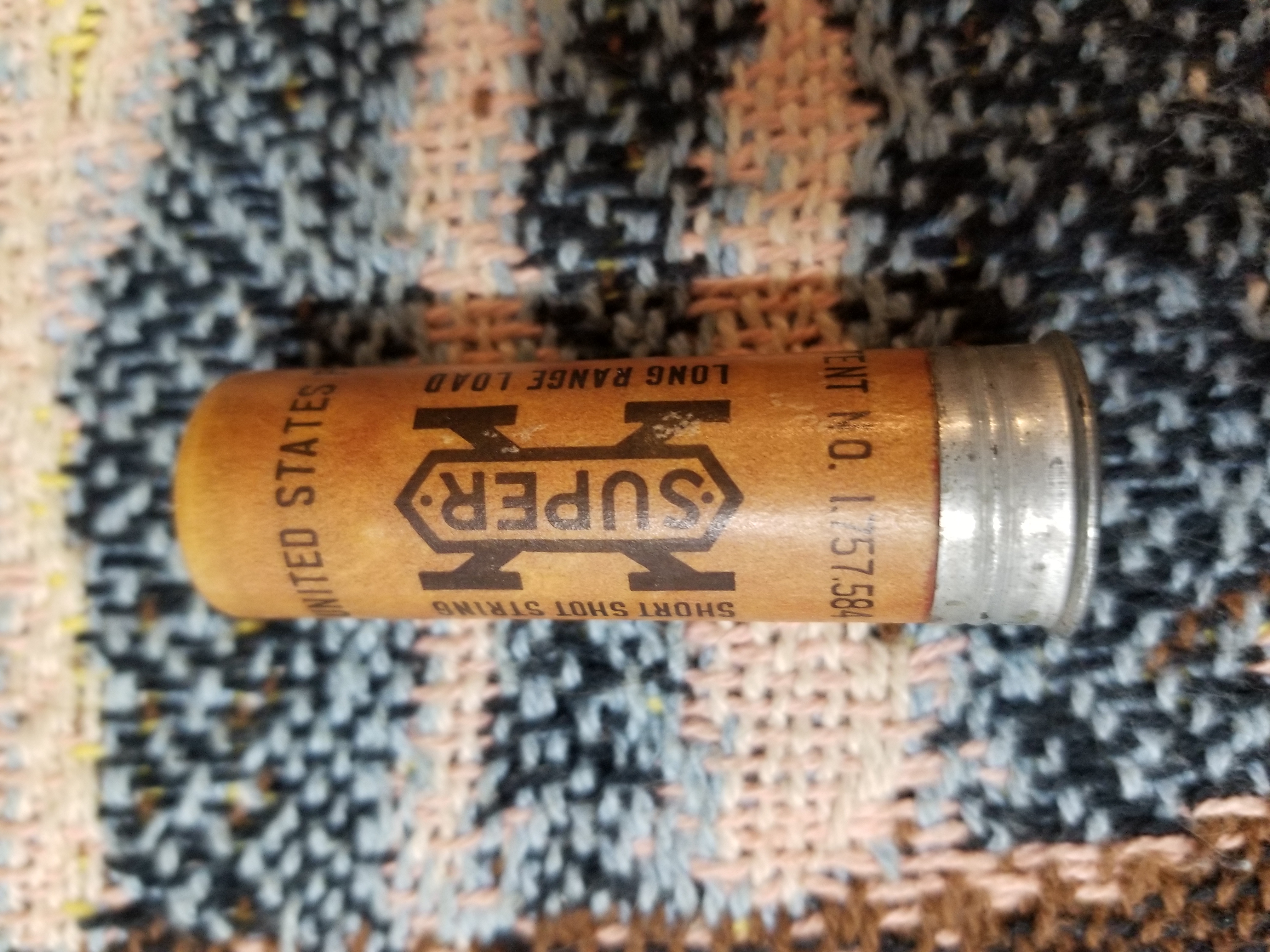

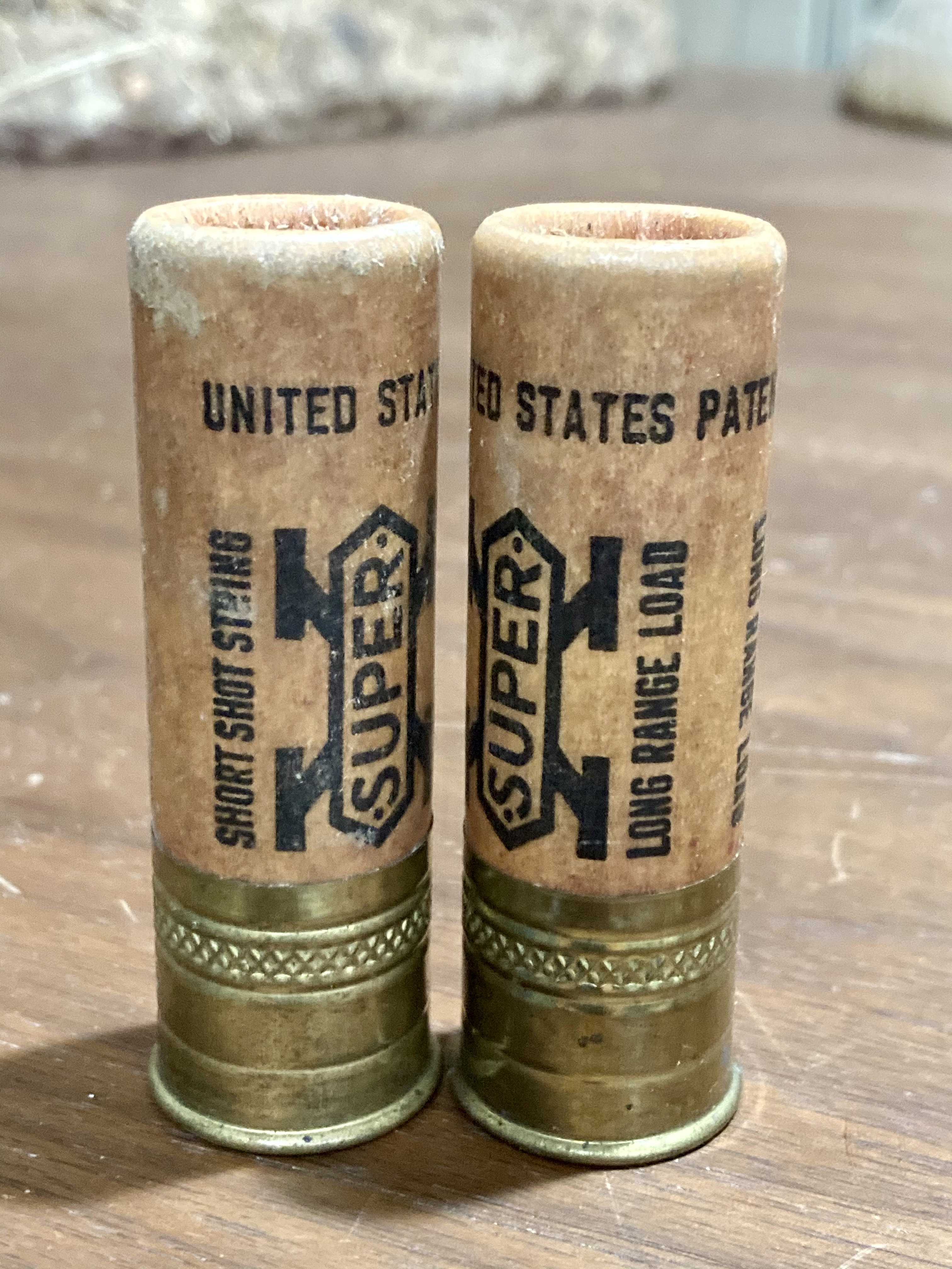

A few years ago, my uncle gave me bag containing a handful of shotgun shells. Most of them were “plastic”, but there were two “paper” shells. Does anyone know an approximate date of manufacture? Any opinions on how a particular shell can have a short shot string? Jeff

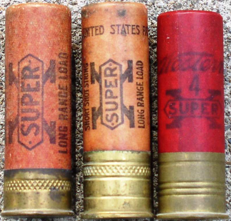

Western Cartridge Co. changed from the FIELD case (left) for their Super-X loads to the somewhat higher brass that is headstamped Super-X (middle) circa 1936/7.
Then about 1948 they quit the Western trademark knurled canular and went to the style on the right.
Short Shot String was an advertised feature of the Super-X load from the beginning --
