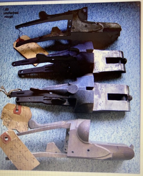

........well, Exhibit A.... I owned a bunch of unfinished frames once. Sorry these pics are poor but I took a picture off one of my old laptops where the pictures are. Anyway, the hinge pins are in the frames waaayyyy before they were finished.
- Posts: 5188
- Has thanked: 1228 times
- Been thanked: 1880 times
- Posts: 1729
- Has thanked: 131 times
- Been thanked: 193 times
Re: Fox hinge pins
............ absolutely!!
