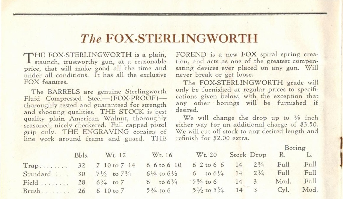

All the A.H. Fox Gun Co. catalogues included the Brush, Field, Standard and Trap terminology and the 1930 Savage Fox catalogue --
which was a paste-over on the cover of the last A.H. Fox Gun Co. catalogue. Beginning with the first Savage produced A.H. Fox catalogue the terms were gone.
