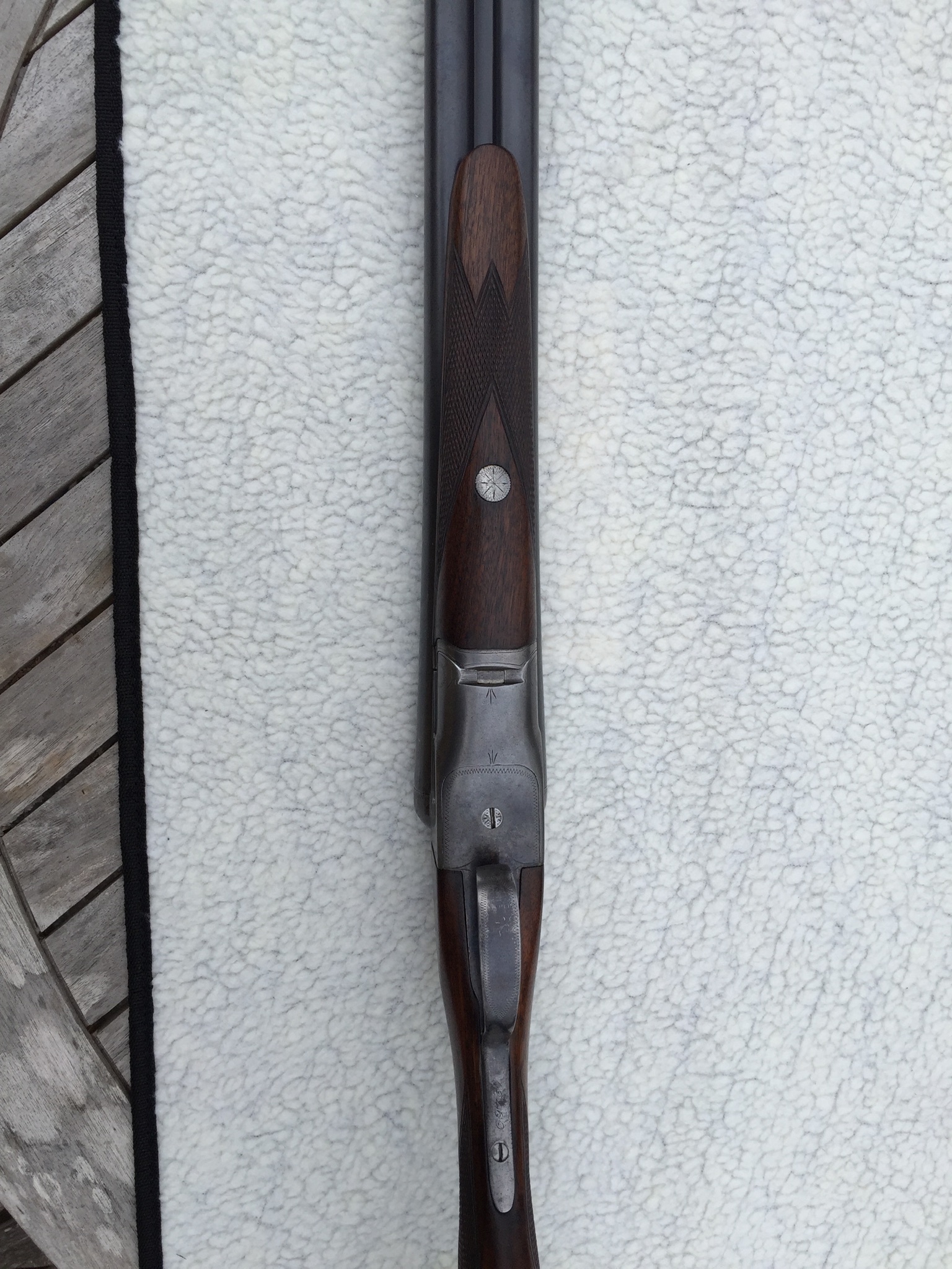

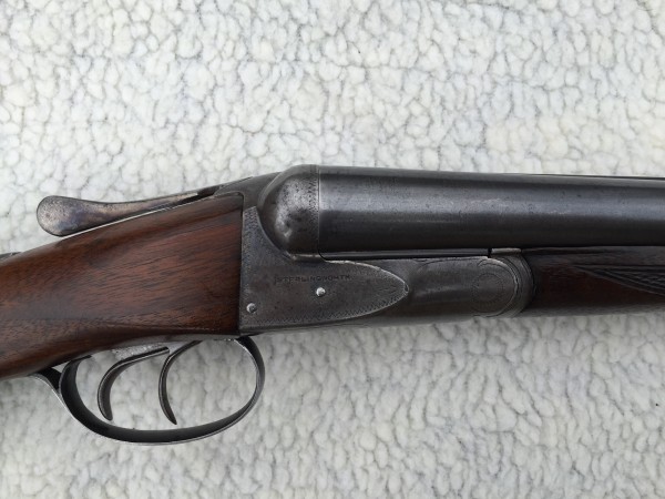

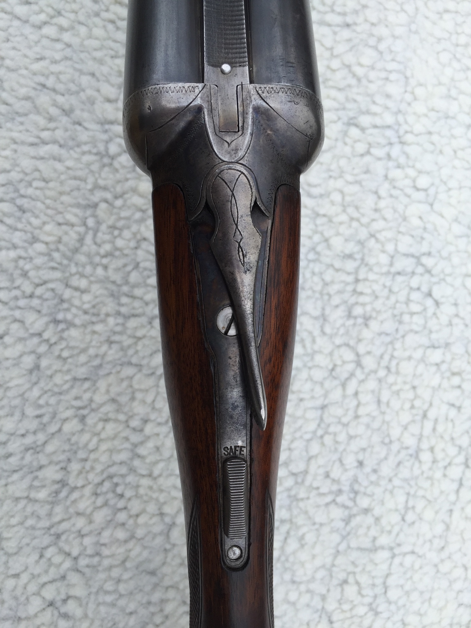

Pics for you, just because.
Gun has now been rebuilt and springs replaced - I’ll let you know how I get on. I’ve also bought some lighter load 2 1/2 to minimise any pressure issues.

- Posts: 5188
- Has thanked: 1228 times
- Been thanked: 1880 times
Re: unable to break Sterlingworth
32-inch 12g Fox Ejector gun = very desirable. It appears someone's been inside as the main frame screw and rear tang screw look like they've been replaced. Interesting placement of that rear bead. Just one other comment, the break lever is too far right thus the locking bolt will have limited bearing on its mating surface in the barrel extension. You might ask your gunsmith to adjust for more contact to bring the lever left but still a bit right of center. Often when the bolt contact isn't right a Fox will try to pop open after firing, or the opposite extreme where it's very hard to open.

Thanks for the tip, Frank. I’ll have the lever looked at.
the gun has definitely been stripped a couple of times (and that’s since I’ve owned it) so it’s not too surprising that it’s had those new screws.
I didn’t actually think the two sights were pearl either . I’ll have a closer look!
I really like the gun. I have a Waltham and Waltham pocket watch from 1911 and it has the same feel - simple, unpretentious and relatively unadorned, but very well made. I’m going to be doing some research to find out how it made it to England.
