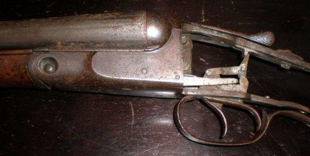

Hello,
The project has now started and I am posting a "before" picture for you - at least trying to post it.
As you can see this gun is very very rough but I am hopeful it can be brought back to life. I have no illusions that this will be a top end firearm but it is my hope that it will at least be presentable and more importantly usable.
I will post more pictures as we move forward. Thank you again everyone for your input as it has helped me get this project up and running.
Capt. O'Rourke
Capt. O'Rourke

Re: Philadelphia Arms Fox A grade advice needed
Well I commend you for taking on this project... I just had the stocks refinished on a PAC gun only 29 serials later than yours! I own 2 A grade PAC guns and really enjoy the history. I even got to handle a set of barrels for gun number 51 this weekend.... they were not in the best of shape (missing extractor, no blue) but interestingly, they appeared to have just a touch more engraving than the simple line on the barrel breech of an A grade! Hard to say what they were once part of since ht parts were never marked with the grade... at least not that I have seen. Here is one of my PAC guns after a little stock refinishing
