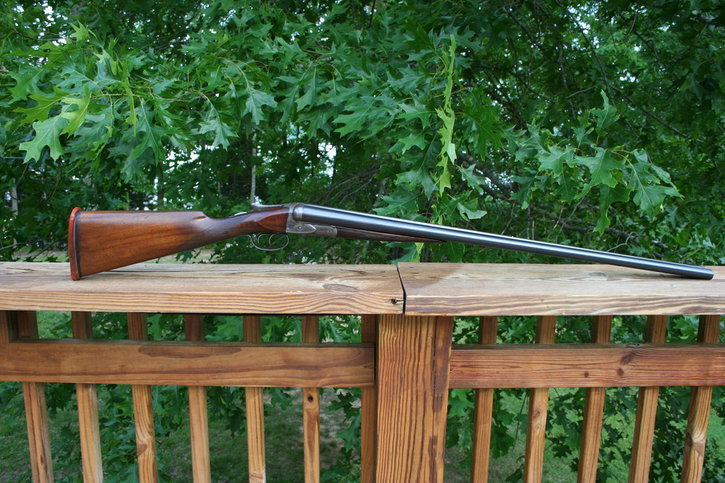

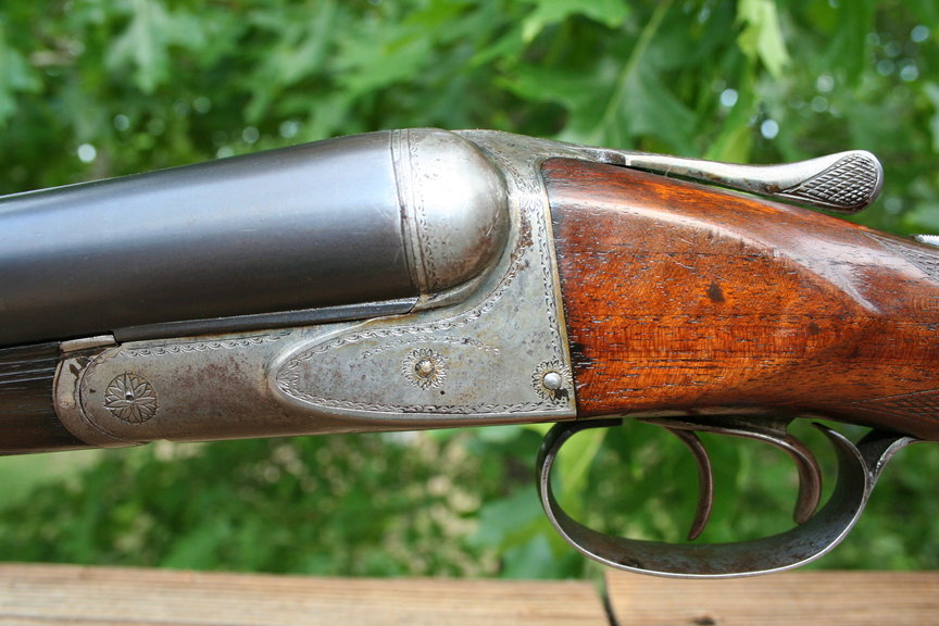

1913 SW Ejector
1923 AE Grade a wopping 8.2 lbs. (probably ordered for trap shooting)
1922 HE Superfox #27826

VERY NICE collection of guns. Thanks for sharing, your photographs are very nice. The HE is a very early example and as I recall the card said semi-pistol. If that straight stock isn't factory I'll eat it. Nice guns enjoyed but all have been taken care of. Craig
