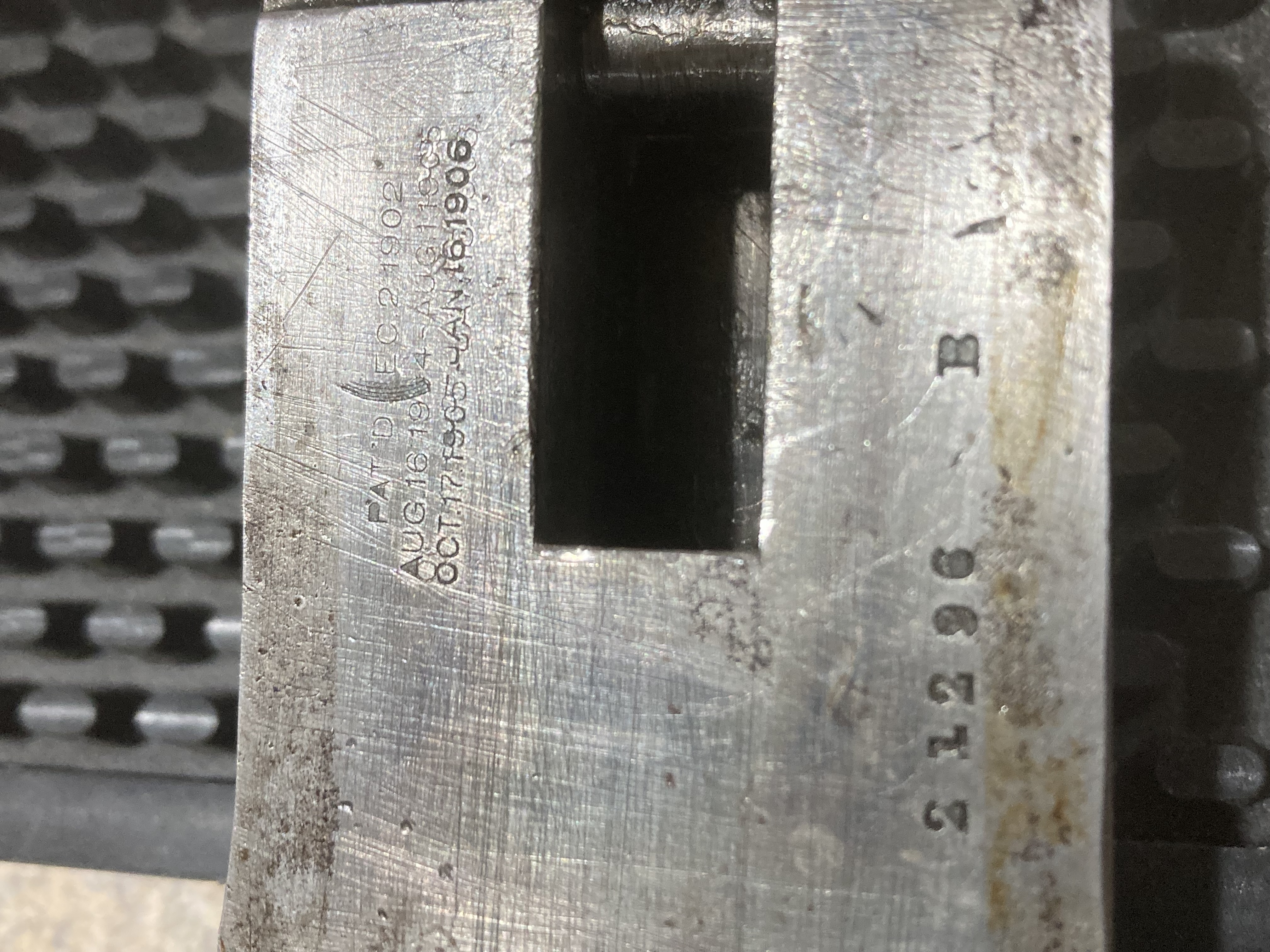

Mr. Spudth. You’ve come to the right place and many of us would like to help you identify these guns. Do you feel comfortable removing the barrels from the frame? If you do, you’ll be able to tell the grade of the gun. Notice in the attached picture there is a “B” after the serial number. Knowing the grade would be helpful.

Forgive my lack of knowledge on these guns. I believe I am looking at two different guns. A.H.Fox guns and sterlingworth. Right? If it doesn't say sterlingworth it isn't right? I'm going to try and have a look at them.
Posts: 3740
Has thanked: 2732 times
Been thanked: 1664 times
Re: New to sterlingworth
Spudth wrote: Fri Feb 28, 2025 3:00 pm Forgive my lack of knowledge on these guns. I believe I am looking at two different guns. A.H.Fox guns and sterlingworth. Right? If it doesn't say sterlingworth it isn't right? I'm going to try and have a look at them.
Just to reiterate what “Researcher” said, the Sterlingworth was made by A H Fox. It’s mechanically the same, it simply does not have the engraving. And, then there are several “levels” (grades) of engraving.
