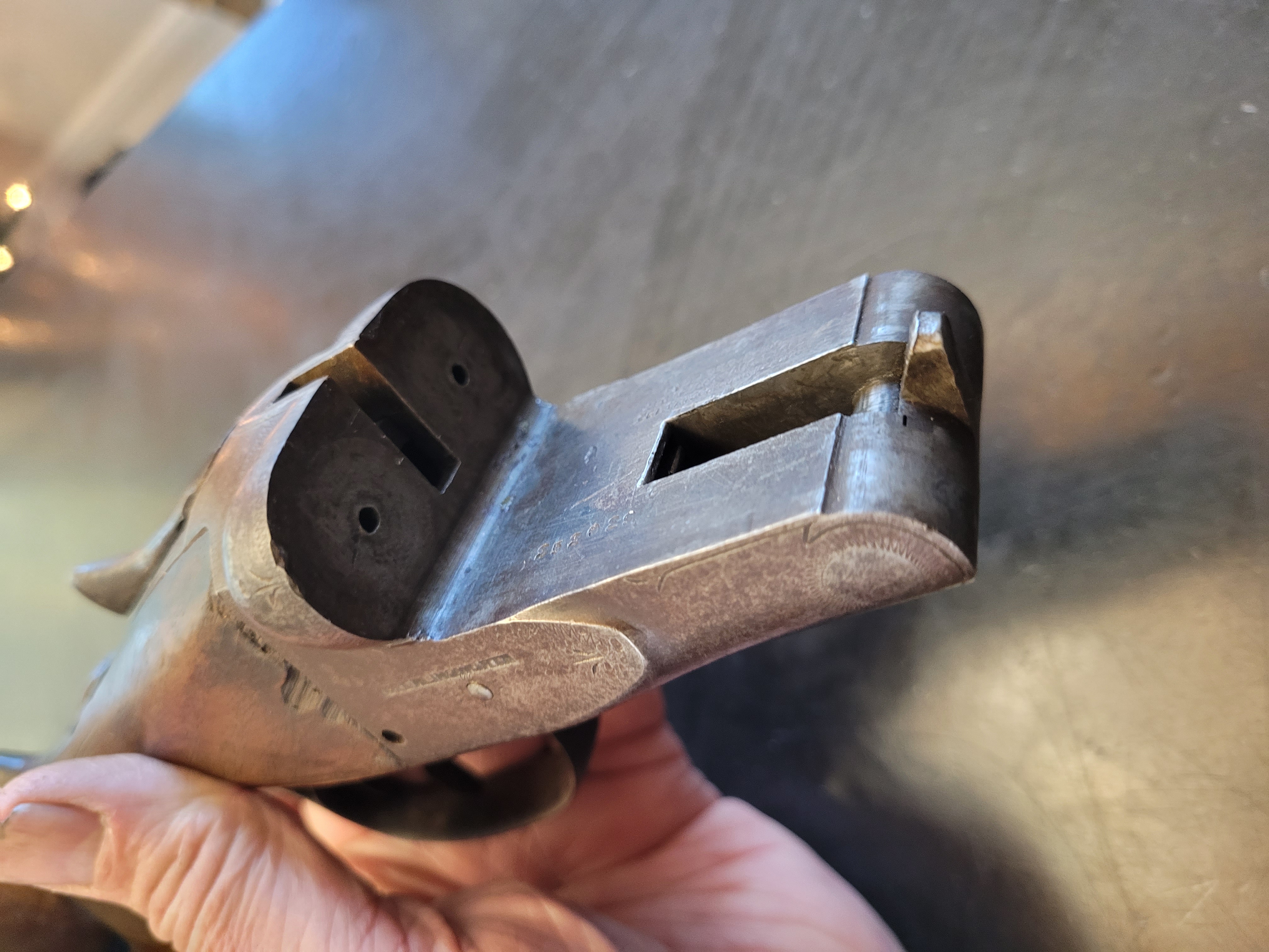

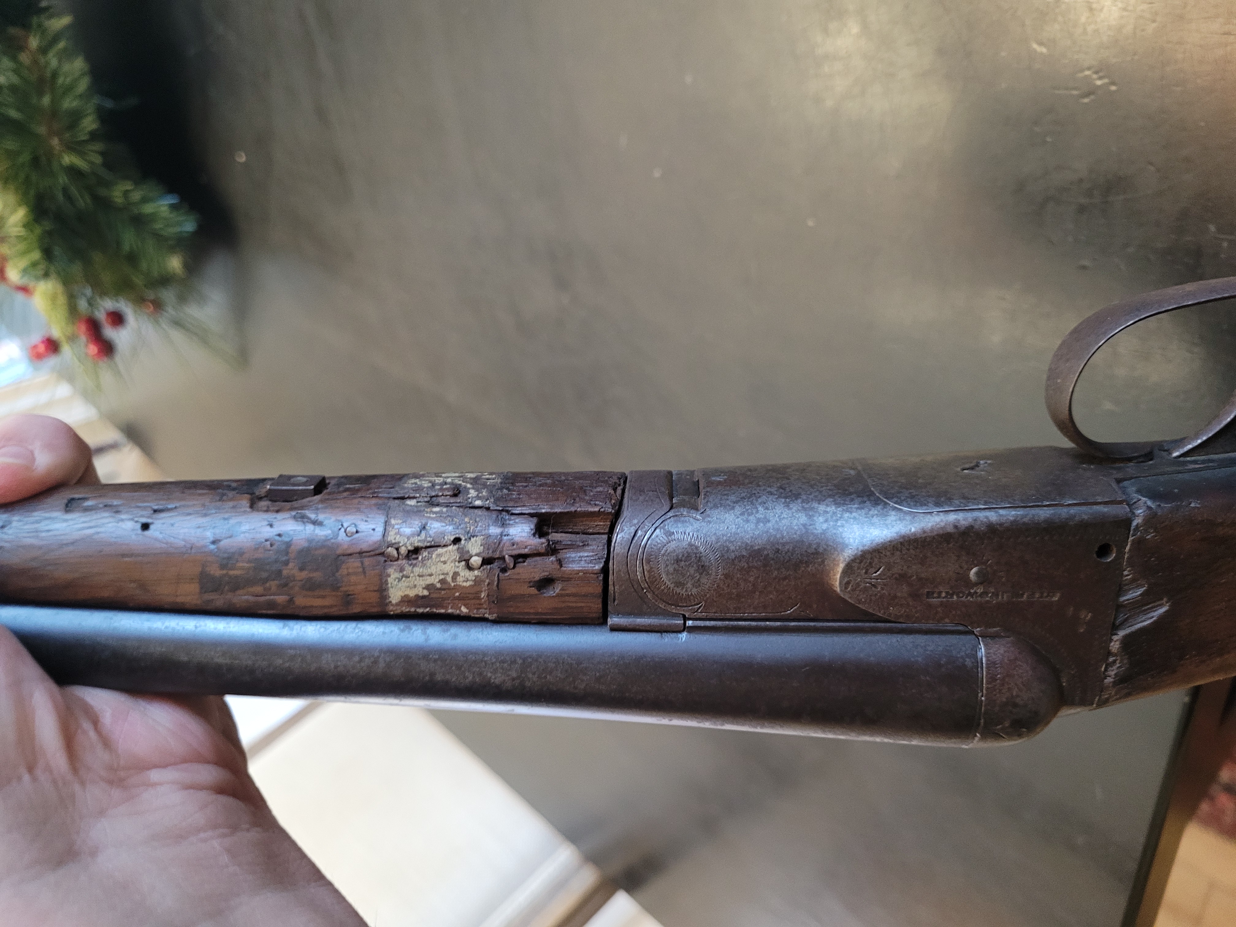

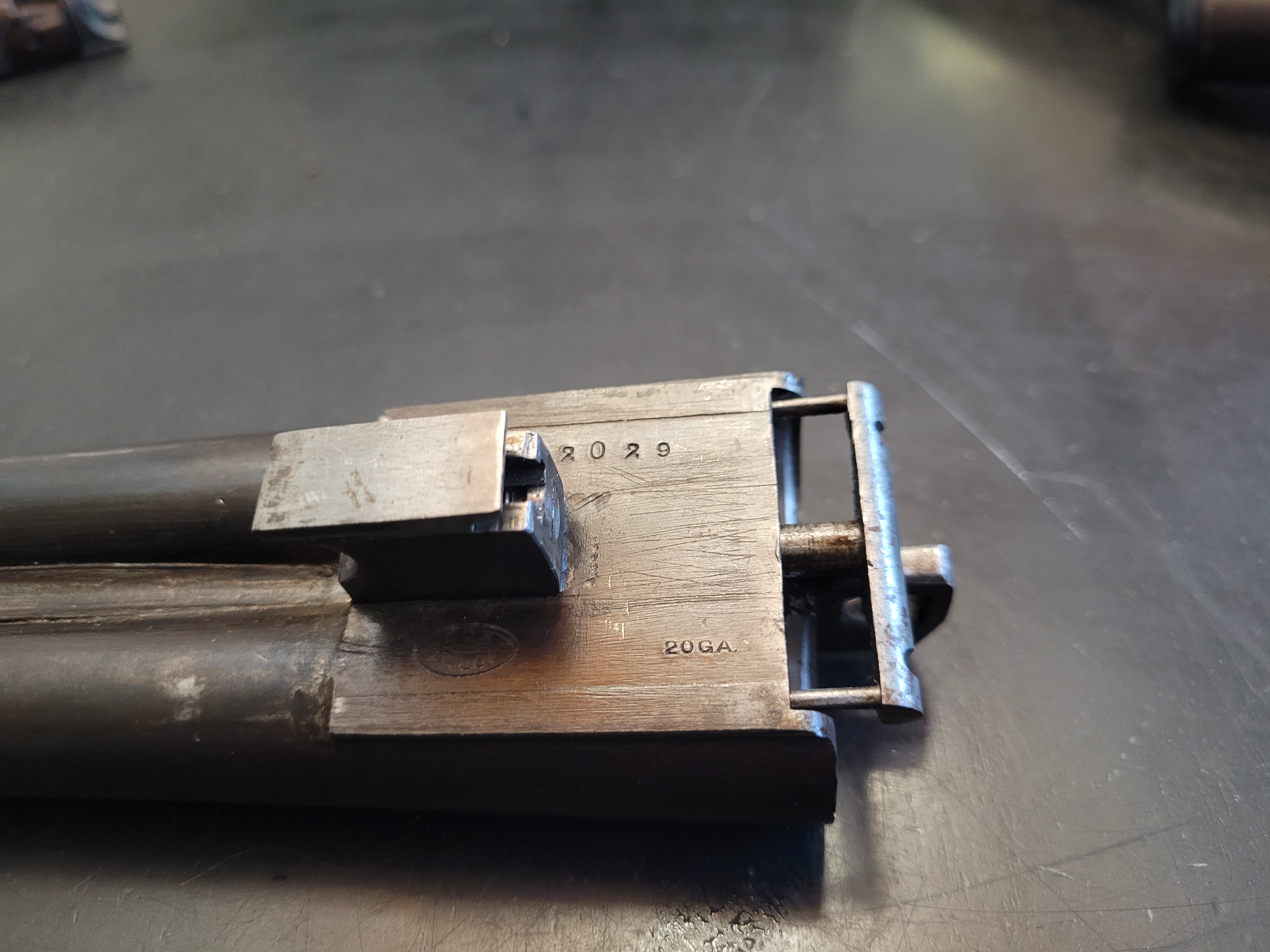

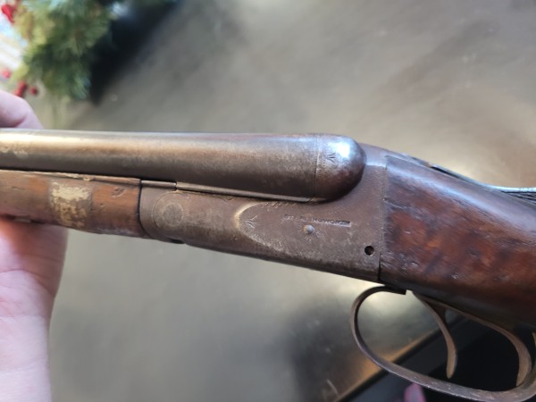

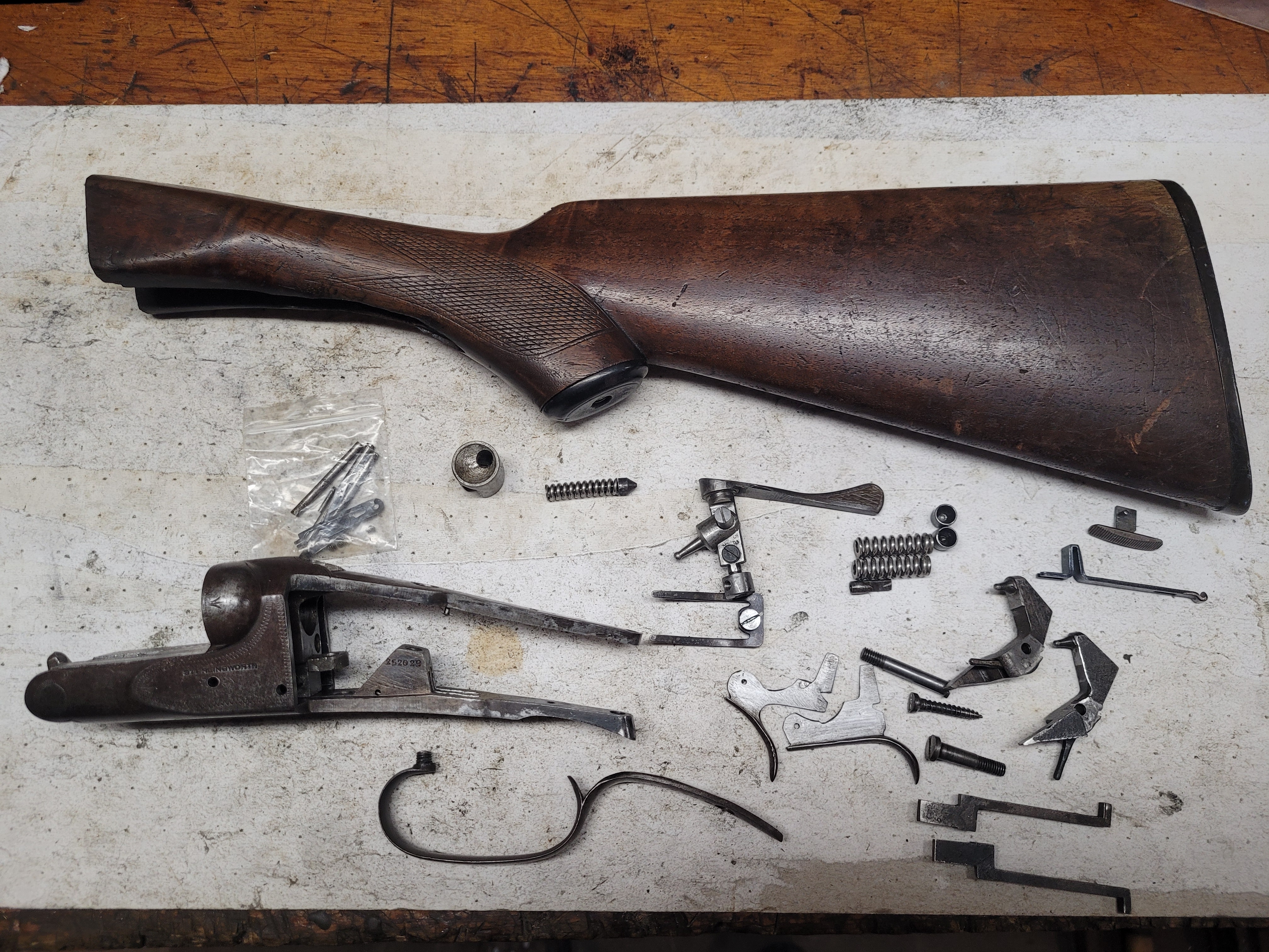

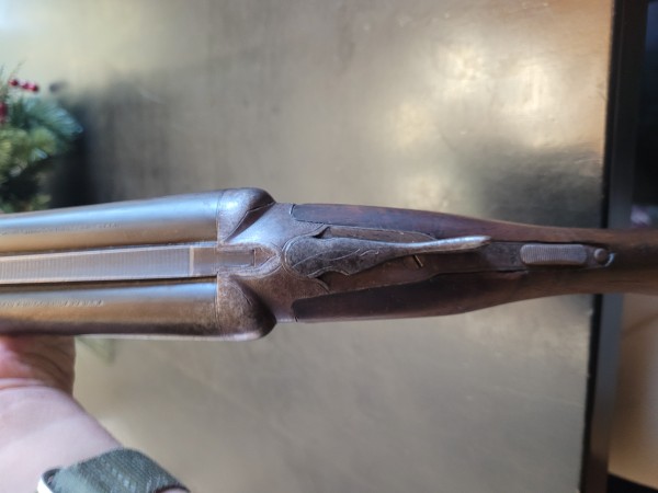

Some as obtained pics and one with action fully disassembled.

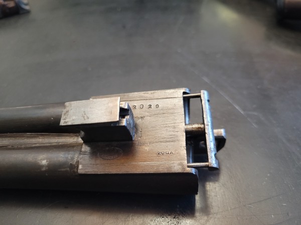

More pics

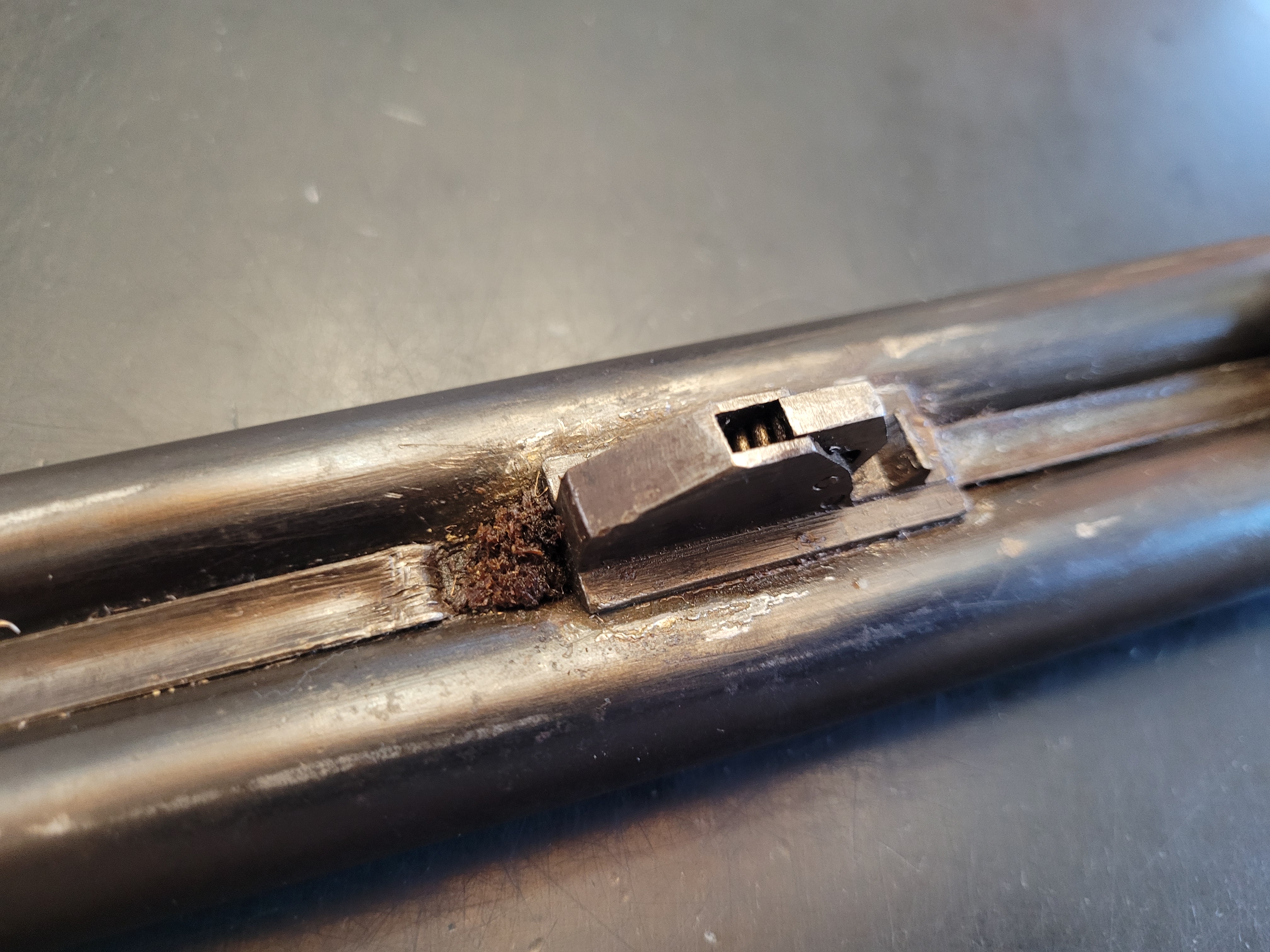

Last pics and yes that is an antique wood dowel used for loop reinforcement. :(

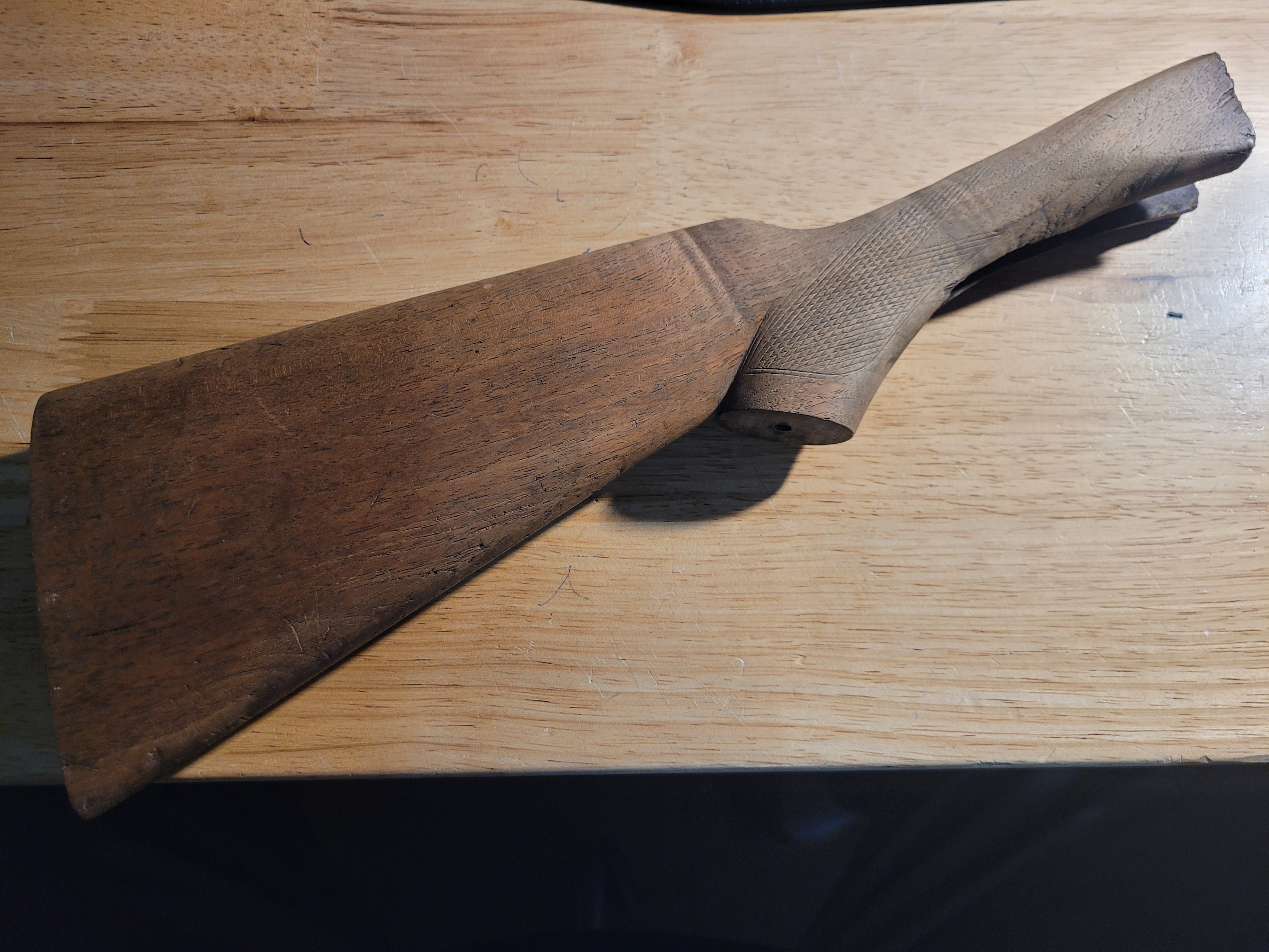

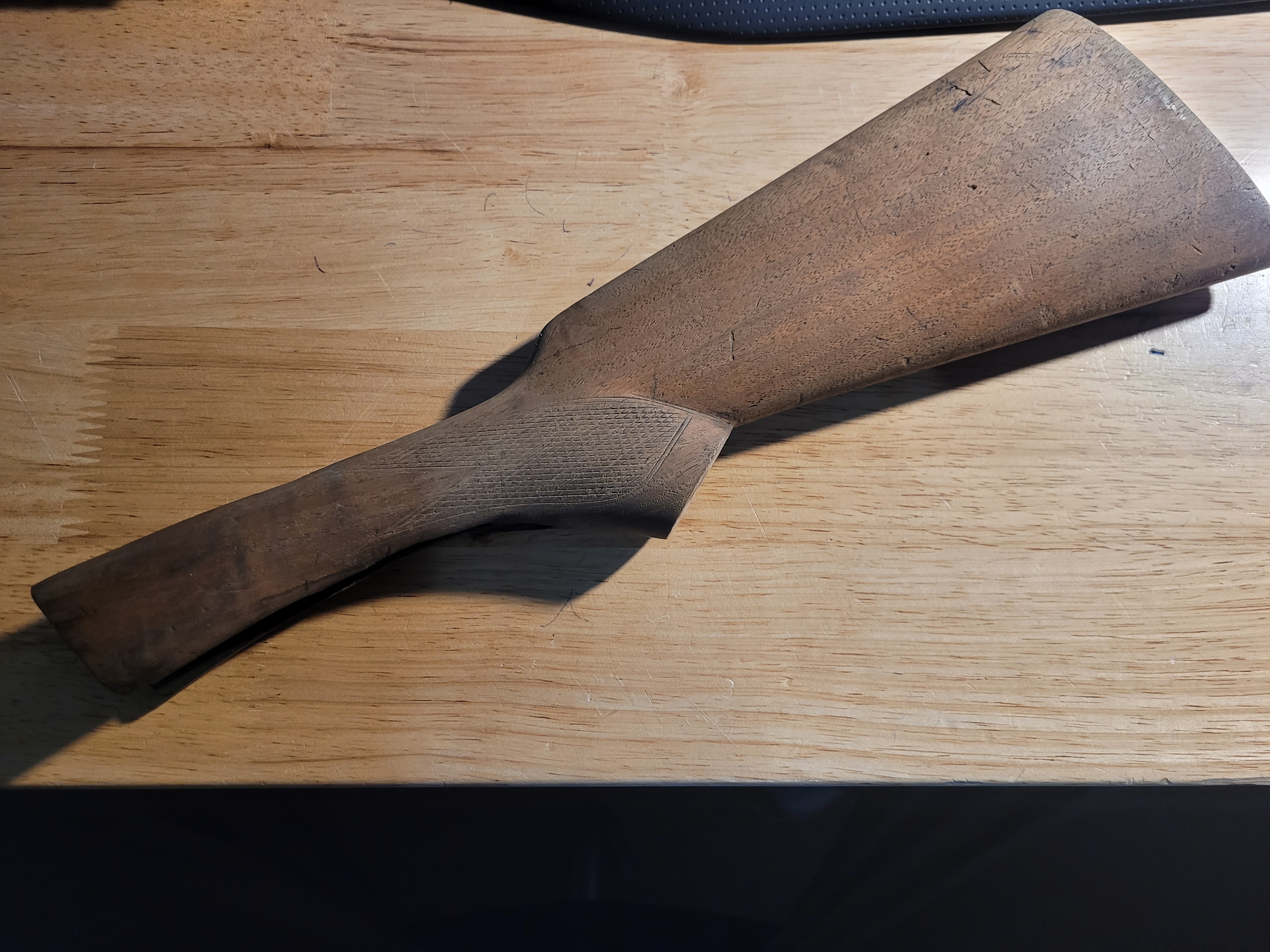

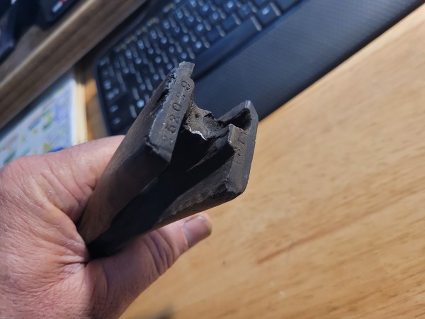

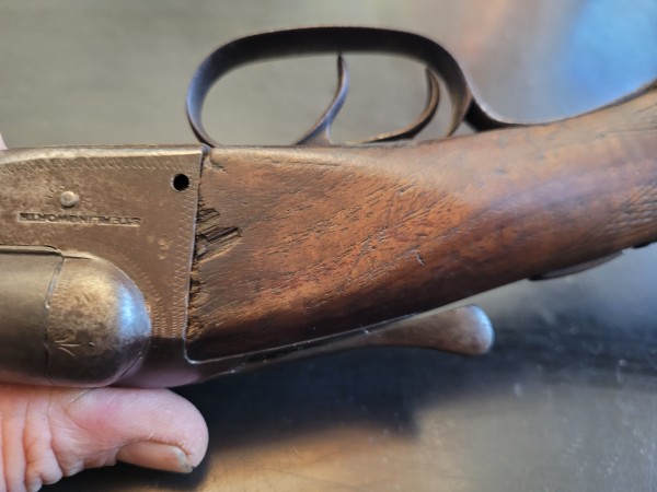

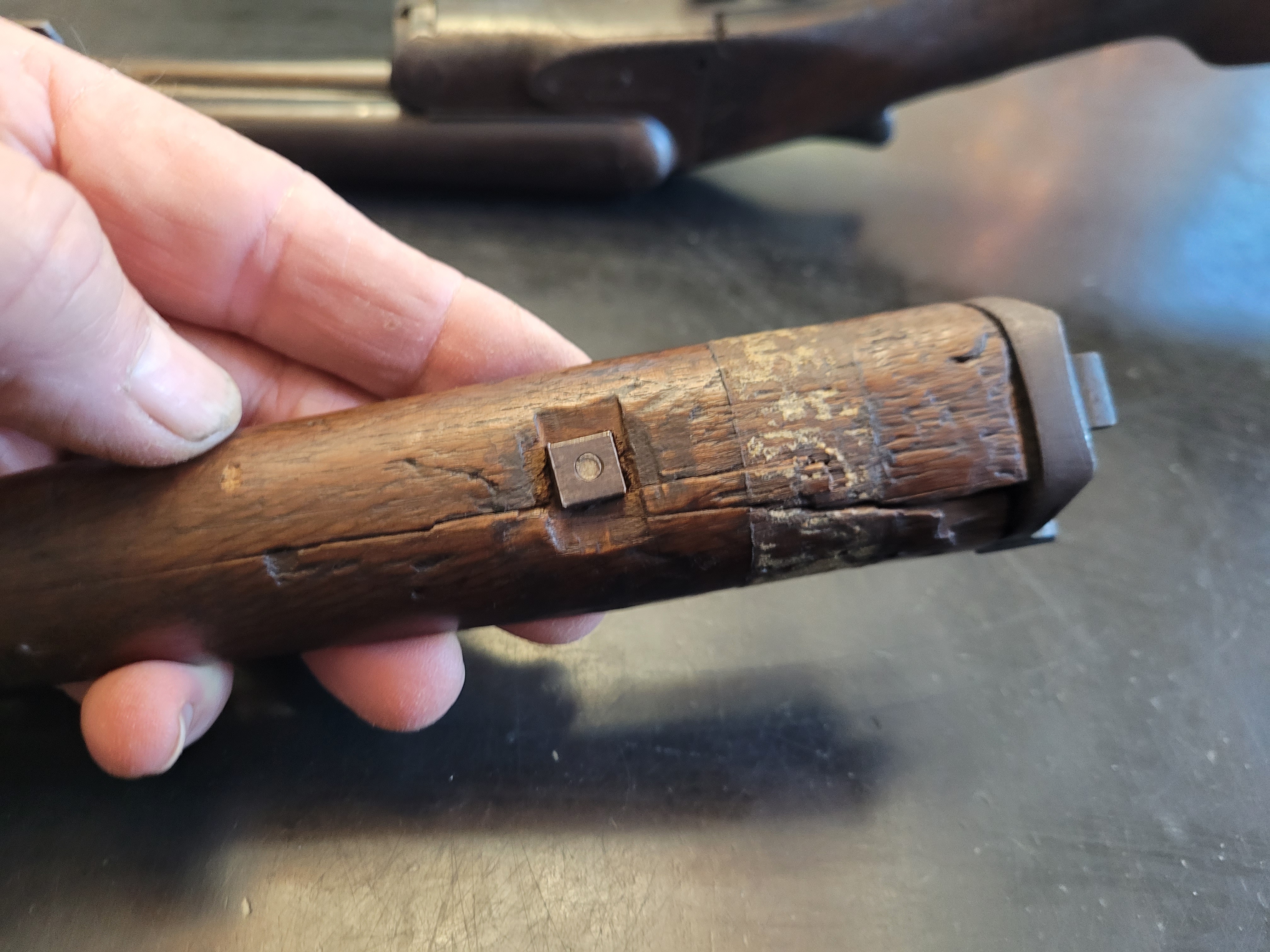

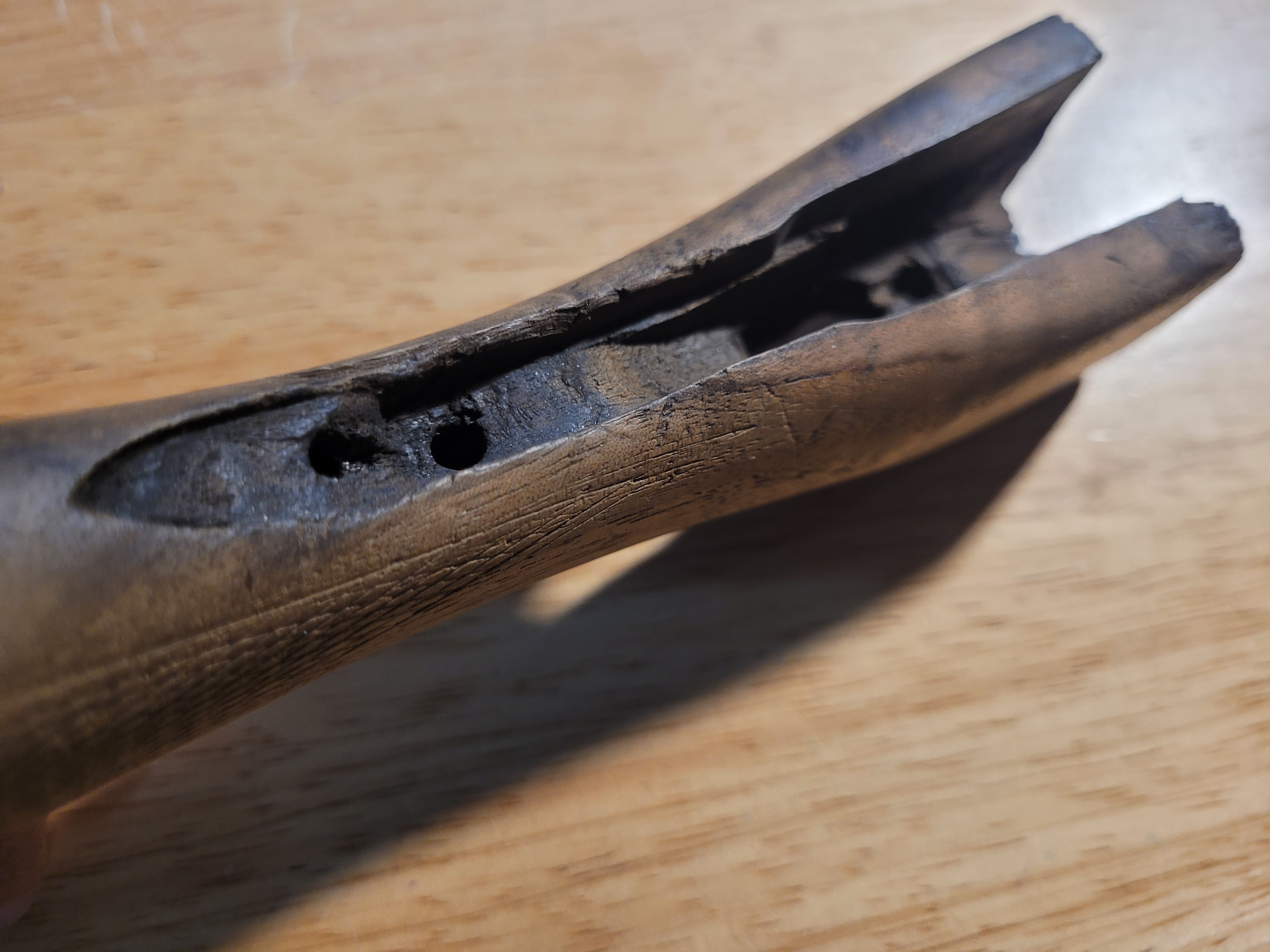

I probably will not get too deep into this until summer, but I was stripping another stock and figured I would also do the Sterly stock while I was in the mess. For an over 100 YO stock it is really not that bad. I have new wood in route but in time I may get this back to right. I do have one question - Is the corrugated plate in the head something someone did later or was this a factory feature? Thanks
Posts: 3606
Has thanked: 1043 times
Been thanked: 1477 times
Re: 20 Ga Fox Sterlingworth
The staple in the stock head is something seen quite frequently on small bore foxes. The one's I've seen were factory work.

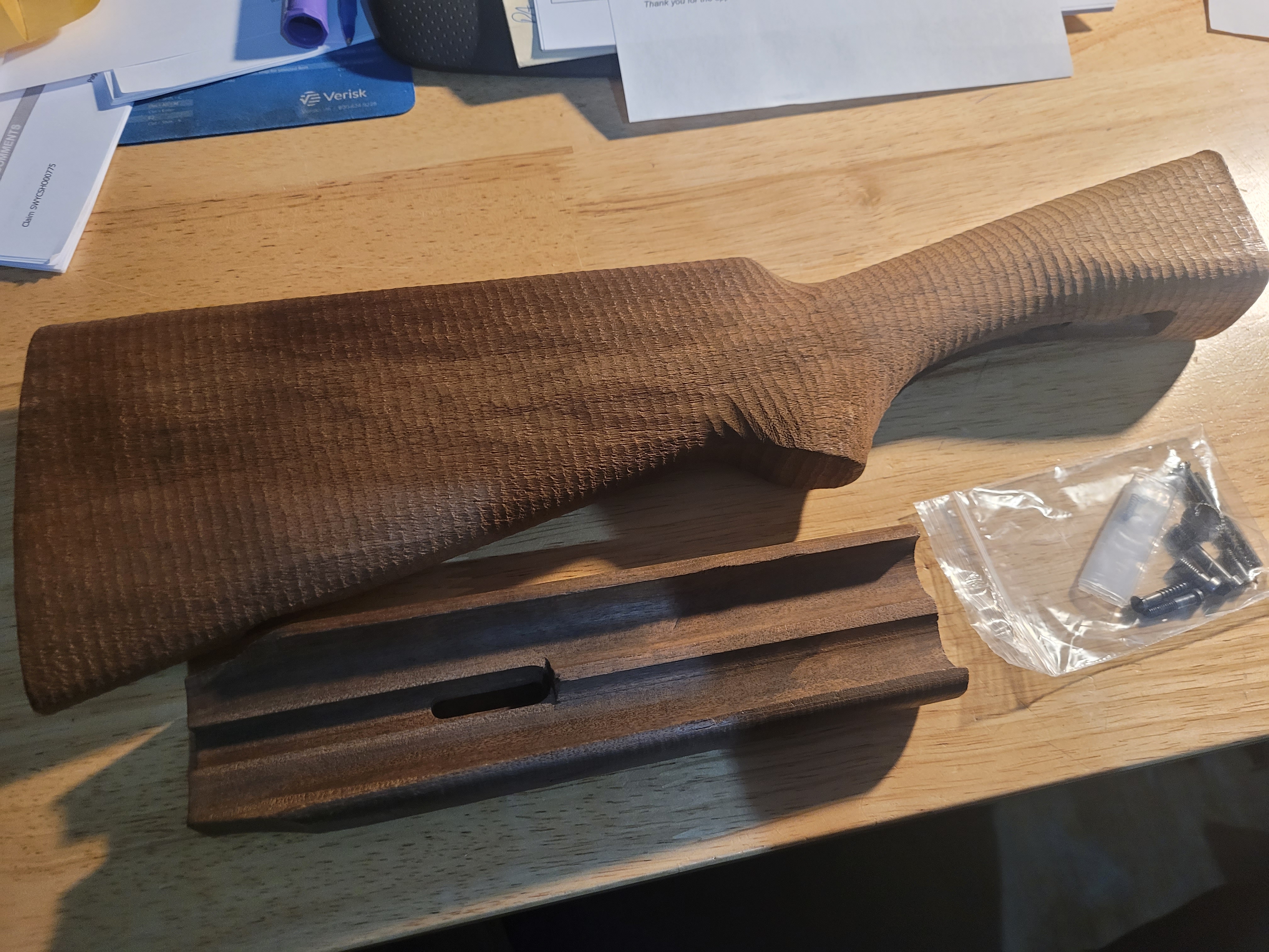

A big Shout-out to Jason at Fox Gun Parts. He supplied me the wood and all parts I needed to see this through. He was super easy to communicate and deal with.
The easy stuff is over - now starts the actual work.

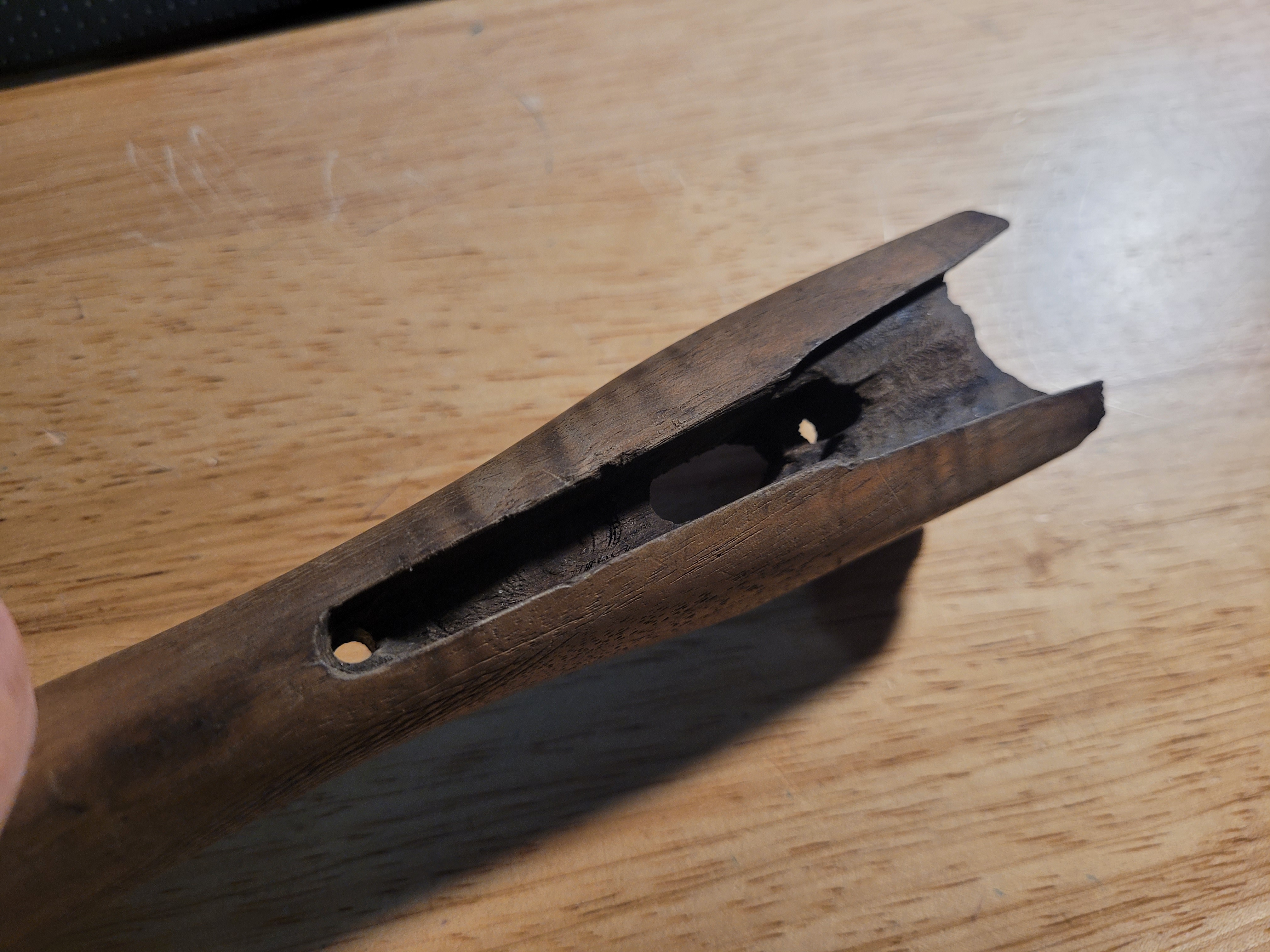

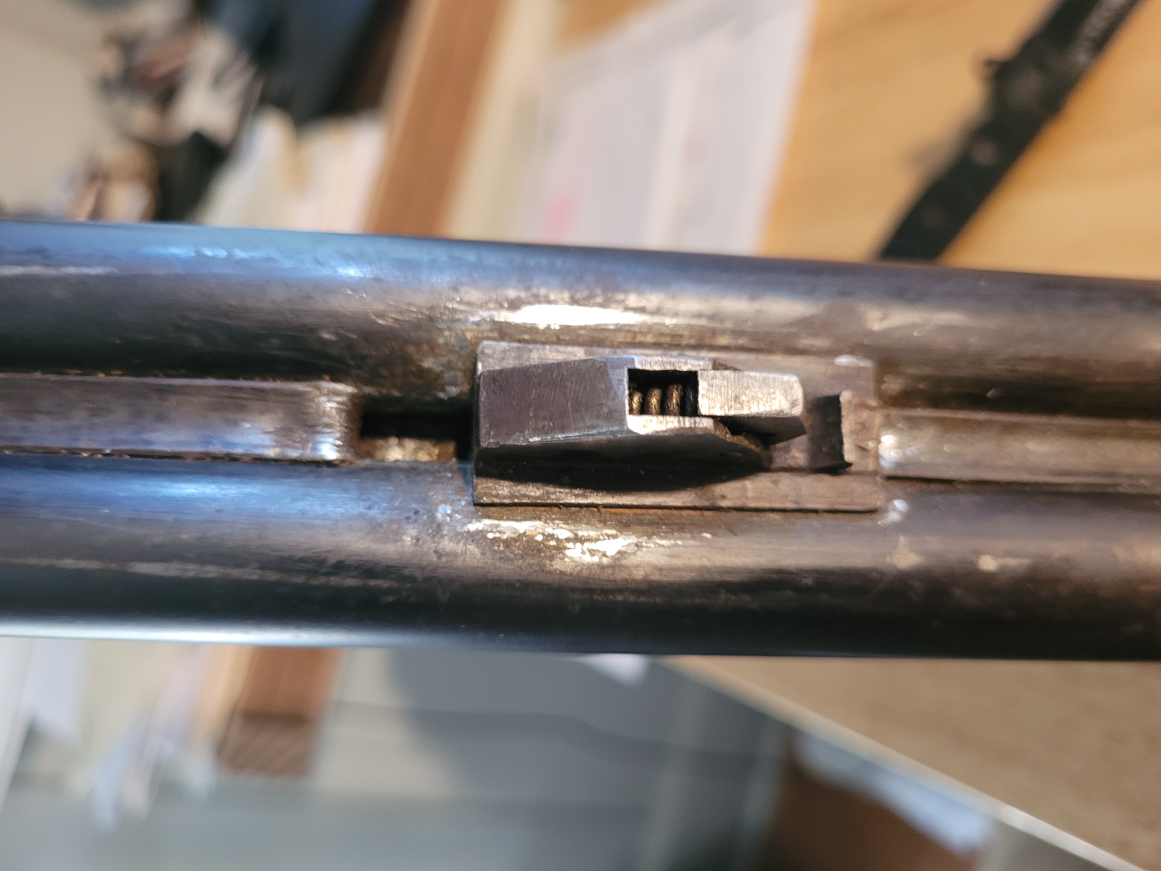

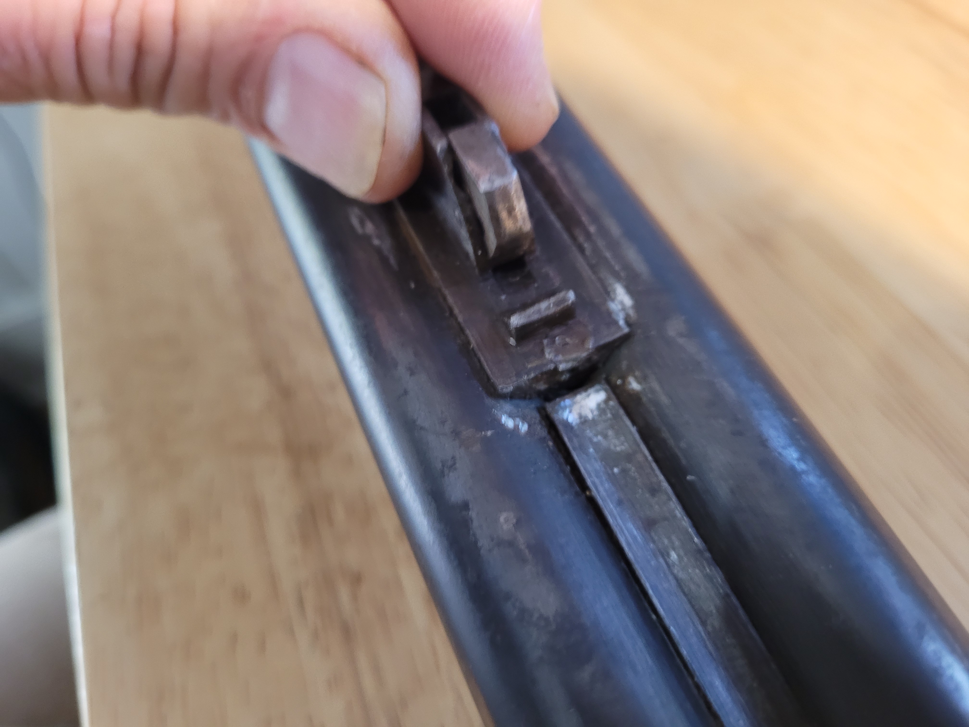

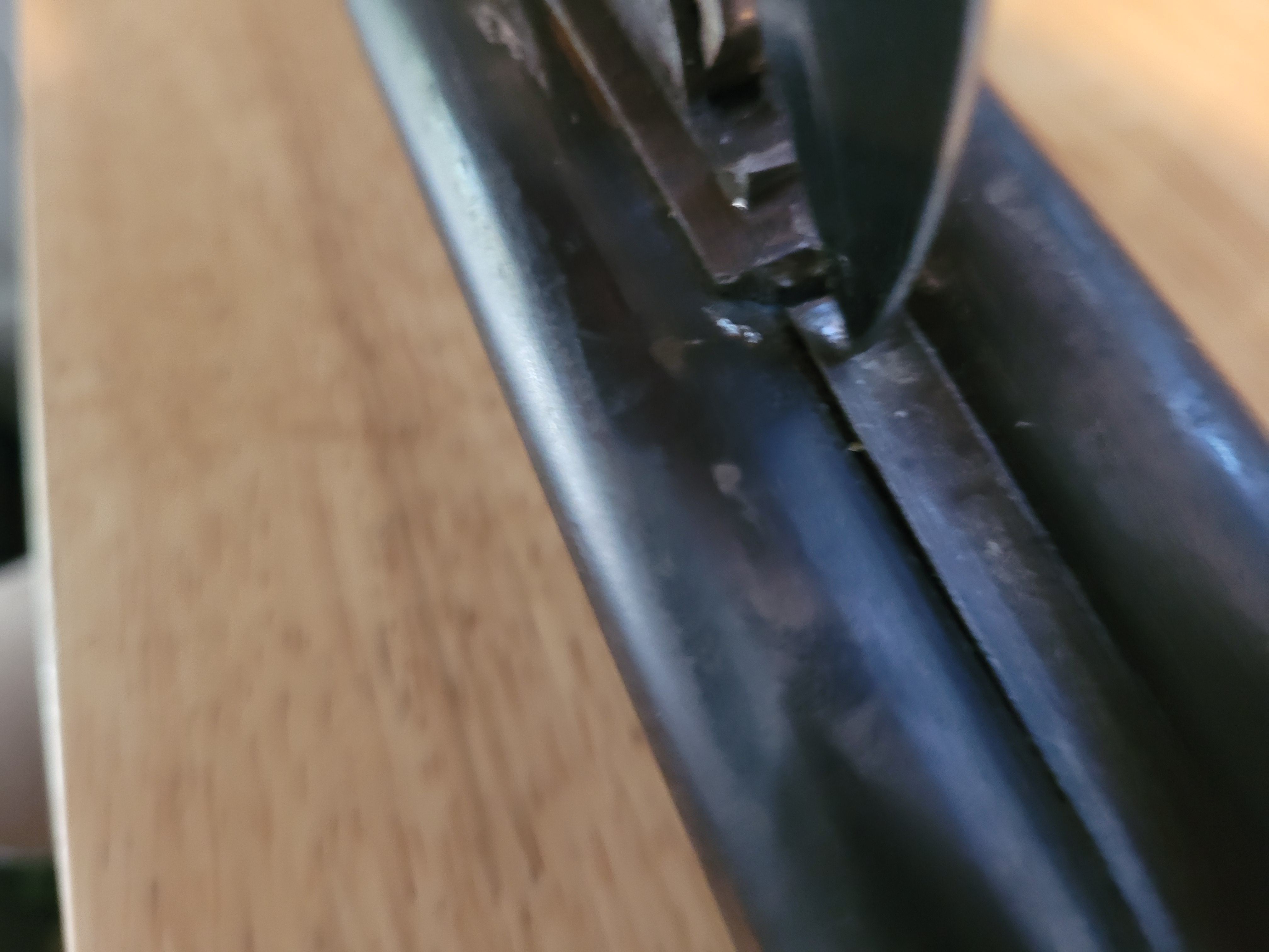

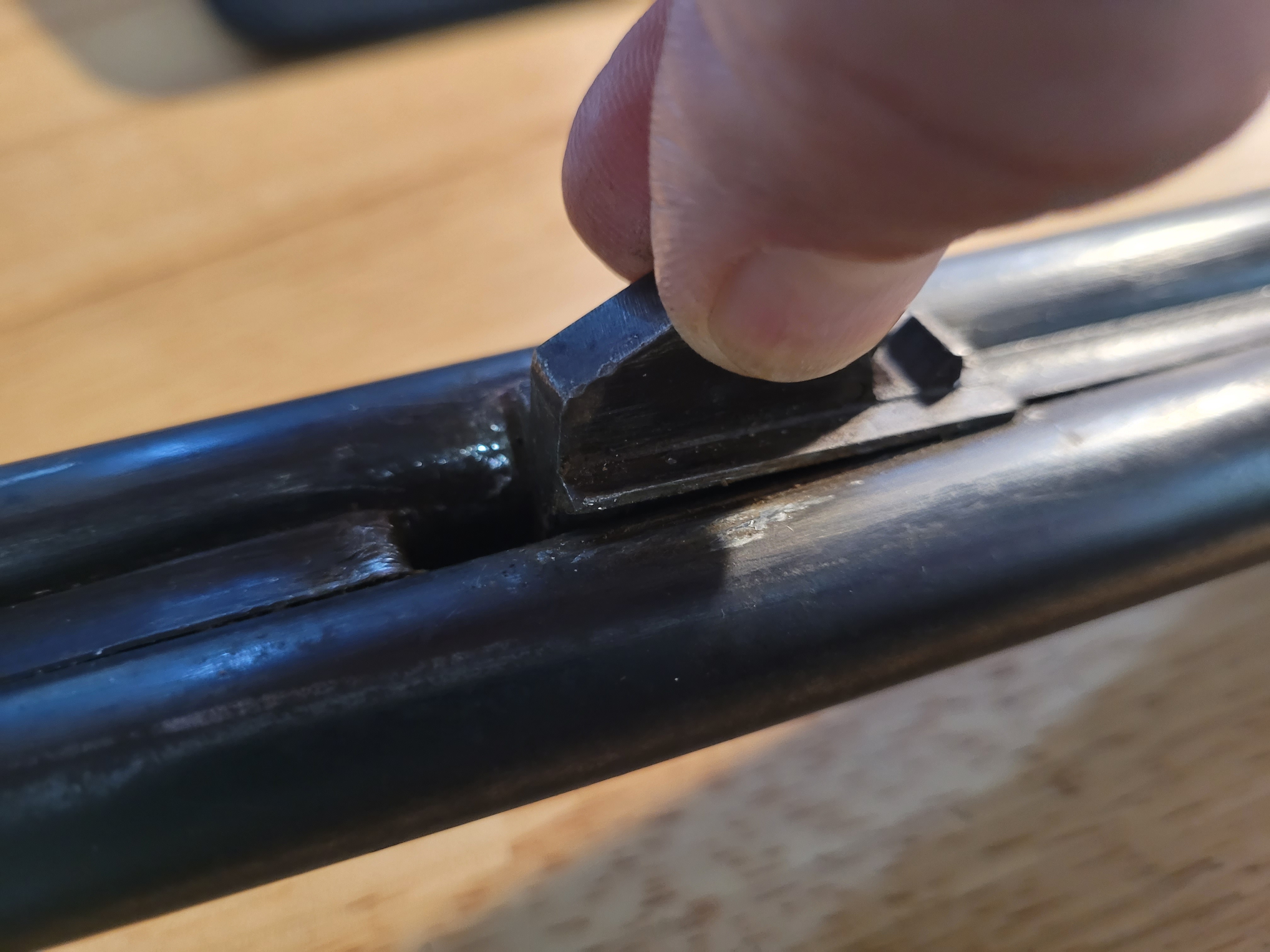

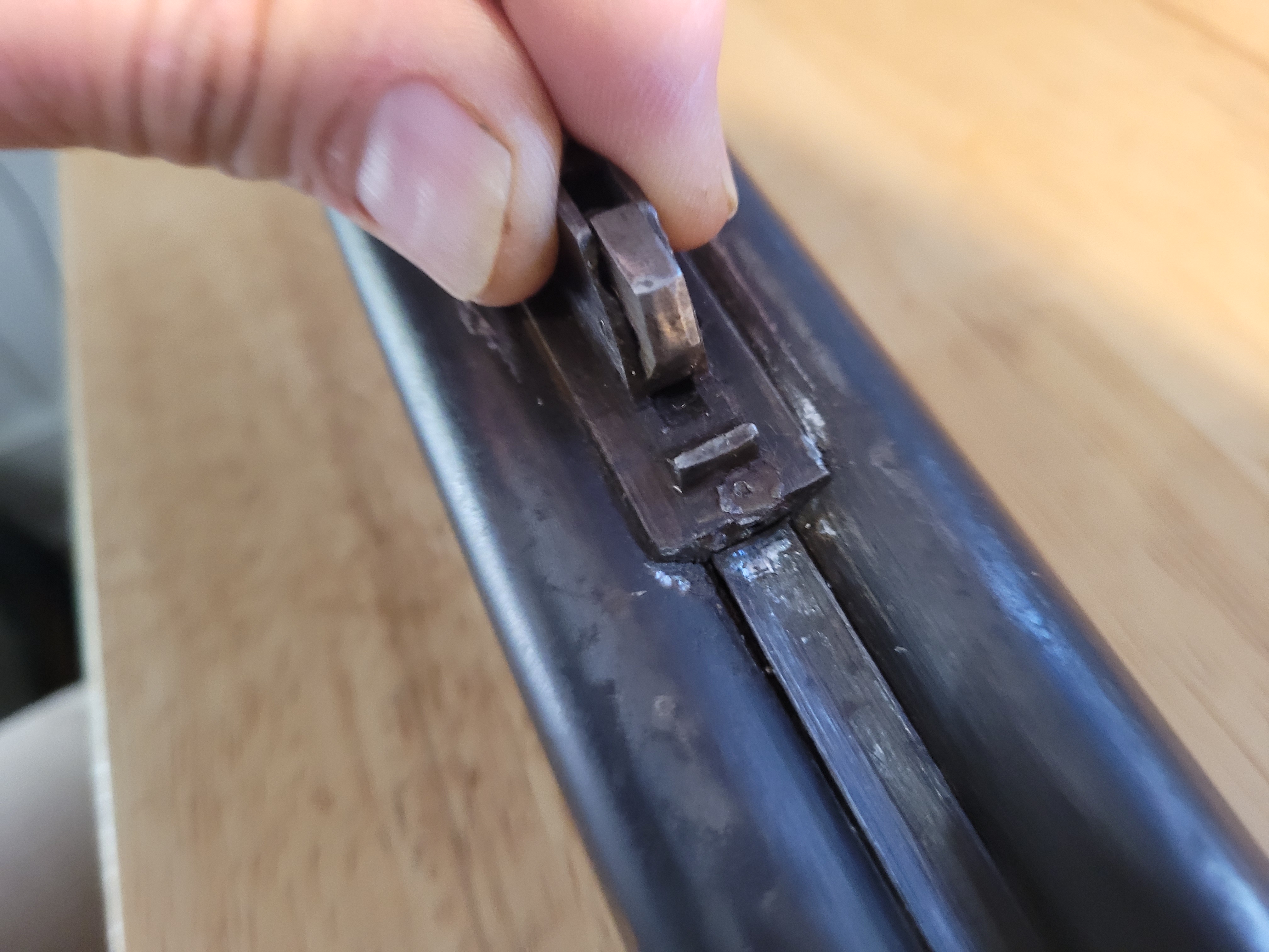

I had a little time today to fool around a bit so I dug into the wood dowel repair at the fore arm loop. It looks like the bottom rib was bent over into the channel between the barrels and then the wood janbed in there in was in there good but I got it out. There did not appear to be any significant rust at least what I could see. The forearm loop is super loose and the short rib is popped up at the loop end. All in all though nothing to make matters worse as far as I can tell.
I do have one question though. There is a fastener that goes from the top of the top rib down through the loop. Is this a pin, screw or not original?

Post by TRAVNTALL »
More pics
