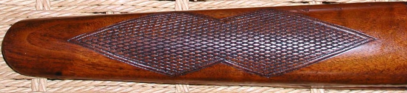

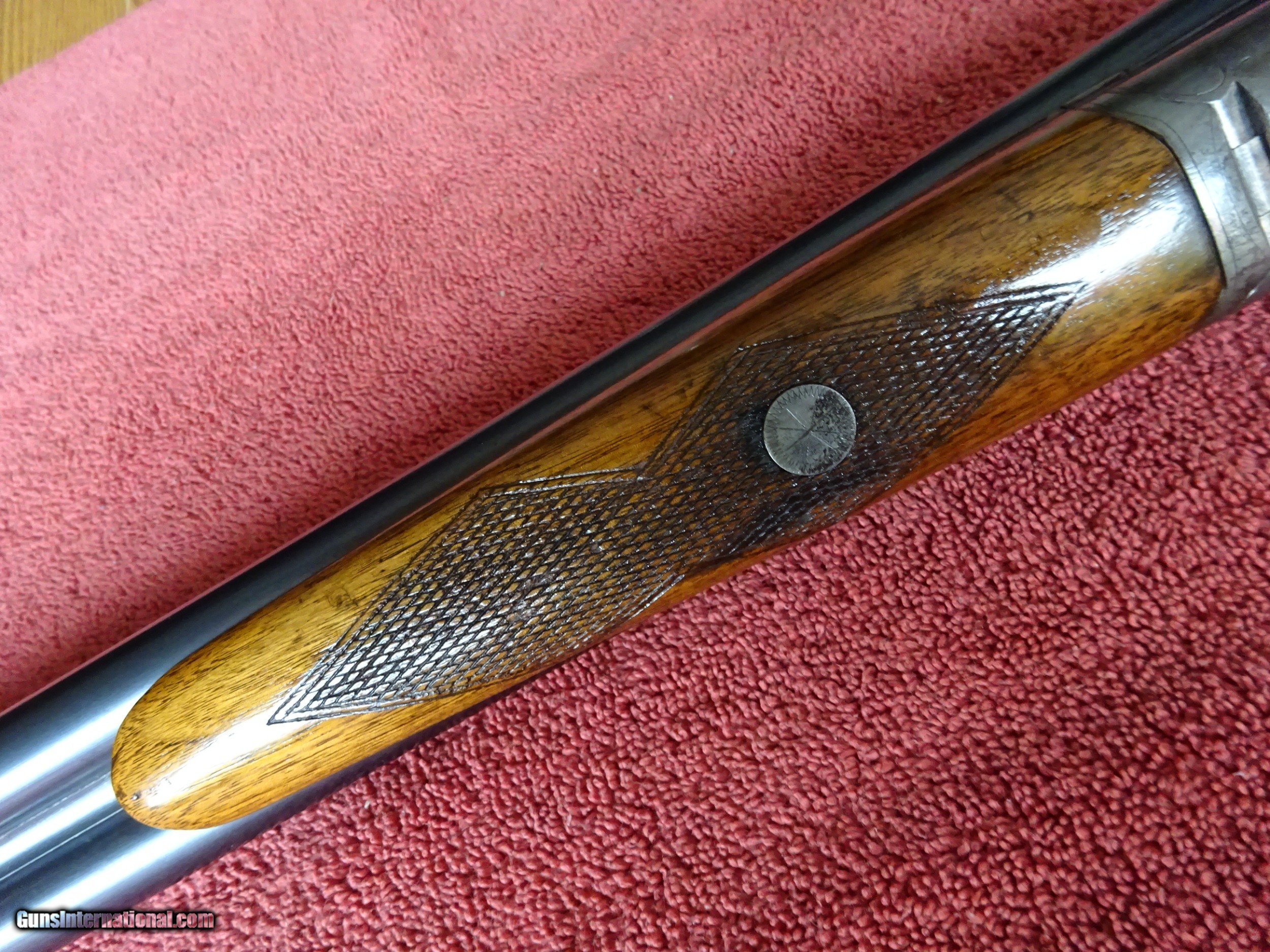

While the Sterlingworth listings in the A.H. Fox Gun Co. catalogs from 1911 to 1929 all list 30-inch (Standard) guns to be bored full & full, three of the six letters I have in my files on 30-inch guns show modified & full. I have never seen one that letters with reverse chokes.
The Sterlingworth was an entry level gun built to standard specifications with very limited options. Any forearm other than these --
would be very suspect.
