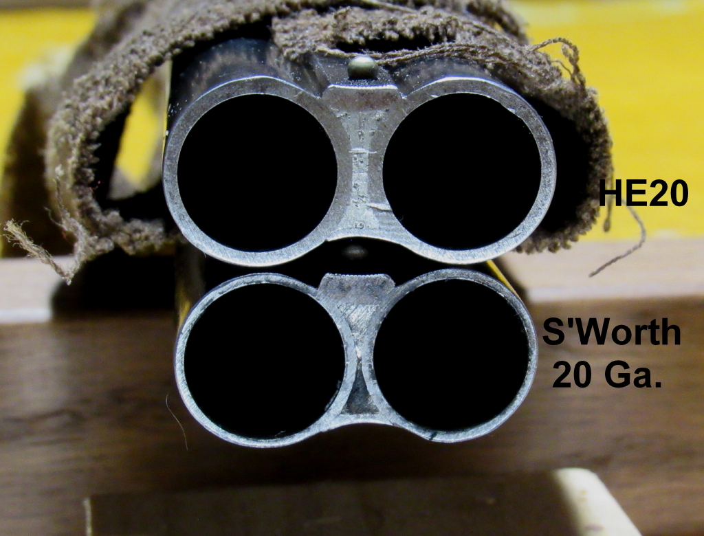

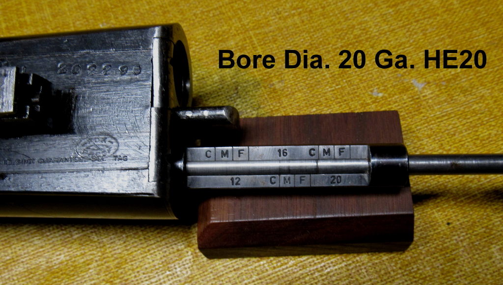

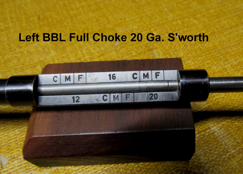

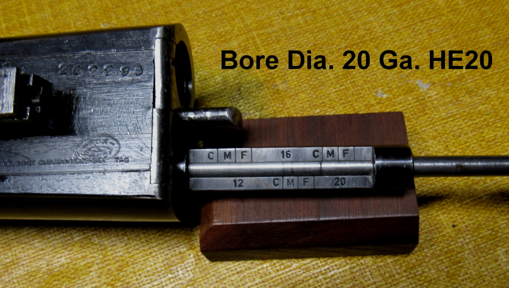

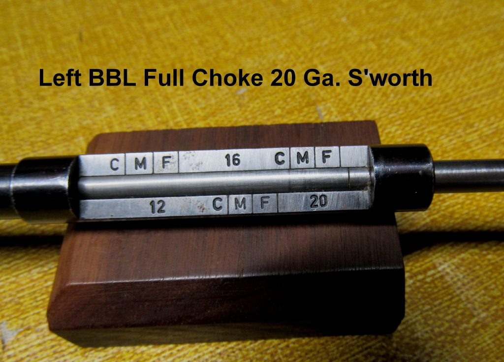

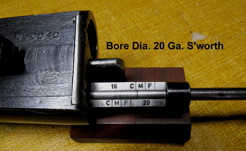

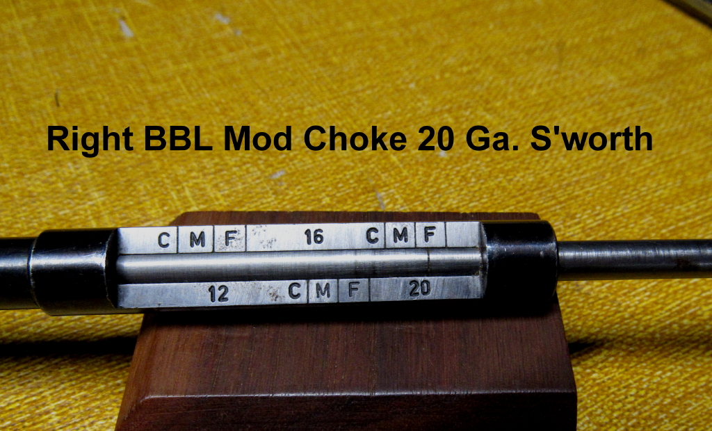

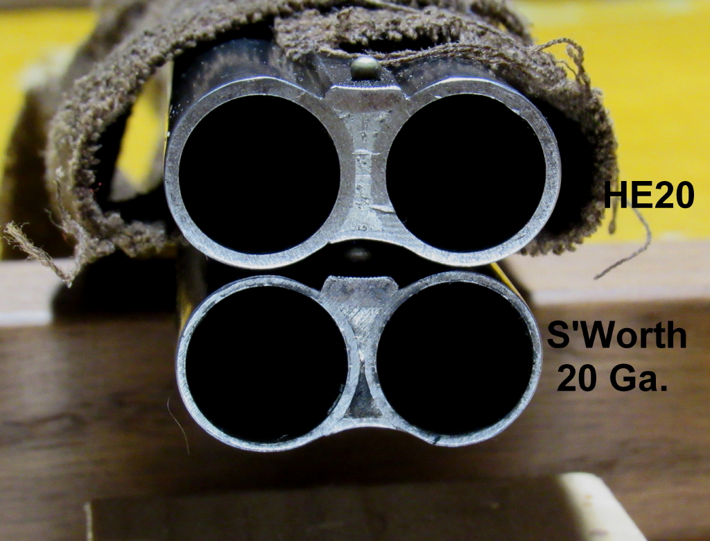

Got 'er dun!
Some info and pictures of my 20 gauge Sterlingworth (thanks Daryl) SN 262292 with 28" BBL's choked Full in left BBL and Mod in the right BBL. And my HE20 SN 202290 with 32" Full and Full.
S'worth 20 Mod = 0.595" and Full = 0.585" and HE20 both BBL's about 0.575".
I used a set of dial calipers. It's all I got so those numbers are probably not exact. Probably on the high side.
The pictures show me using a Frank Mittermeir choke and chamber gauge. Just have to check the Index mark on the gauge where it is located and compare with the two guns. The Mittermeir will just barely go into the S'worth Full choke and will not go into the HE20 Full choke.
I do not have any instruments to measure the bore. Just the Mittermeir.
So, some pictures for any benefit they might provide.
