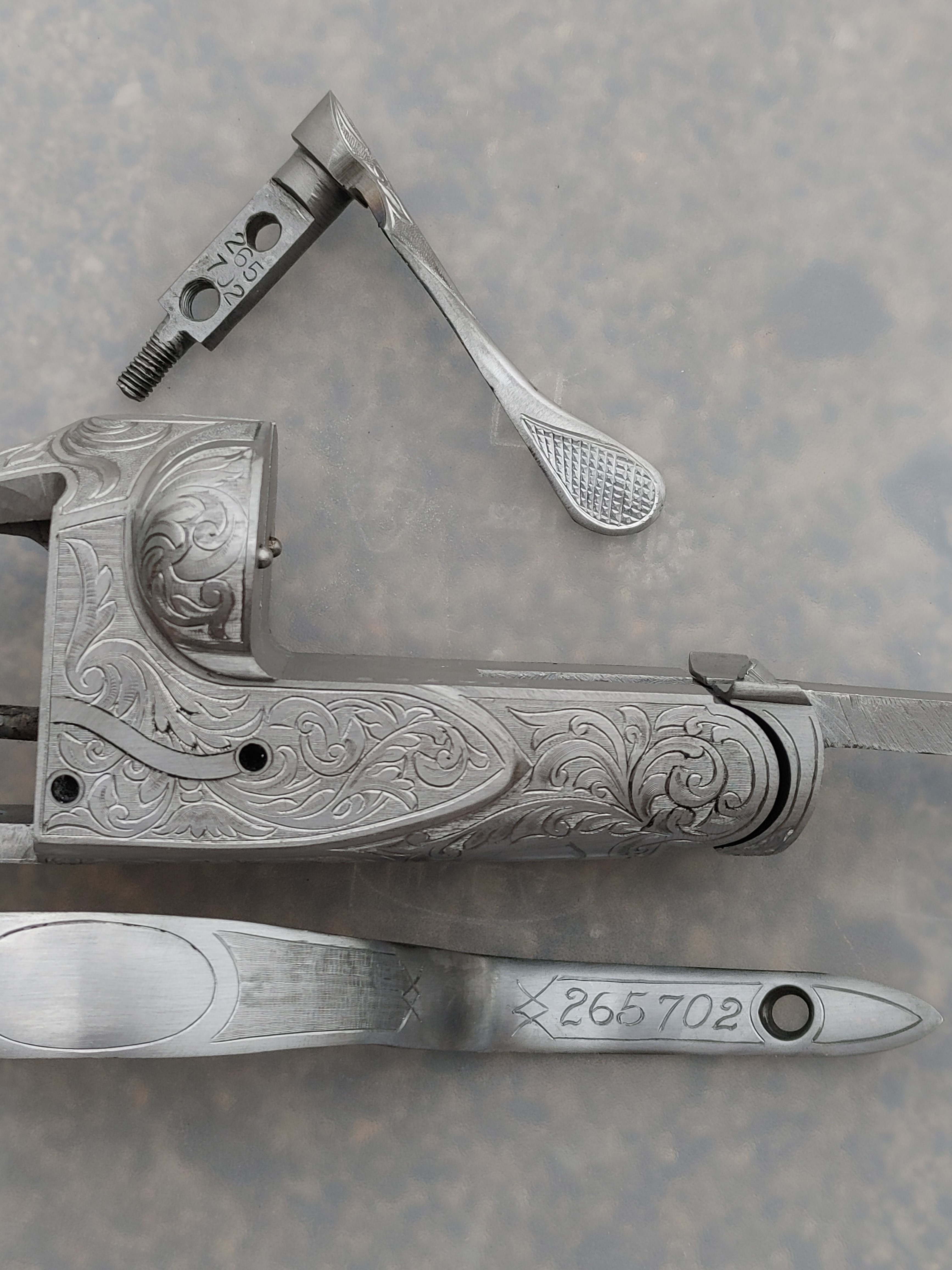

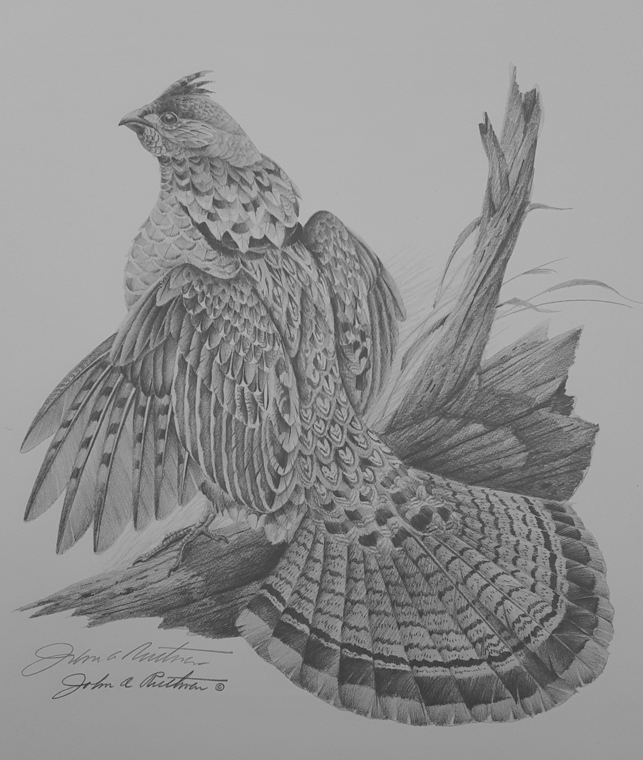

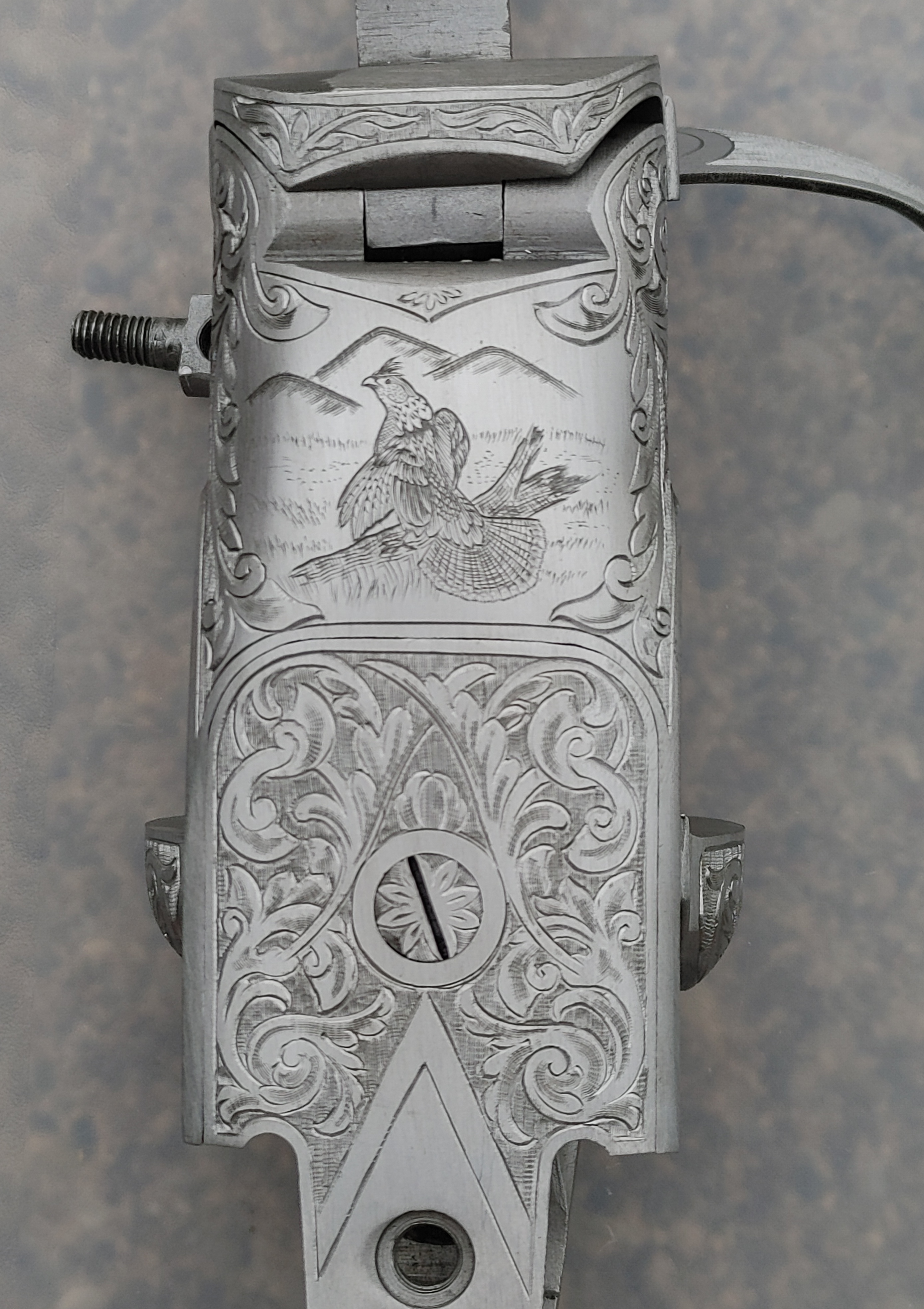

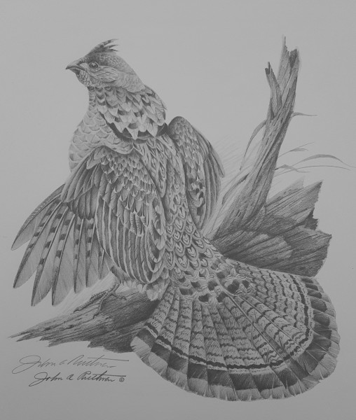

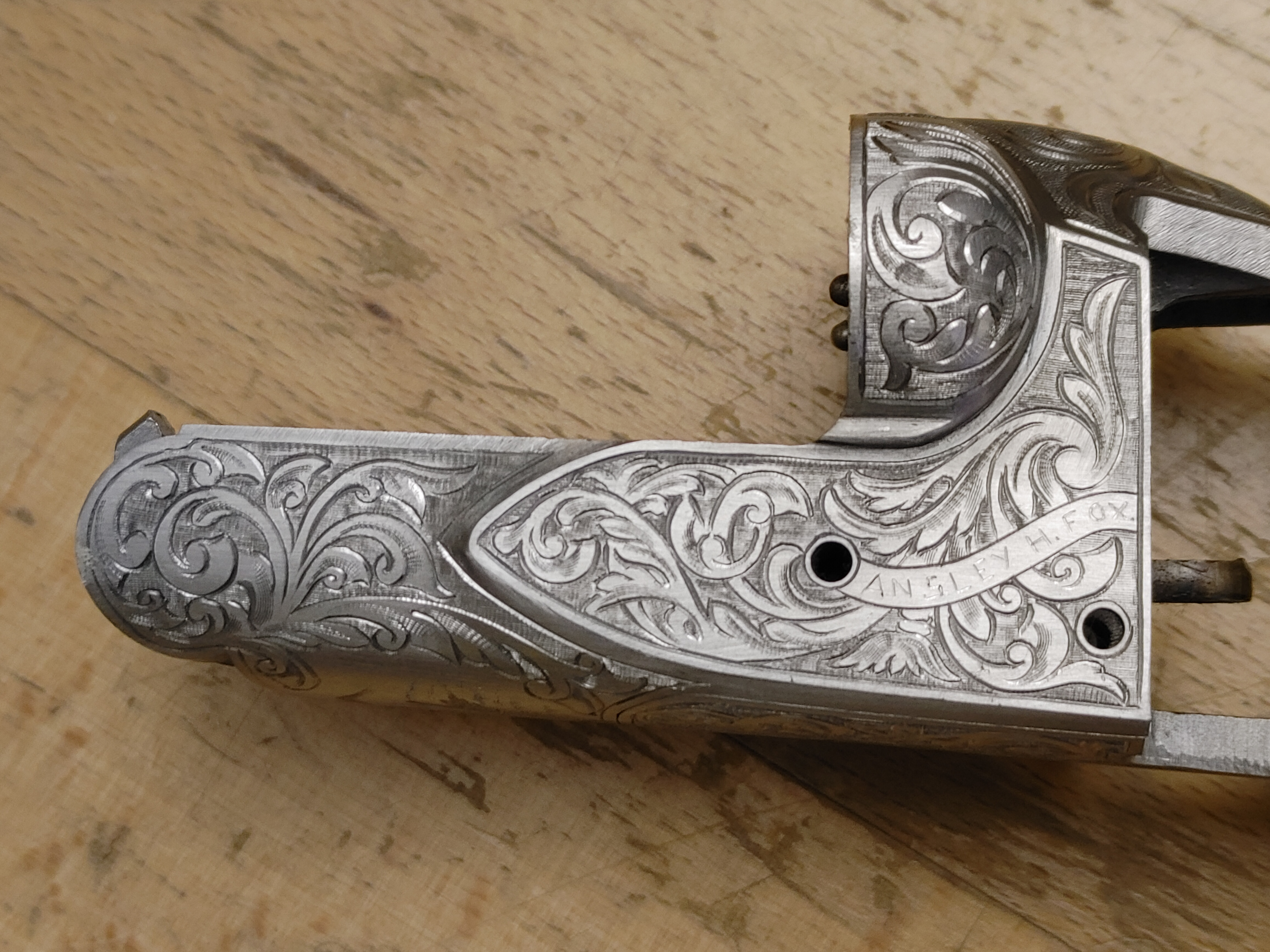

Moving forward, I reached out to Mr. Gournet at the NE SXS this year and we talked about the project. I also told him since it was an upgrade I wanted a Grouse on the bottom of the receiver and not a flying Grouse but rather a drumming Grouse. He asked me if I had a picture and I provided him some prints that were provided at a Grouse banquet in Ohio in the 1990's as I recall that I had purchased. They had been signed by the artist who was at the show. Attached is that pic that I provided to Gournet and also the almost finished engraved receiver pic that he provided to me over the weekend. I think when all is said and done, it will be a nice gun to chase Michigan Grouse and Woodcock with as we no longer have Grouse in Virginia.

Wow! That’s beautiful! I’m looking forward to seeing the finished gun.

Re: Progress on a Grouse Gun 20
No confusion on having this pass as an original graded gun since even appentice Foxers (should) know the 20g Sterly serial numbers are in a different number range than 20g Graded Foxes. I like that drumming grouse and of course Geoffrey's engraving is always superb. Tom, I do hope the engraving before stocking works out for you; not sure how the stocker will get the wood and metal surfaces flush with each other without compromising the engraving particularly at the top and bottom tangs. I say that because the few vintage double guns I had restocked by high quality stockers came back with the wood really proud of the metal ..... the stocker didn't want to damage the case colors. frank

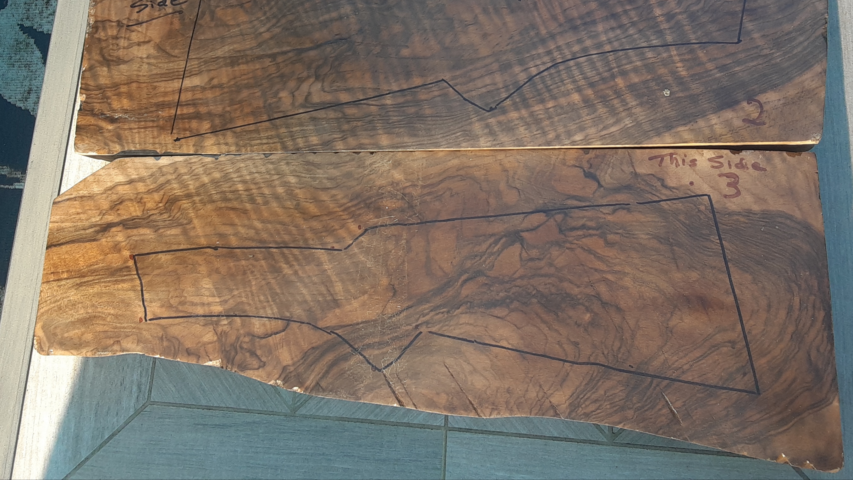

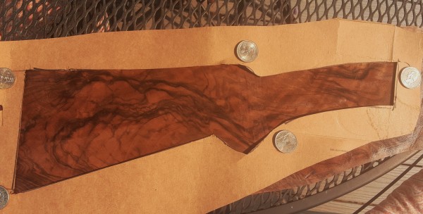

The blank on the bottom is what is being used. IMO pretty period correct. It matches quite well on both sides and is laid out correctly per the stockmaker. PS. both sides shown.
Done. Gournet has completed his part and is sending it back to the stockmaker. Here tis the finished frame.
