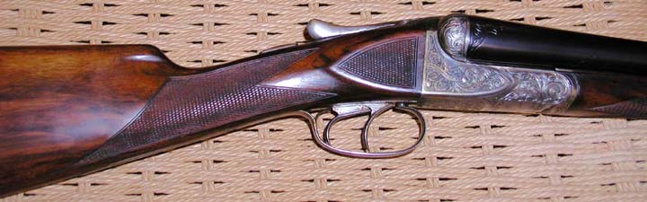

Don't suppose your gun would be 21349? The production card for my B-Grade 12-gauge, says "See 21349 for all dimensions."

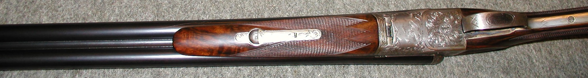

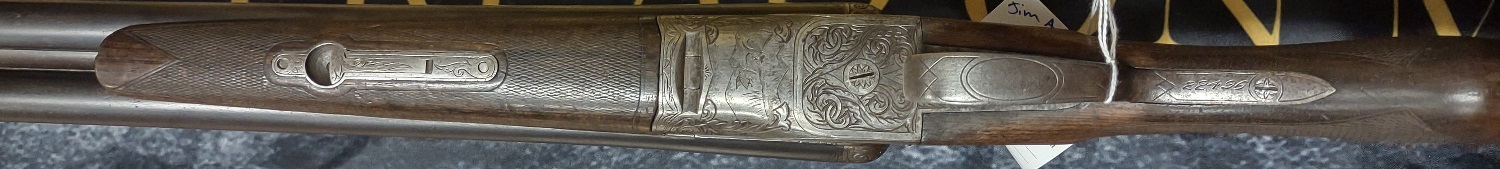

We have discussed the variety of checkering patterns found on B-/BE-Grades in the past. That 22496 has yet a different checkering pattern on the forearm --

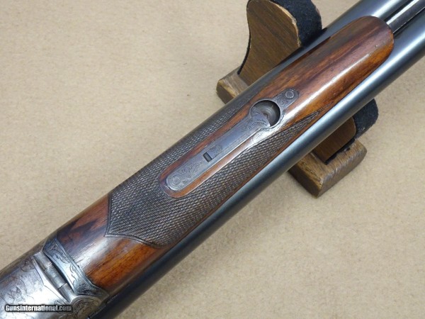

The more commonly seen patterns --
