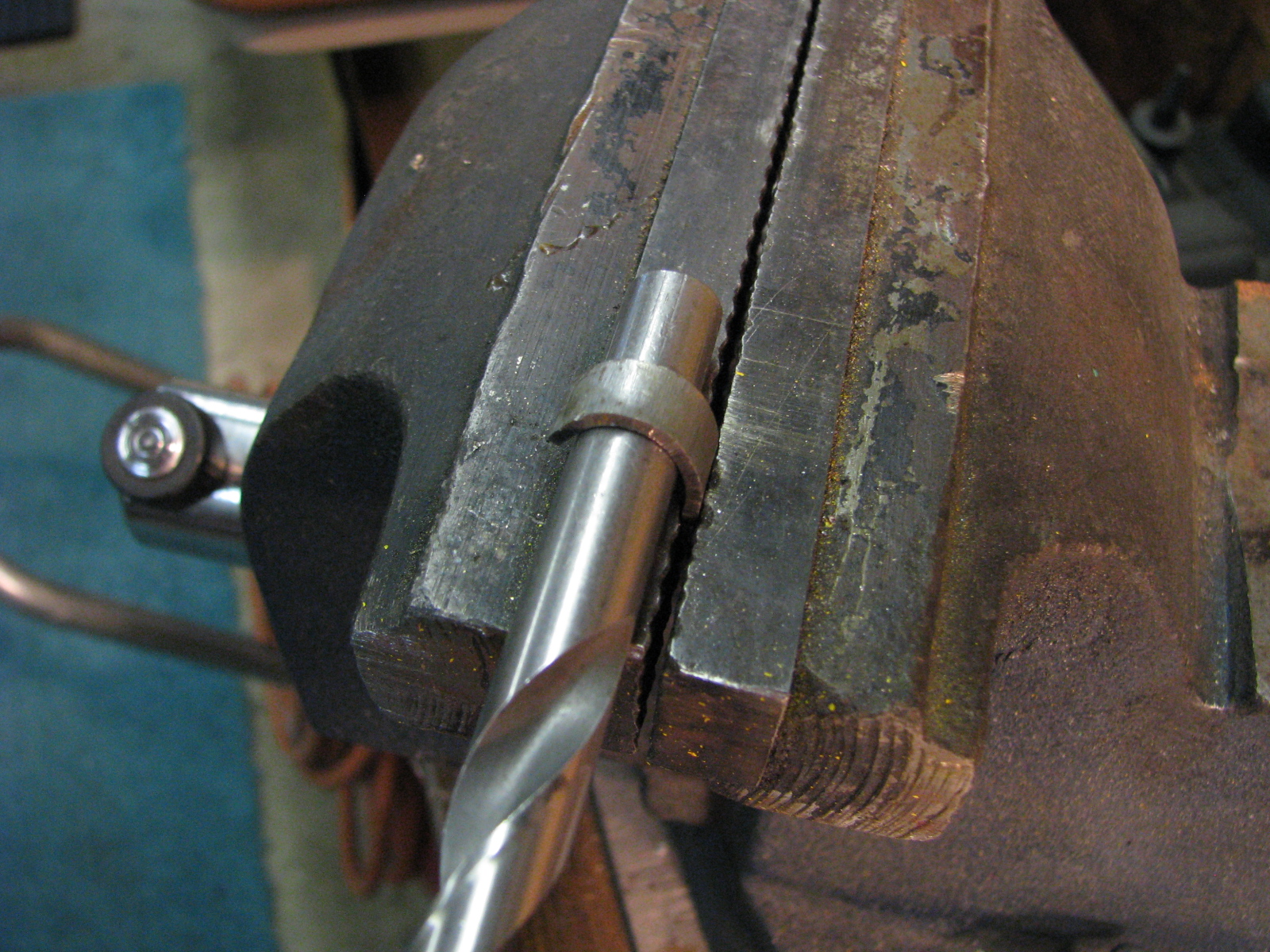

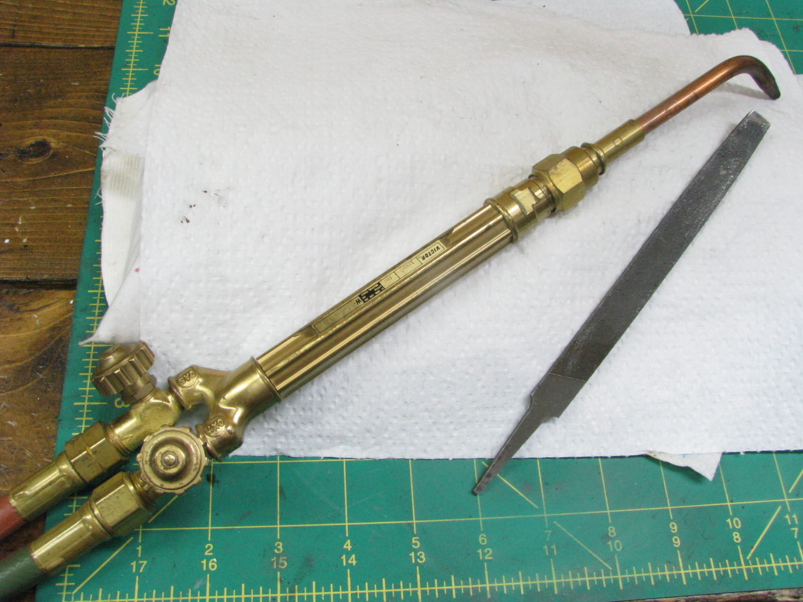

Easily done by a good man with an oxyacetylene torch, a medium sized brazing tip, a heavy vice and some scrap steel for heat sinks. The brazing outfit is a MUST for quick/concentrated high temp to melt the braze in just a few seconds, and before cooling just as quickly with wet shop rags on standby. I've done three of them now on barrel lugs that were goofed up by guys trying to improve the forend fit, or to use the standard forend latch with a replacement and thicker beavertail forend. I use Brownells Silvaloy 355 silver braze ribbon which requires more heat and is much stronger than common silver solder. Two layers of ribbon and its flux are spotted between the lug and the shoe before the rapid heat-melt-cool. Here's a small smattering of pics for info.
Just to show what can be done with some skill and equipment, and without waiting in some ‘smith’s queue and likely being pressured into rib relaying, rebluing, etc. Readers please note: this has worked well for me but I'm don't do this type work except on my own guns.

steel formed to make a "shoe"
top view of heat sinks, barrel shield and clamp, ready to heat
brazing complete, sides and then its top surface being filed, then ready for fitting its locking surface
fitting forend latch is in process, you'll want a tight fit and without the finger piece popping down upon recoil
fitted and spot blued, DONE

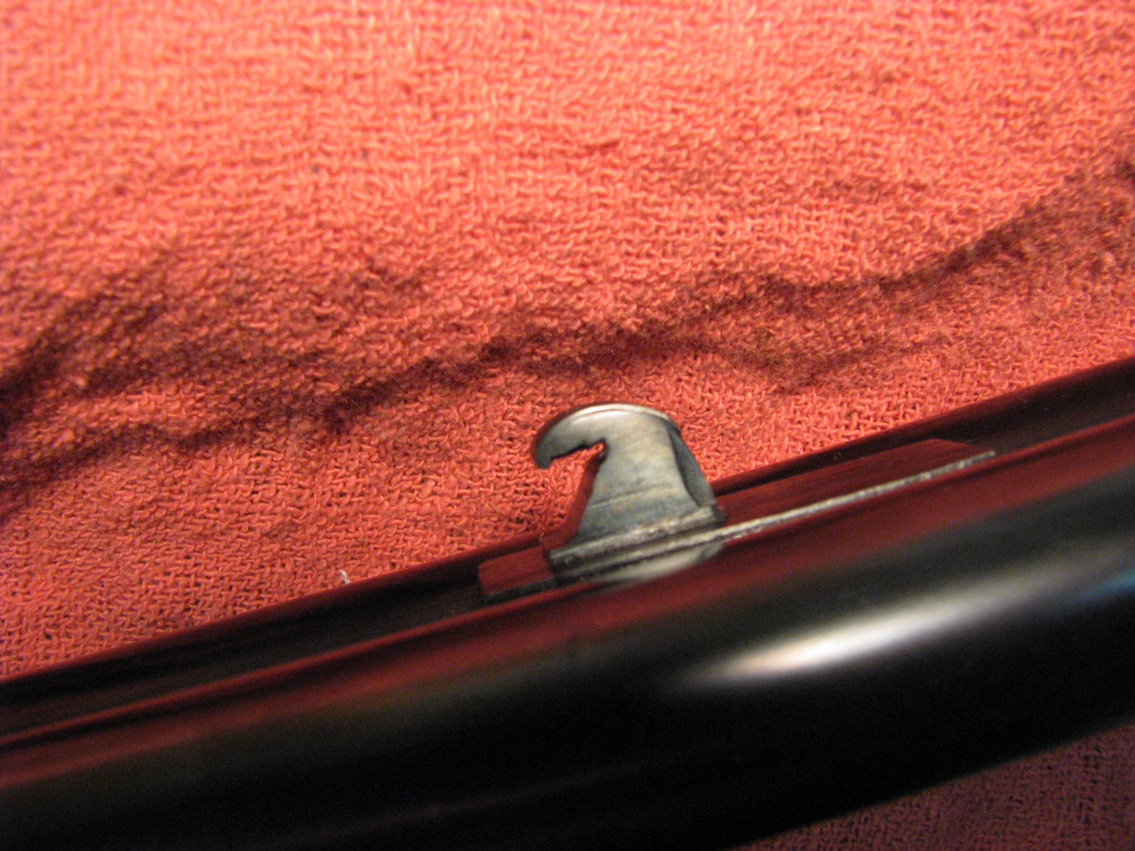

In the interest of clarity, and for the sake of others who are interested, I will post a couple close up pics of the broken lug later today.

Here's a photo of the screwed-up forend lug, with the broken piece lying on top in position. You can clearly see where it broke off. It broke because someone in the past filed away the top of the lug, weakening it drastically.
