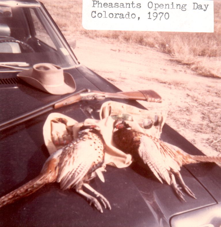

I'd say the vast majority (like 90%) of Pheasants I've shot from 1959 to today have been under 35 yards and a #7 1/2 trap load for the first shot or in the right barrel has been more than adequate.
One of my most memorable hunts was opening day 1970 in Colorado. No one was available to go with me, so I just drove out about an hour east of Denver, picked out a likely looking field of last year's stubble with a brushy fence row and went for a slow walk starting just after noon which was the opening. Got into a bunch along the fence row and shot a rooster and because I was alone with no dog marked him down and went right to him rather than trying a double. After I finished the fence row, I walked back through the middle of the field and noticed a swath about 20 feet long and at its widest two feet that the combine had missed so I walked by it and gave it a kick and out went Cock John number two. Took this picture when I got back to my car --
Crossed the road and walked down another fence row and maybe 100 yards in a rooster got up and flew low and I shot over him and didn't try the left barrel. A way farther and another rooster went properly up, Meat-in-the-Pot connected, and I was on the road back to Denver by 1:30 pm.
For Sunday, a classmate from Georgia at Lowry AFB was eager to go, but Saturday night a front blew through, and Sunday was much colder and spitting rain and we walked all day to get two.
