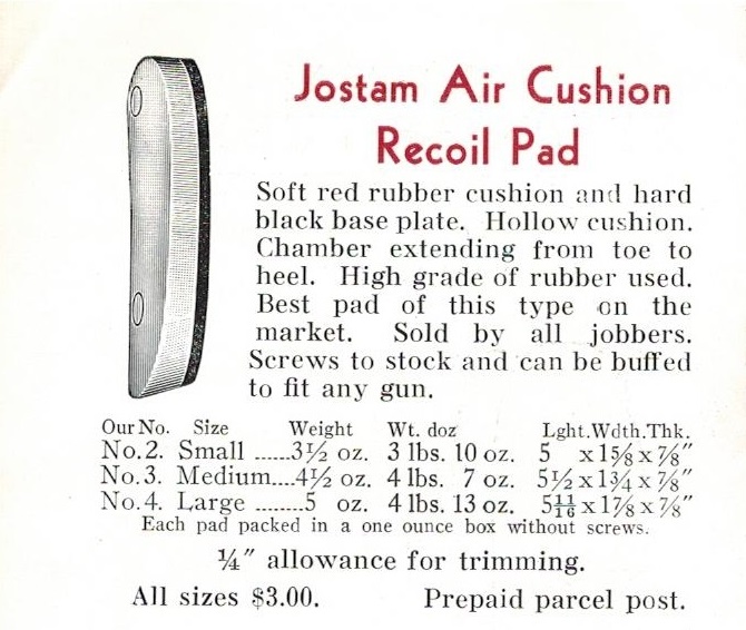

My plan is to send the gun to Chris Dawe once waterfowl season is over. The gun wears a very hard from age black Hawkins recoil pad. What would be the period correct pad for it? Did they come with a black Hawkins pad back then or would this have been a replacement by a previous owner?

The primary pad in use at the time your gun was made was the Jostam Anti-Flinch, a vintage pad that hasn't been reproduced.
Other pads available at that time were the Jostam Air Cushion --

The various Hawkins pads didn't come out until a while after your gun was made.
Of course, the Silvers was the "standard" the A.H. Fox Gun Co. installed on the XE-Grades and higher, but they don't absorb much recoil!!

Just some thoughts here: Burt Becker of Fox Company fame and one of the geniuses regarding the original boring of Super-Fox guns was reported to favor the Jostam "Hy Gun" pad (not shown in Dave's excellent collage). Same pad as furnished by the factory on Nash Buckingham's X/HE "Bo-Whoop" s/n 31088 except that its Record Card shows Hy Gain (sic). :)
NOS Hy Gun pads often seen FS on E-Bay and the rubber compound is usually quite flexible as compared with other vintage pads. That's the one I would retrofit on a Super-Fox to replace a bad pad. Personally I don't like the SW Silver & Co pads because of their giganto screw hole plugs. Just sayin'. frank

The patent application for the Hy Gun pad was filed May 21, 1926, and Patent No. 1,642,835 was granted Sept. 20, 1927. So I didn't mention it for a 1923 gun.
