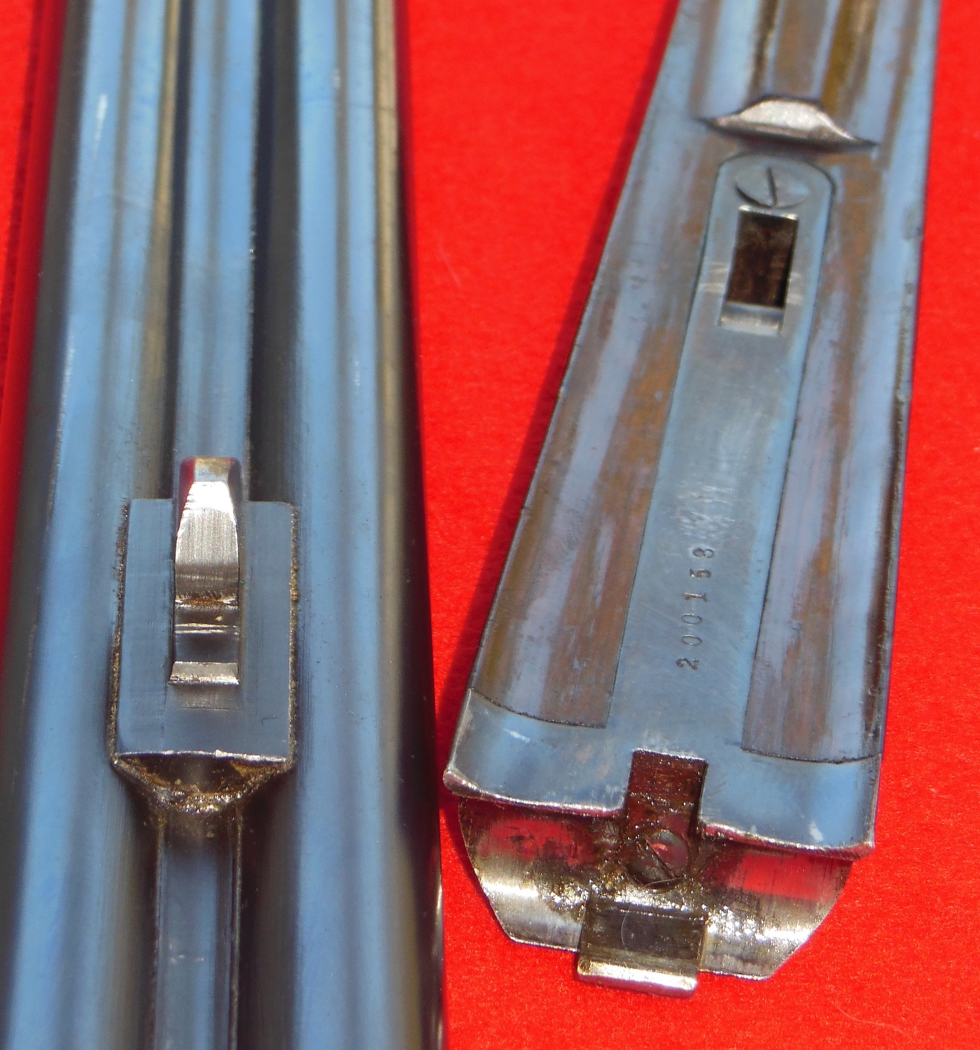

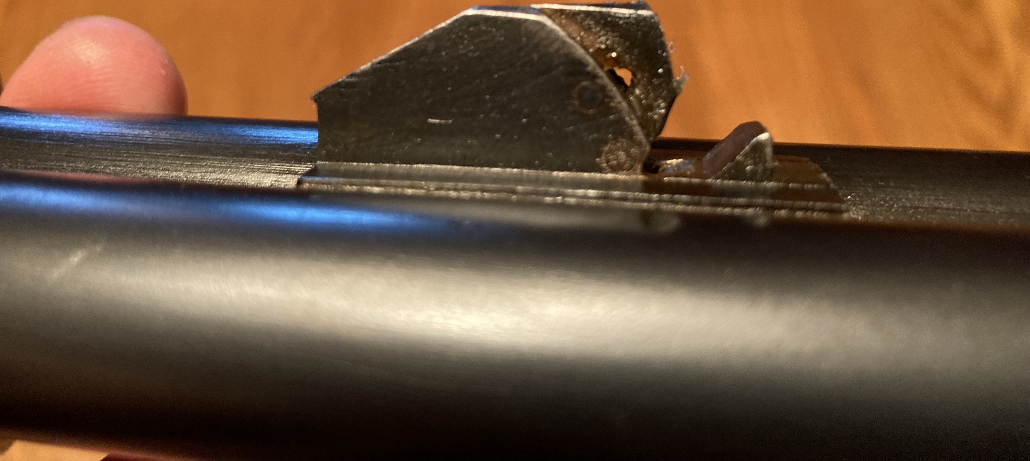

Also, the early small bore extractor guns, both Sterlingworth and graded, used the Fox & Kremer latch snap-on/-off forearm --
while the ejector guns used the F.T. Russell latch.
Later the extractor guns began using the F.T. Russell latch as well.
