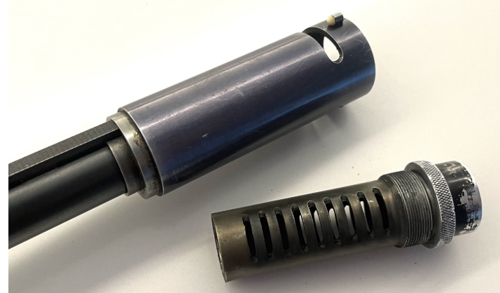

There was a question over on Shotgunworld about some choke devices from vintage skeet guns.
I looked through the Gun Digests from 1944 to 1959 and 1934, 39 & 41 Stoeger's and didn't see anything like this.
We know the Winchester Model 12 on the left and the Remington Model 11 on the right have Cutts Compensators, but what is on the Browning A5 in the middle?

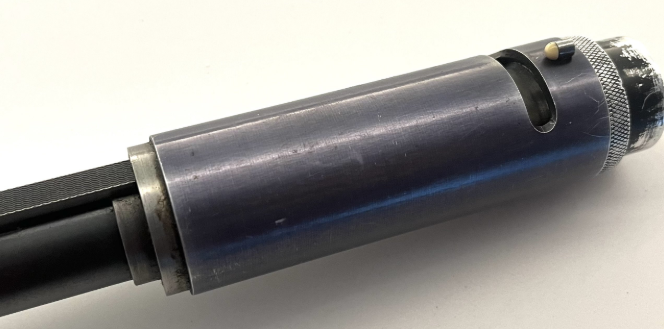

8) Original Maxim suppressor??

The choke tube looks like a Pachmayr with extra vents.

The choke tube pictured is a modified Pachmayr Power Pac, a popular device in the early days. I have one on a "real" 28 gauge Model 12 and another on a Model 42. Installed on the pictured base, it would direct all the gasses vertically at a more specific direction than it would on a standard Power Pac installation. The result was intended to be elimination of "muzzle jump". I can see the intent, but I don't see the need. In 65 years in the skeet world, this is the first one of these I have seen.
