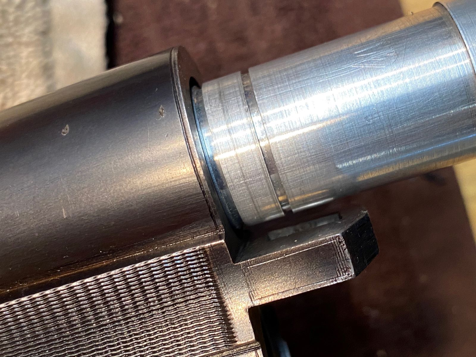

I shot sporting with some friends yesterday and the nephew of one was using a 12 ga Fox "Pin Gun" s/n 590xx that had a missing barrel keel. He asked if I could replace it and we made a deal to swap some parts for the work. So last evening I checked the bores and chokes and was surprised to see the chambers are really short at about 2-7/16". The nephew was shooting 2-3/4" Federal promotional shells in it. Now. let's say the Pin Gun being that early was originally chambered for period 2-5/8" shells ..... but even with a 1/8" hull overlap into the cone those chambers are still pretty short.
Here's a pic showing my chamber gauge in the left. Those rings on the gauge are at 1/4" increments, first one back from the chamber indicates 2-1/2"
Some txts to my friend and nephew asked if I could also extend both chambers to full 2-3/4". Some wall measurements first to verify thickness and that's now done. frank

Wow, those are very short chambers! One would wonder with shooting 2 3/4” target loads in those 2 7/16” chambers what the additional pressure would be?!
