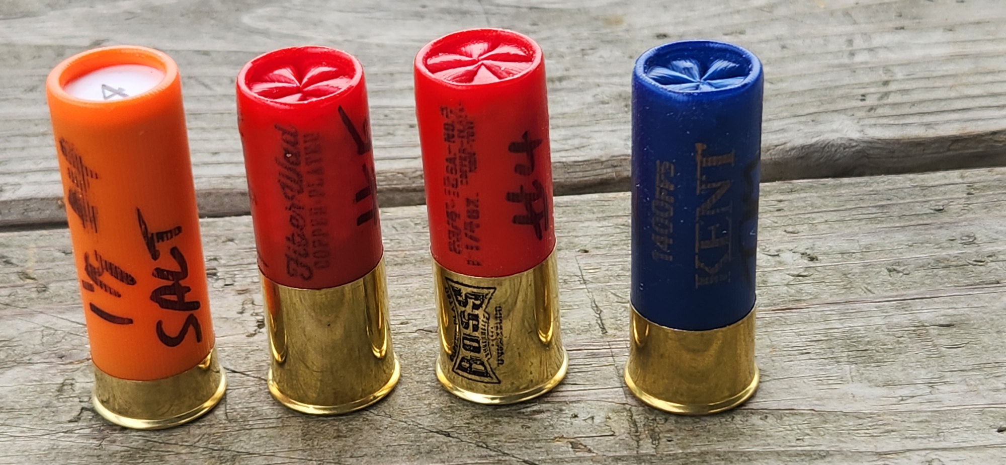

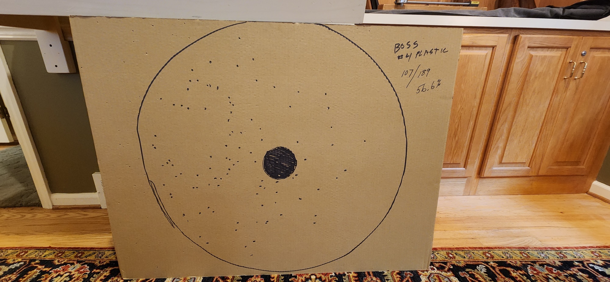

After reading Jeff's article in the last newsletter I decided to pattern my Super Fox with four different shells to see if my gun printed patterns similar to Jeff's. As you may recall Jeff had open patterns from Boss ammo in his SF. (57.6% and 54.2%) My gun has 32" barrels, bores at .738/.738 chokes at .049/.050 and 3" chambers factory original as measured by Frank Srebro. All patterns shot at 40yards, pellet counts inside a 30" circle. Shot from a benchrest on bags. As you can see from the pattern boards my SF shoots patterns a little of the the left at 40yards.
1. Boss 1 1/4oz #4 copper plated plastic wad, no filler 56.6%, 1350fps- pattern dense to the left, light to the right

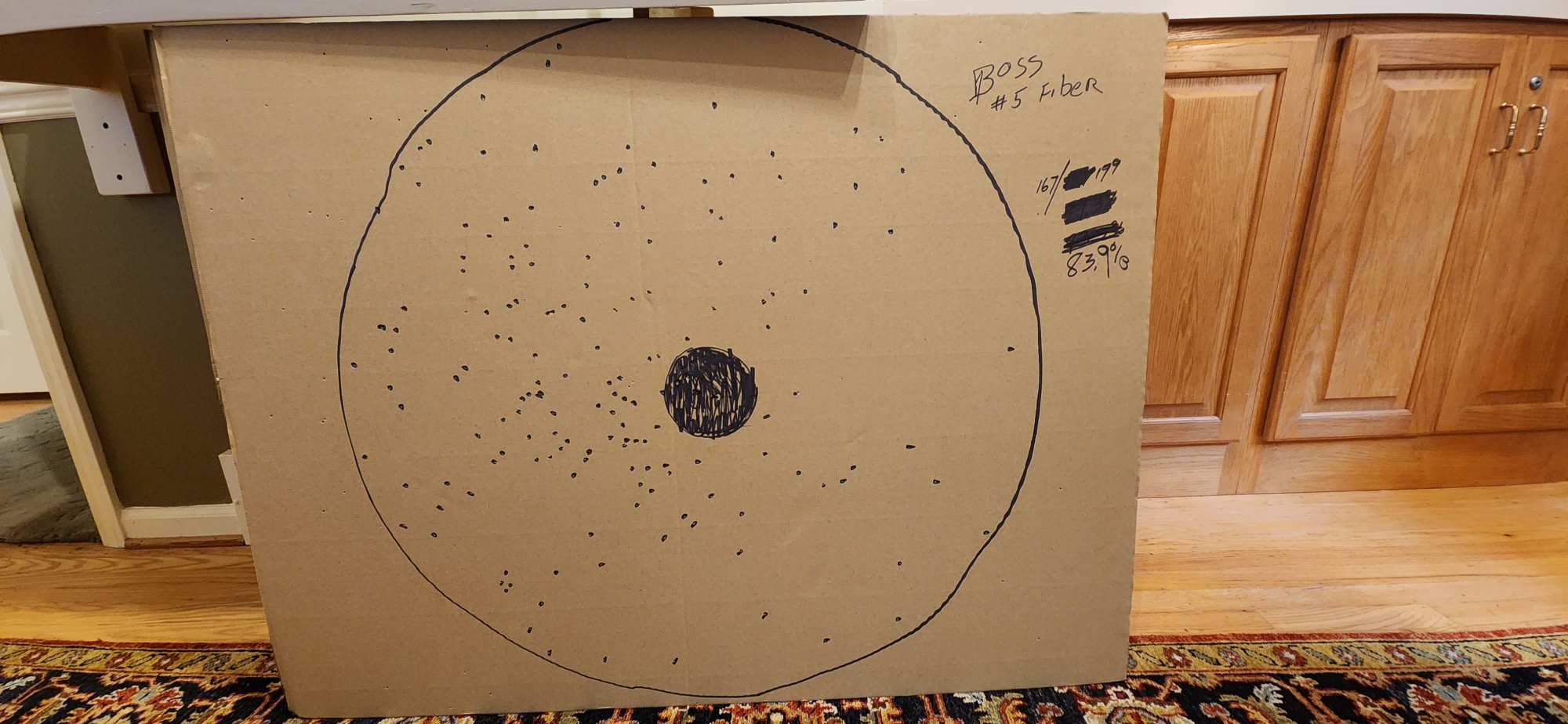

2. Boss 1 1/4oz #5 copper plated fiber wad, no filler 78.7%, 1275fps- pattern dense to the left light to the right

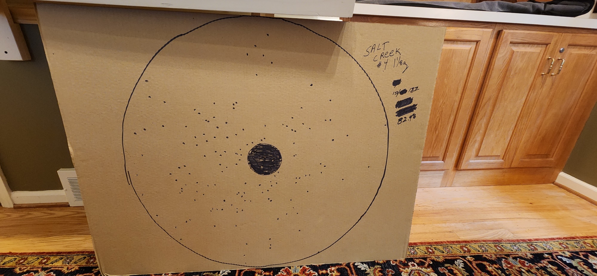

3. Salt Creek 1 1/8oz #4 plastic wad with filler material 82.9%, 1300fps more centered but uneven distribution(this is a low pressure load of about 6100psi)

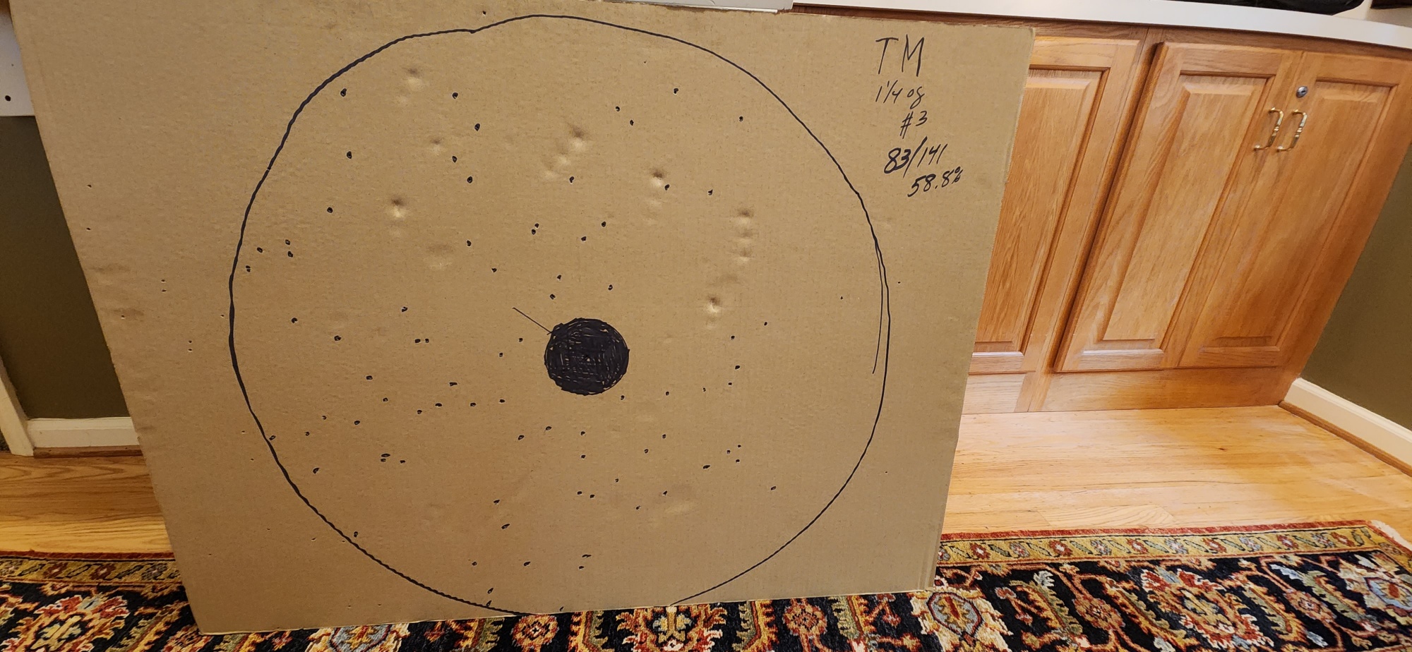

4. Kent Tungsten Matrix #3 plastic wad no filler 58.8%, 1400fps pattern dense to the left light to the right
I got very similar results as Jeff with the Boss copper plated bismuth and plastic wad. The Kent TM also patterned very poorly. It may be that the very tight chokes in a SF do not pattern well with some loads.

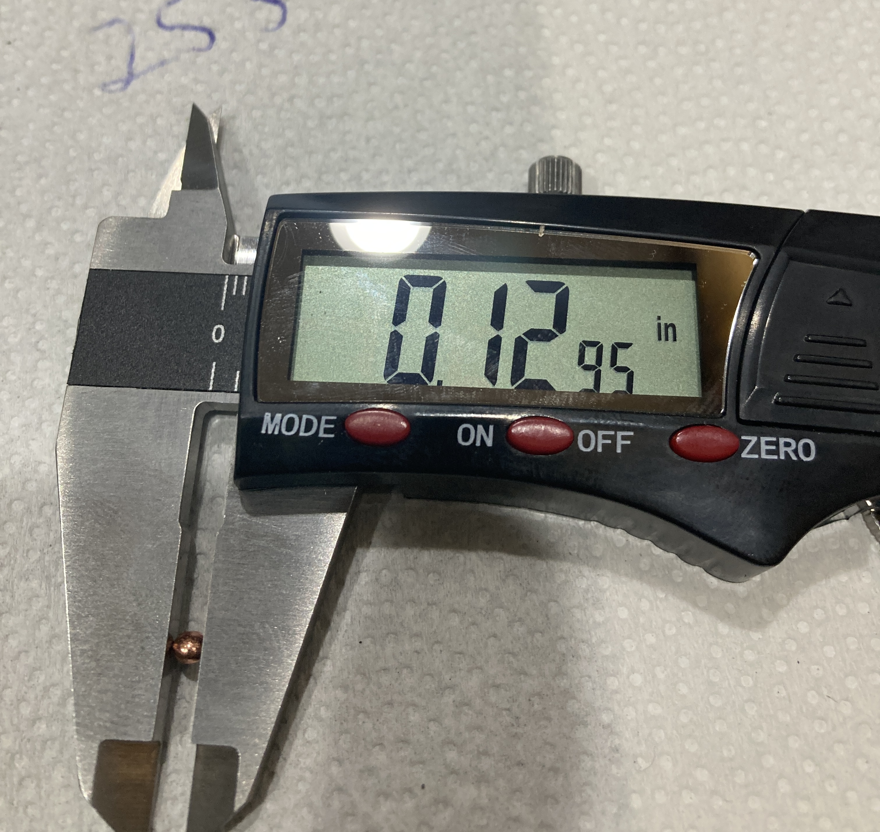

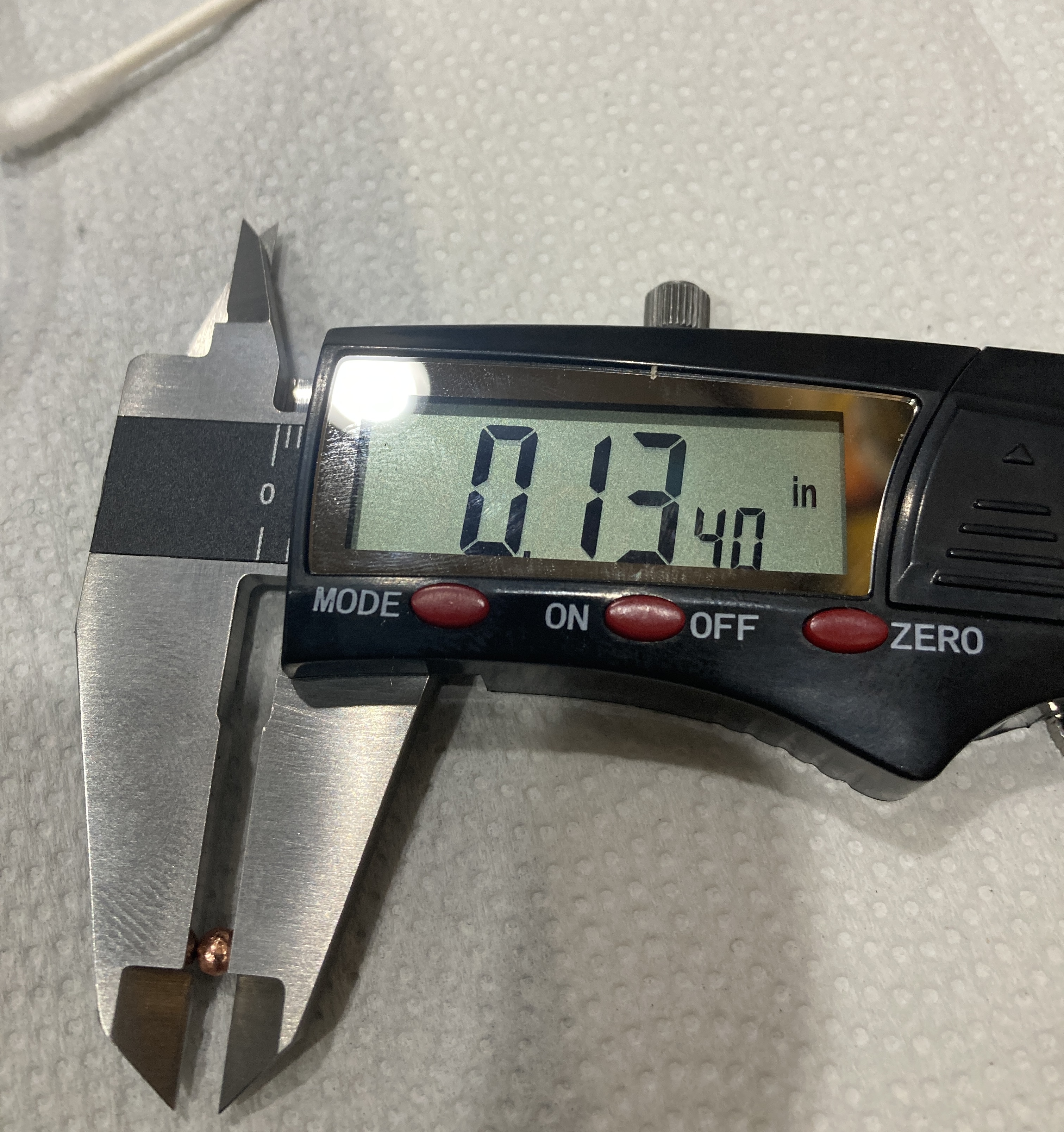

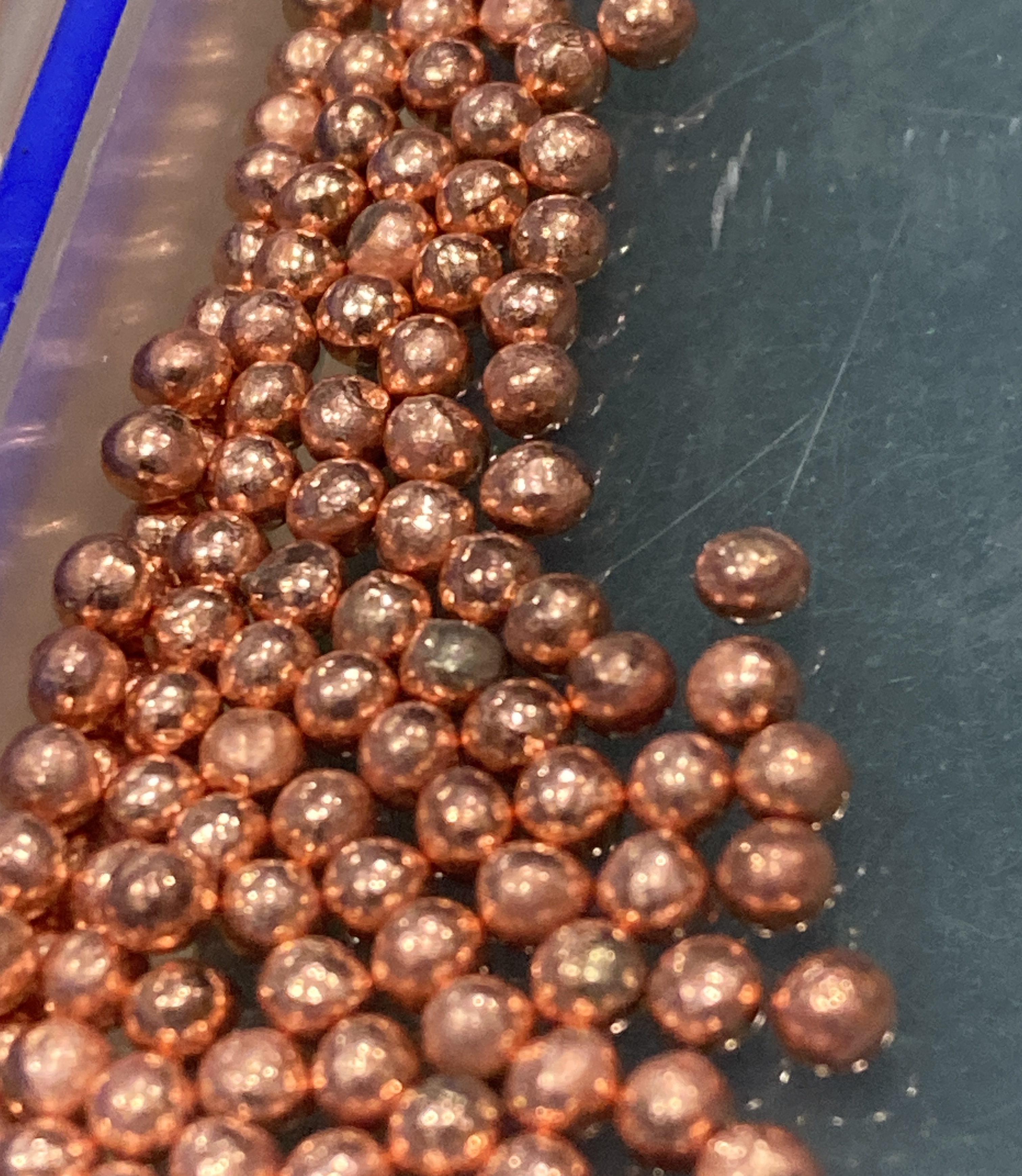

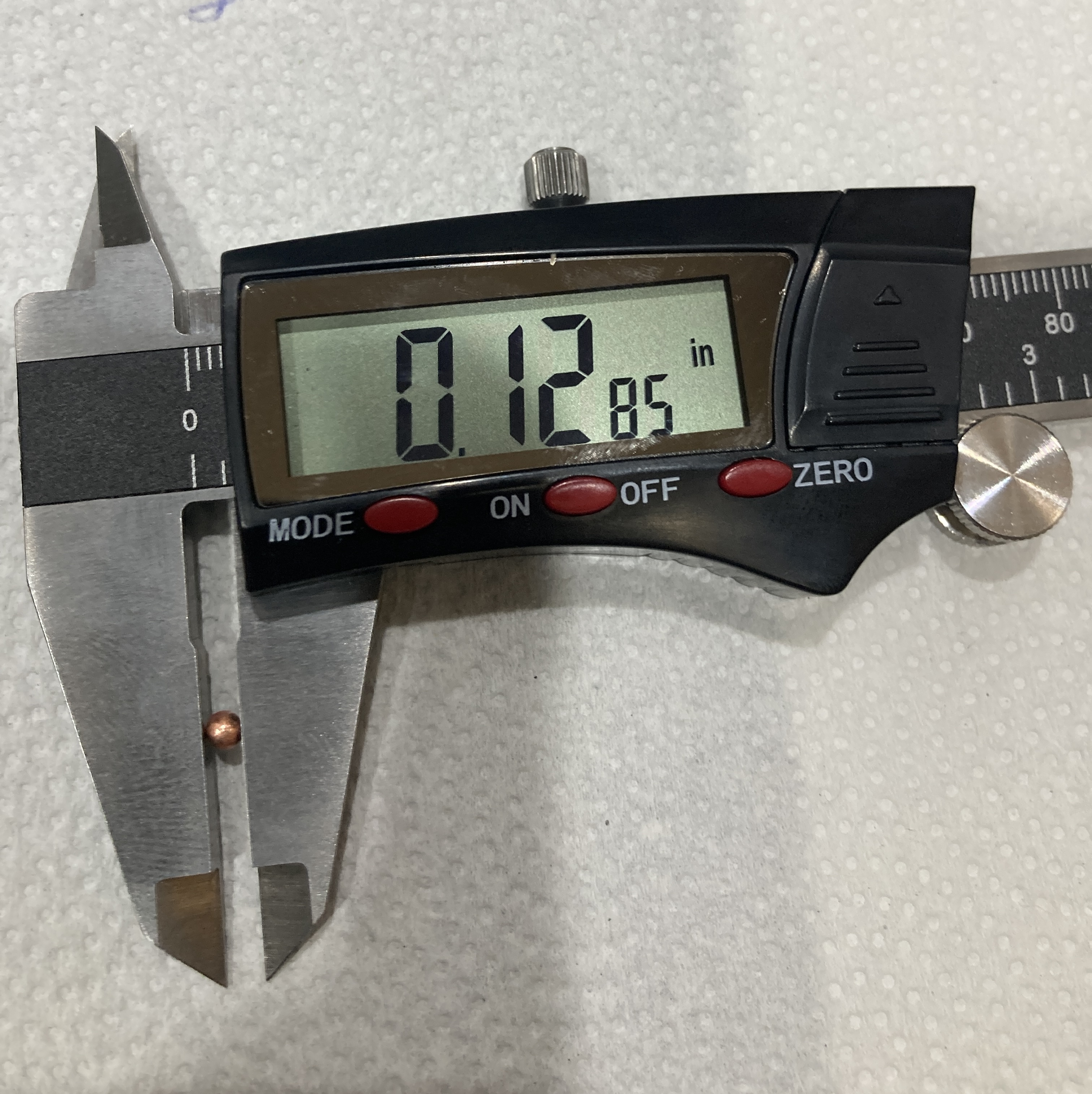

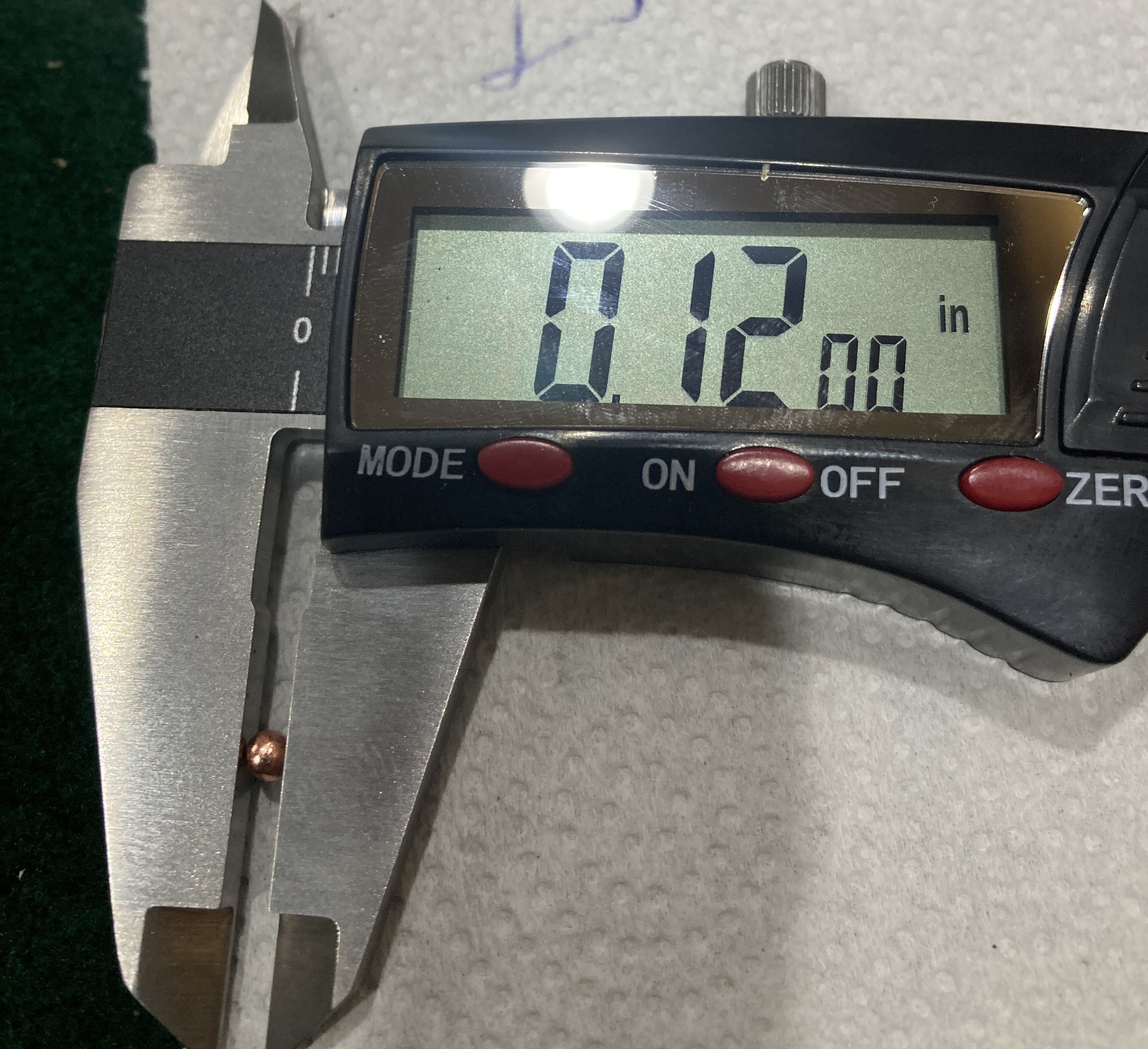

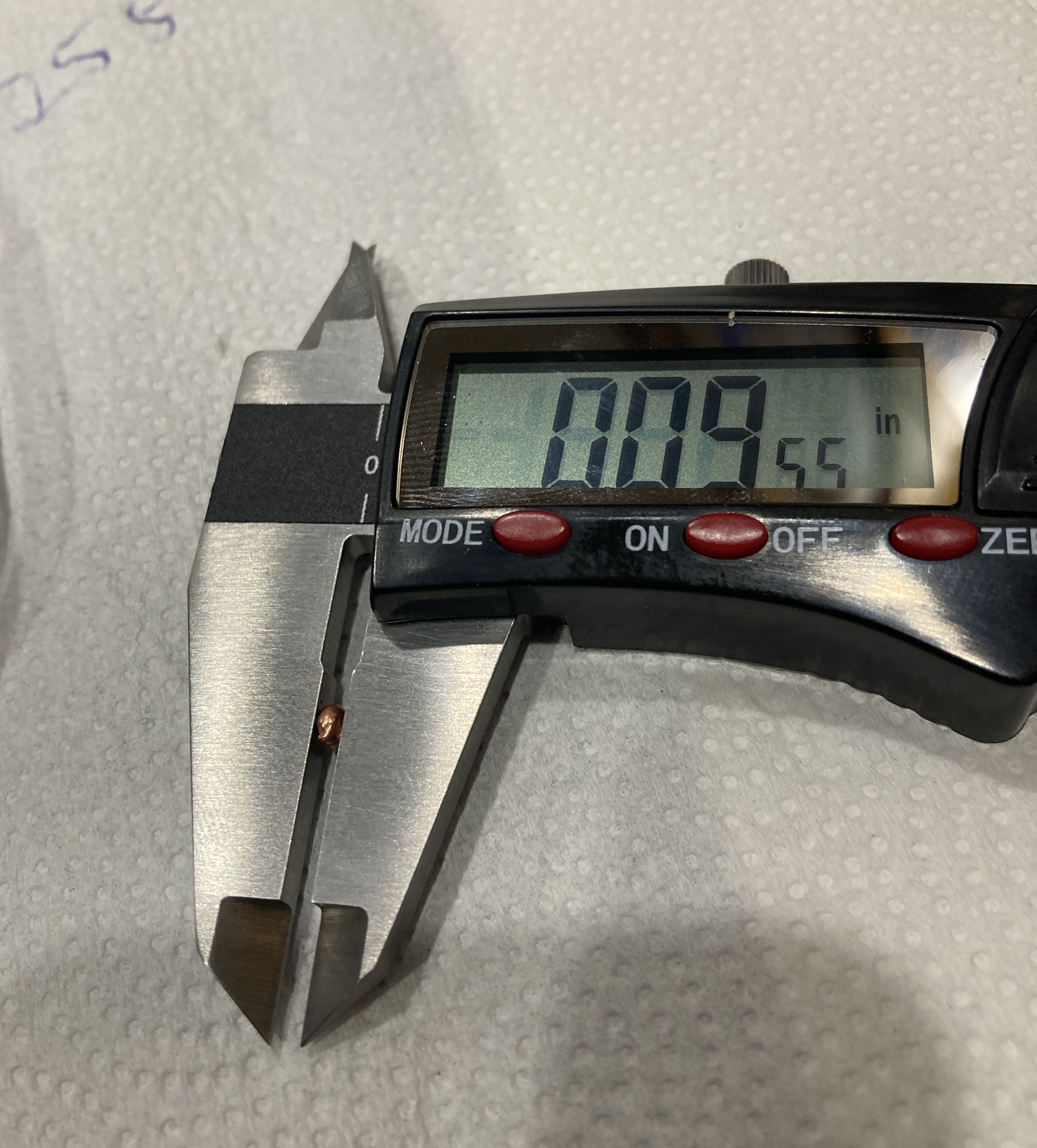

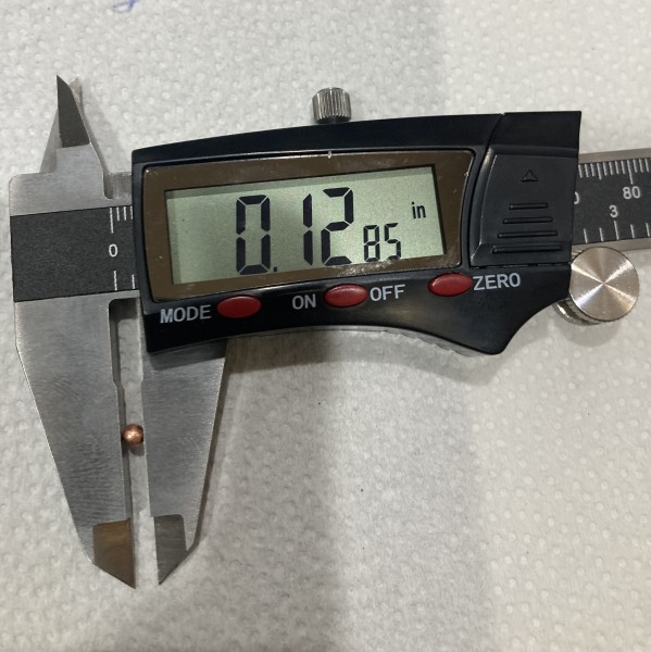

Next Frank asked if the pellets look good? Are they consistent? Are there abnormalities? Let's take a look. Here is a picture of the pellets in a Tupperware dish. Notice the variations in color (thin plating?) I selected one pellet and measured it 3 times, in different orientations. This is getting big, so I'll post and continue.
First of all, I'm amazed that Craig's results were so close to mine. A slang term for shotguns is "scatterguns" for obvious reasons. When I take multiple test patterns with the same ammo, the results vary because shotguns are not "precise". The fact that Craig and I got the same results is pretty cool. Also, I remember "Kimber" (Don) mentioned that he experienced a mediocre pattern.
When I stumbled on to this situation, I was just doing a casual study of my guns, so perhaps I wasn't as thorough as I should have been. Shame on me, so let me add to this saga. Frank asked a couple of good questions. #1. Did I count the pellets. No, I did not. I went to the Boss webpage and they stated that there were 238 pellets per shell. Today I opened up my one remaining shell and counted 246 pellets (twice). This increases the denominator which would bring my pattern of 57.6% down to 55.7%.

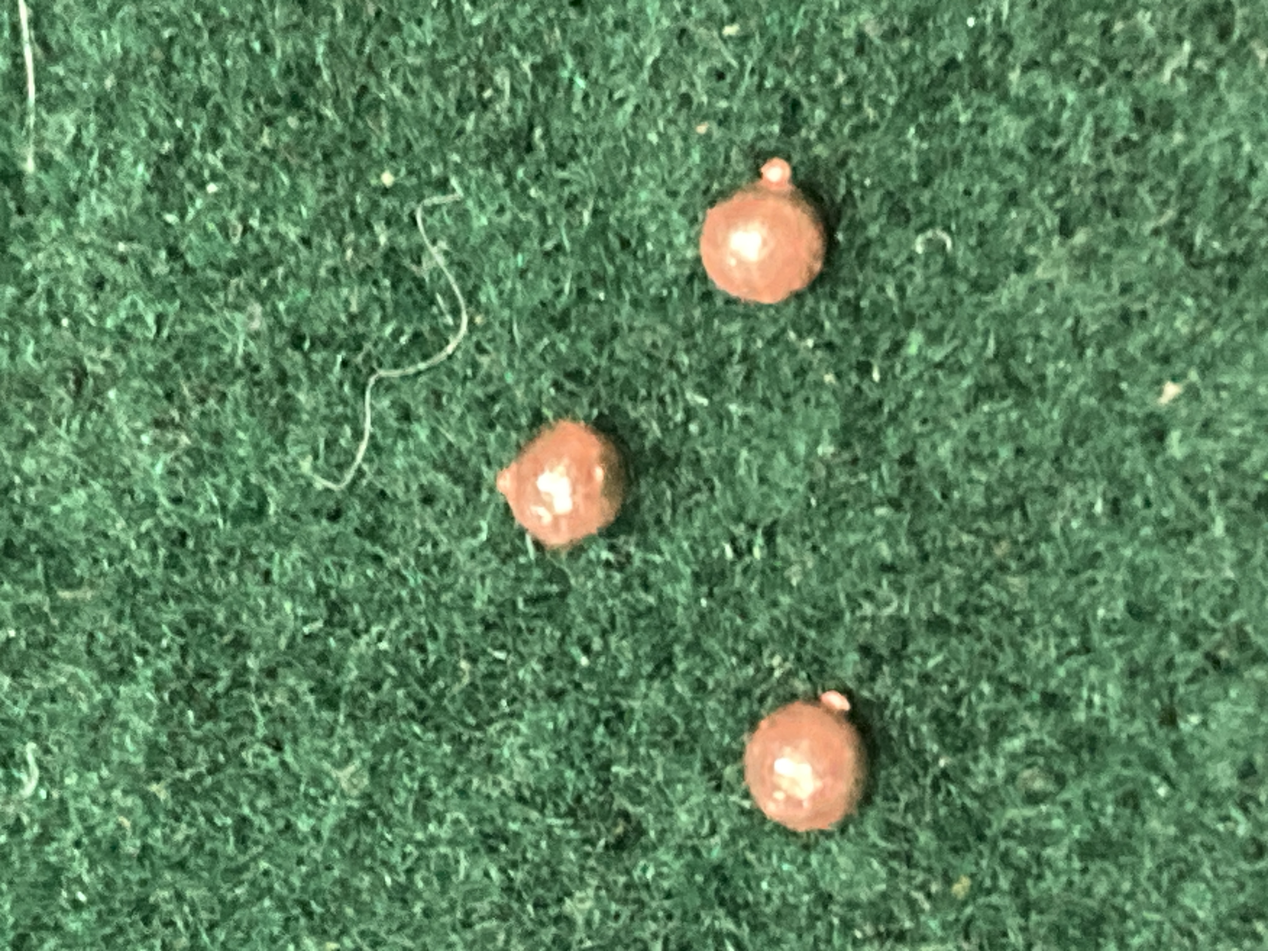

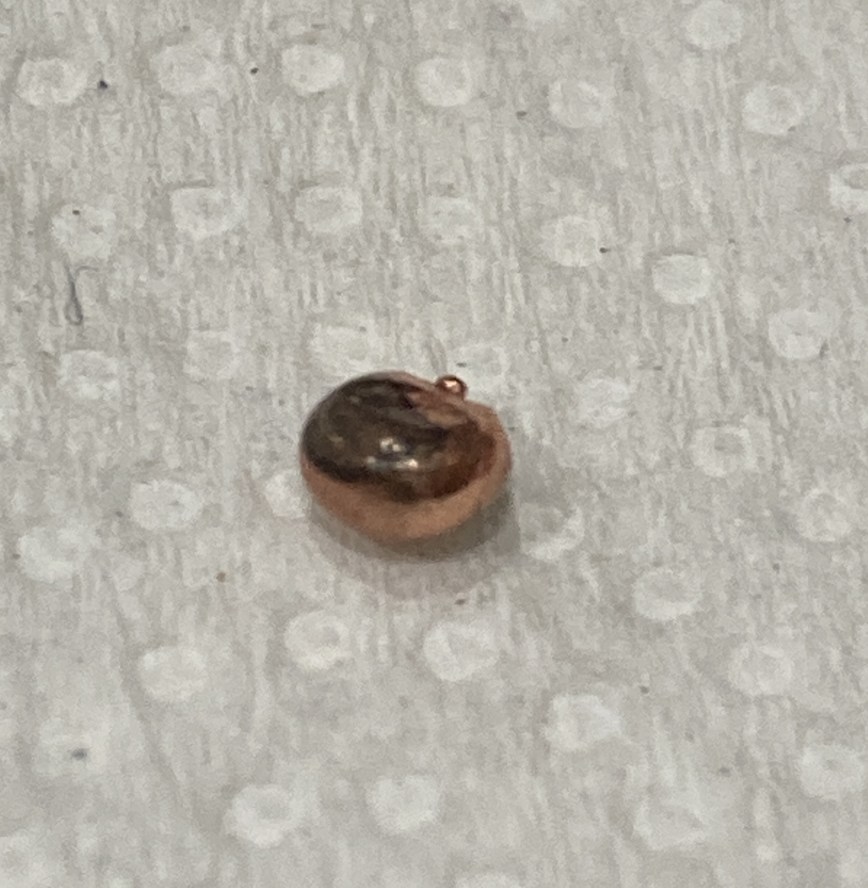

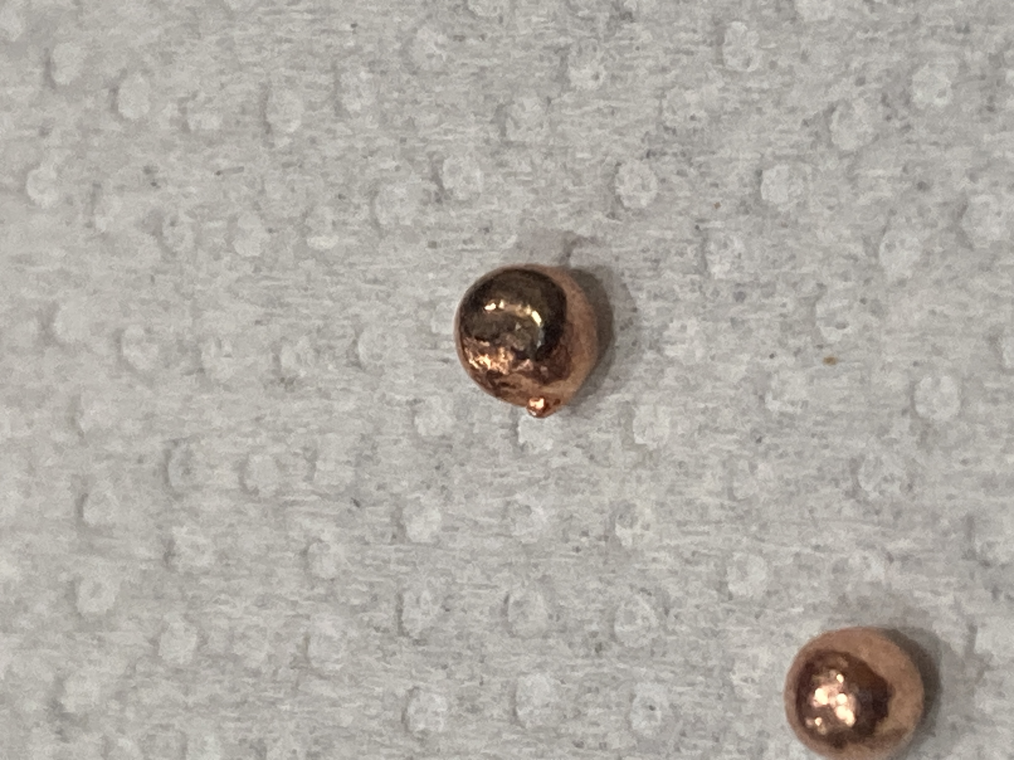

Here is a pellet that I refer to as the "pancake". Now, a perfect "sphere" should fly true. An irregular pellet will probably not fly true. We’ve been lead to believe that copper plating is a good thing, but if the process leaves a drip on the pellet, it’s not good. Please study the next two pictures.
In all fairness to the very nice people at BOSS, we might find similar results if we opened up shells from the other manufactures of non-toxic ammo.
Craig took this study further than I did. He compared a wider variety of ammo, and got some very interesting results. From my perspective, and what I observed coming out of my Super Fox, the wide pattern was caused by pellets crumbling (fragmenting) as they were traveling through the choke. No doubt in my mind. I also noticed that Craig's pattern with the fiber wad BOSS was pretty good. I suspect, but cannot prove, that it's the result of the slower speed, not the wad (I could be wrong). Speeds of 1350 MIGHT work in a full choke, but not in an extra full choke. It seems that at some point, the tightness of the choke and the speed of the pellets "converge" to fragment the pellets and ruin the effectiveness of the load.
