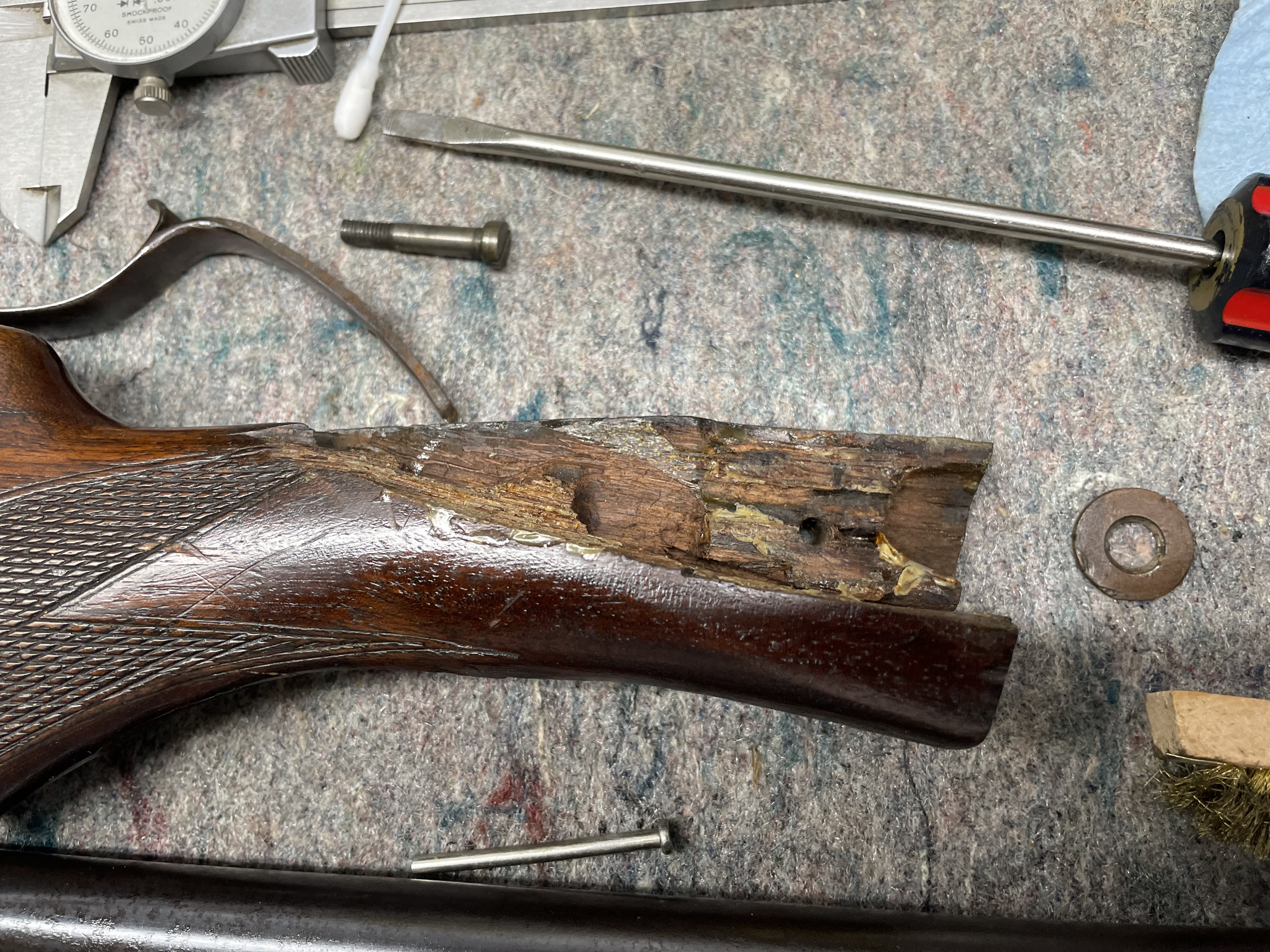

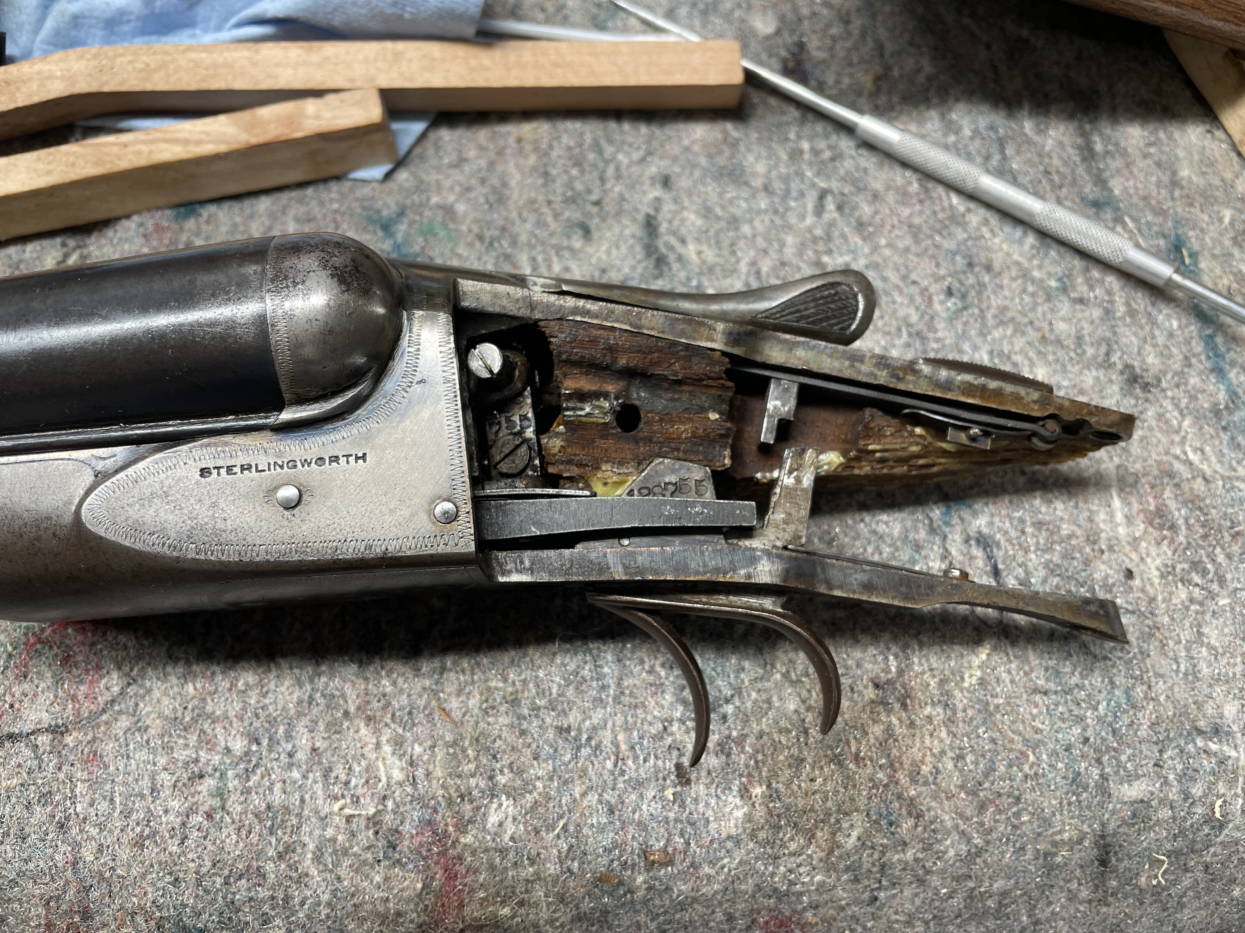

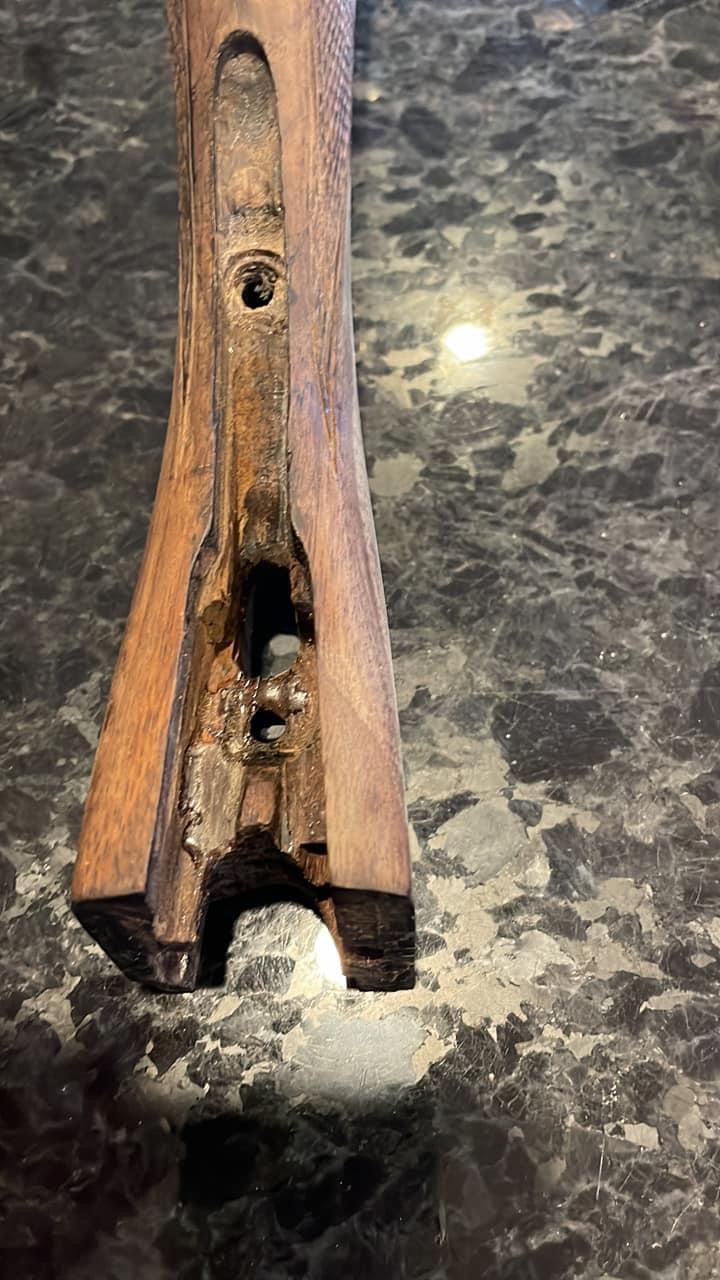

I received this Fox Sterlingworth . I was going through it and noticed the stock is in worse shape than I thought , see pics . Where would one find a stock to restock this gun ? Thank you

Stocks were to a greater or lesser degree hand fitted and they won't just swap. The shape of the frames where the stock fit up to it also changed over time. Getting a new stock properly inlet is time consuming and spendy. Going to cost more than a 12-gauge Sterlingworth is worth in the marketplace. Probably a good place to start would be Show Me Gunstocks in Warsaw, MO. Depending on how much you are willing to spend, there are several top-notch custom stock makers, some post on this site.

With all due respect, what was the condition you expected? That condition by any picture i can envision is totally destroyed.

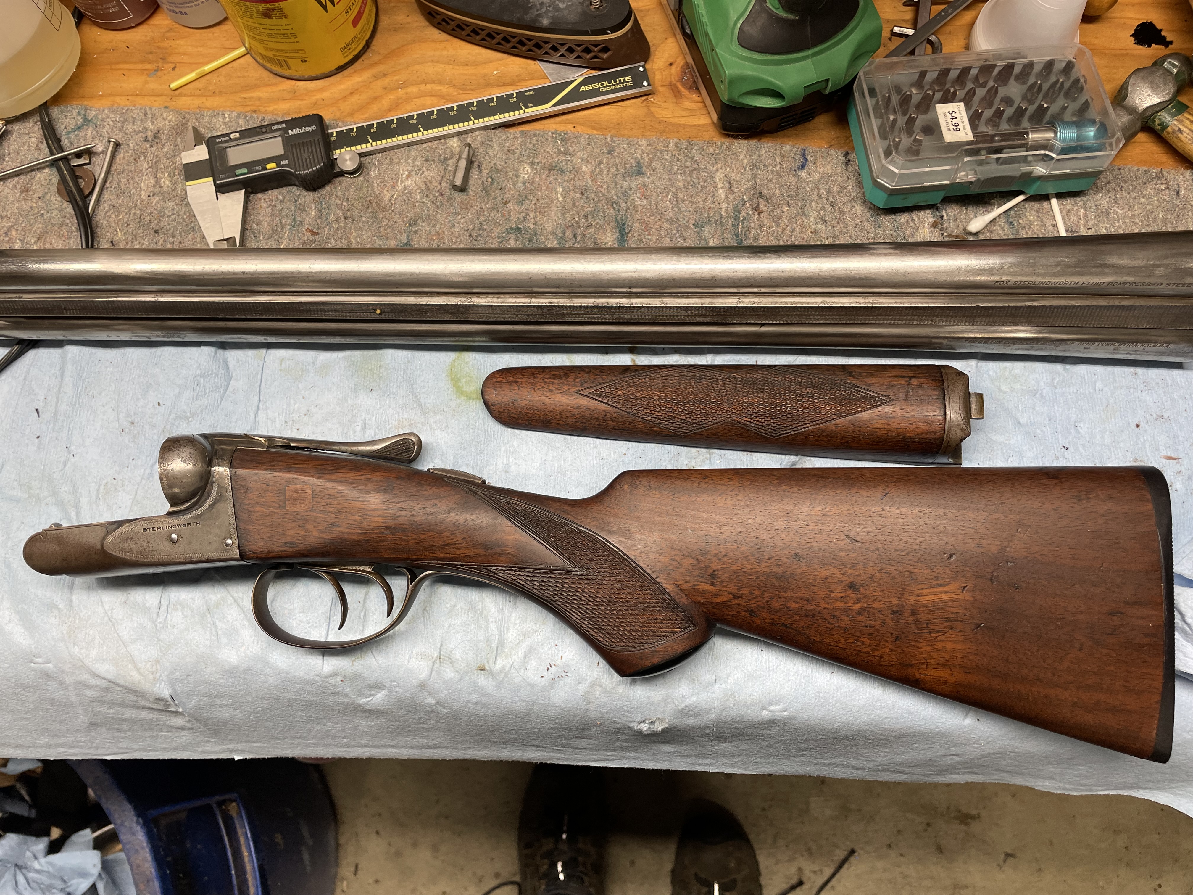

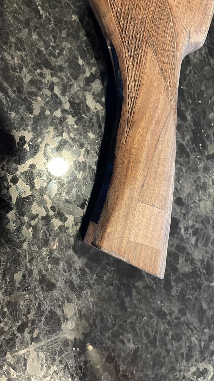

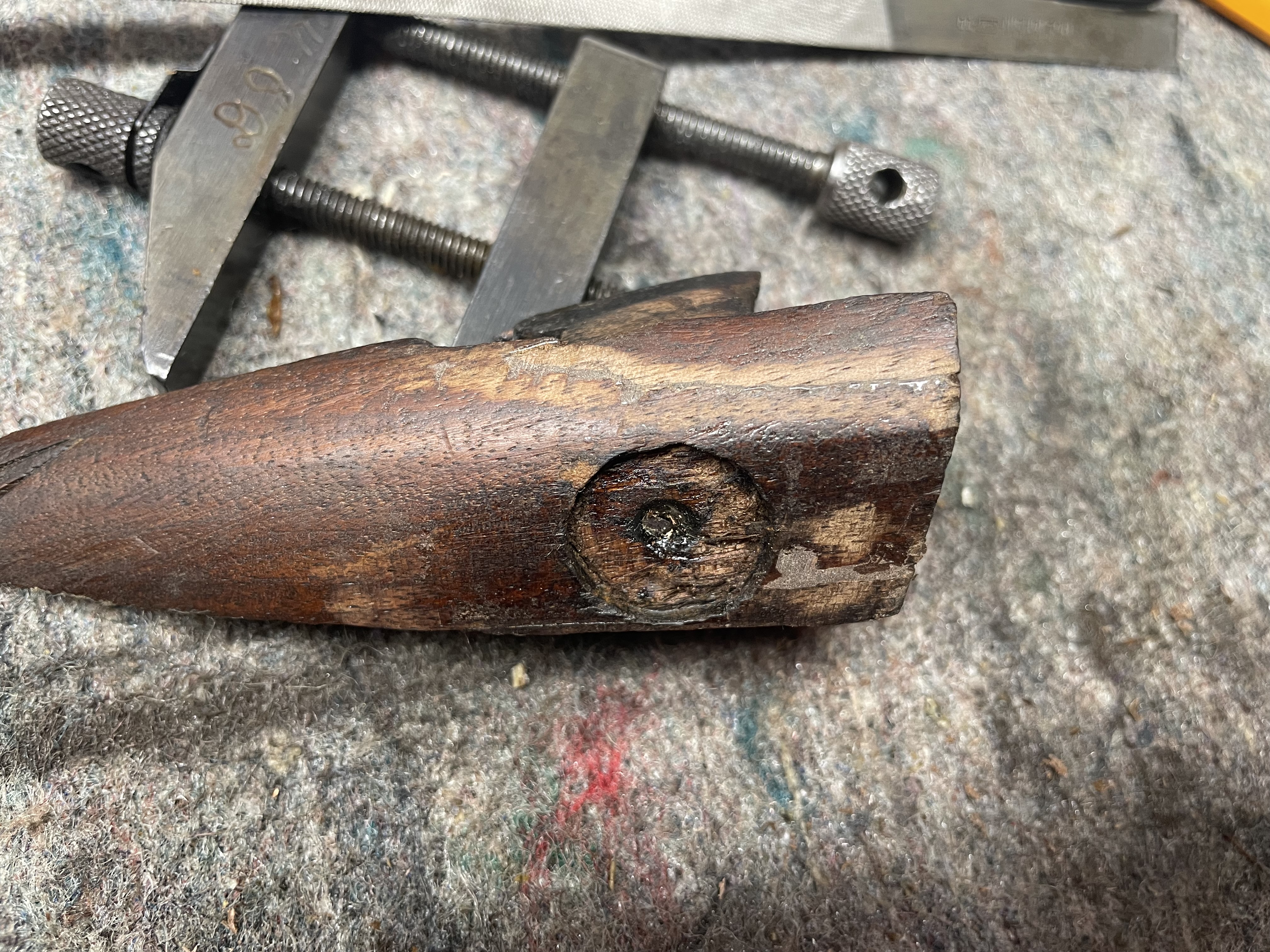

So I took the time and repaired the stock using modern day adhesives and I think it came out great . The patches where someone ran a flathead s tee and washer down through need to be blended better but it is good for now .
Posts: 3742
Has thanked: 2733 times
Been thanked: 1666 times
Re: Stock for Fox Sterlingworth 12 gage
Wow! Good for you. You’ll get a lot of satisfaction and enjoyment out of that stock. Nice job!

Fantastic job on the stock repair. I think if that holds and you shoot it well use it that way as long as you can. Great job!!! Well done!

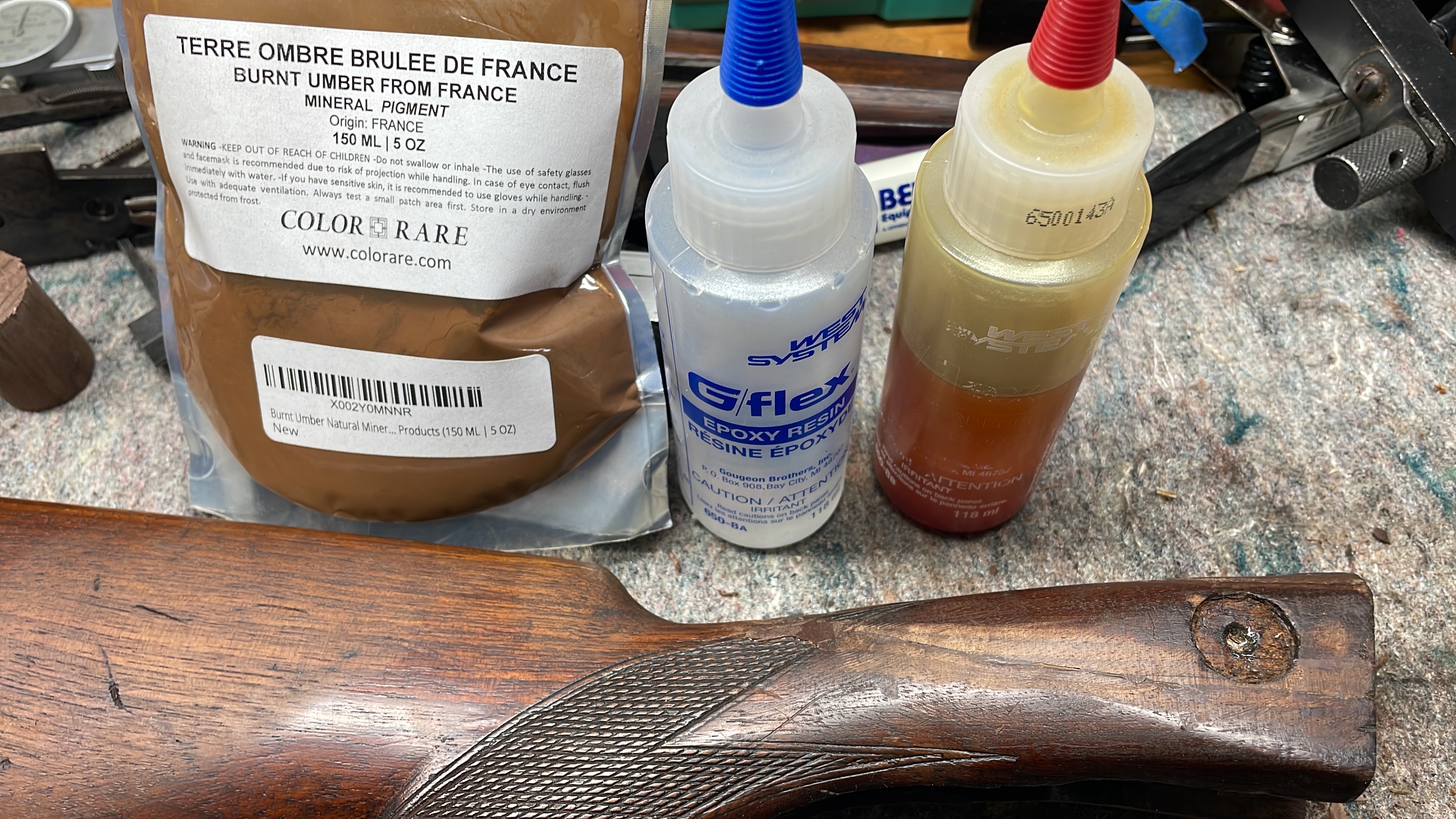

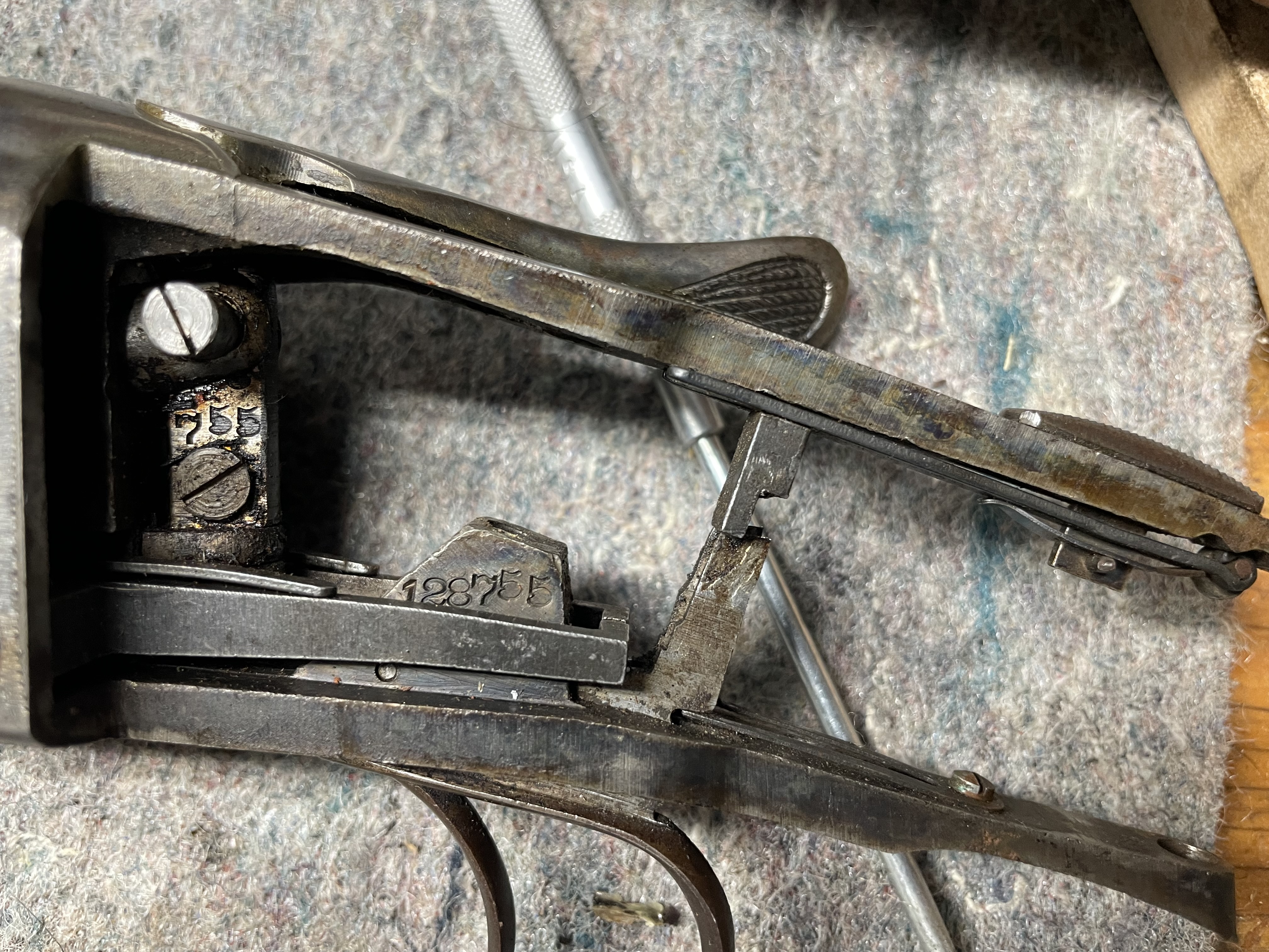

Thank you guys ! It has been a bucket list item to restore an old SXS for years , I found this one and I knew it needed some love . Someone had tried to repair the stock but it did not hold . It looks as though they used a wood glue of some sort . The stock was oil soaked so a few soakings in acetone until it was clear revealed areas where glue was . I scraped it all out and infact used the screw as a stud to hold the major portion that was broken off in . I used the West system with walnut wood flour and coated both pieces , some fancy clamping and it worked out . The key was to make sure all metal fit after this was complete . I did notice the back tang screw was bent and could not figure it out but it was evident the recoil was not being taken by the end of the stock but by that screw . I got deeper into it and reset all the metal the best I could so now the recoil shock will be taken down the length of the wood stock at the same time I matched the wood to the metal better to minimize the steps that had clearly been compromised over the years . I then rust blued the barrels . Pretty cool project . My buddy said I should close down my fishing reel repair business and gunsmith . Lol we will see . Thank you for all the posts on the forums as I have learned a lot .

Last picture: I don’t see the “trapezoid” that bears against the boss on the trigger plate to draw the stock head tight against the frame. Looks like it was broken out or possibly removed because someone thought it was irrelevant. I’d suggest you inlet/epoxy/screw in some walnut and shape to recreate the trapezoid. The “recoil shock” as you termed it should be directly borne by the stock head not along the length nor at the very end of the tang, and the trapezoid insures that happens. frank
