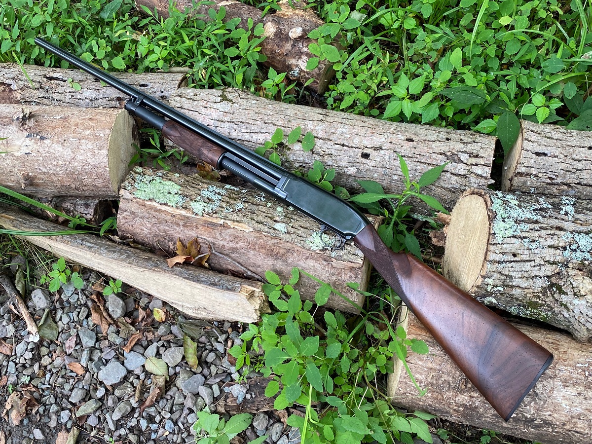

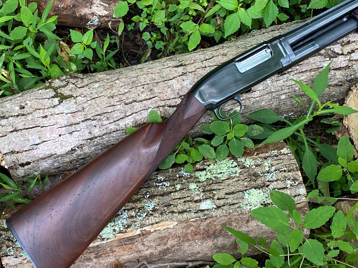

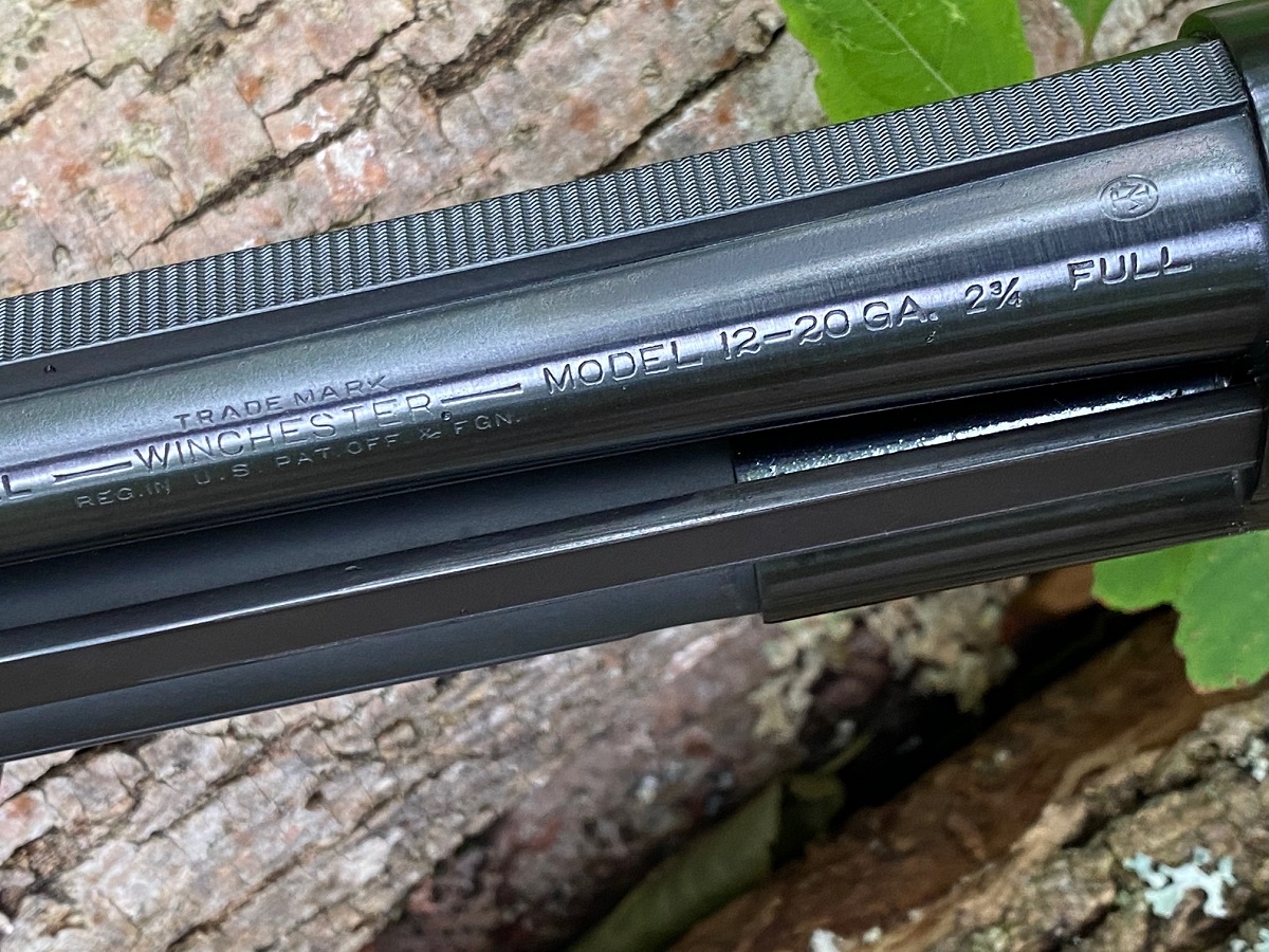

A few pics of my Model 12 20-gauge straight gripper, 28" Nickel Steel, solid rib, Full choke, weight 6-9. Made in 1927.
She came to me with a headspace issue and resulting extraction problem. A replacement chamber ring had been improperly fitted, supposedly by a well known gunsmithing firm. Those familiar with Model 12's know the ring must be absolutely dead nuts concentric/sized to the back end of the chamber, and this one was was off. Normally that's done with special piloted tooling from the muzzle end, but a NOS unfitted chamber ring and improvised setups on the lathe and mill did the trick here.
I shot her for the first time a few days ago, 42/44 on Super Sporting clays. She fed and extracted perfectly with a mix of Remington, Federal and Estate factory 7/8 ounce loads. All with modern steel base hulls that often cause problems in Model 12's. Ready to rock on! :D
There are some small raindrops on the Winny in these pics

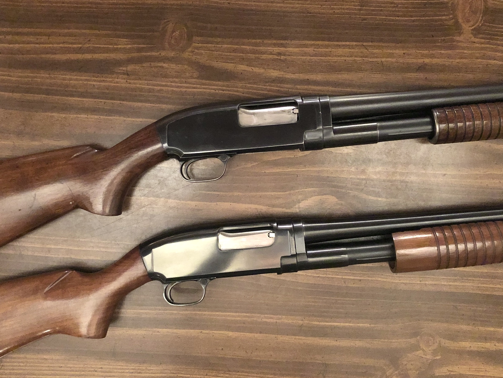

Newer forum member running into an older post of interest.
Nice 20ga Model 12! When I’m not shooting one of my doubles, I’m shooting one of my Model 12’s, My near mint condition(1963) 28” 20ga field model(bottom), and, my go-to for decades, (1941) 28” 12ga field model which I eventually added a Briley thin-walled, flush, choke system. I also own a 12ga skeet model. My 12ga Model 12’s feed flawlessly with most all ammo, My 20 is pickier, preferring brass cases.
