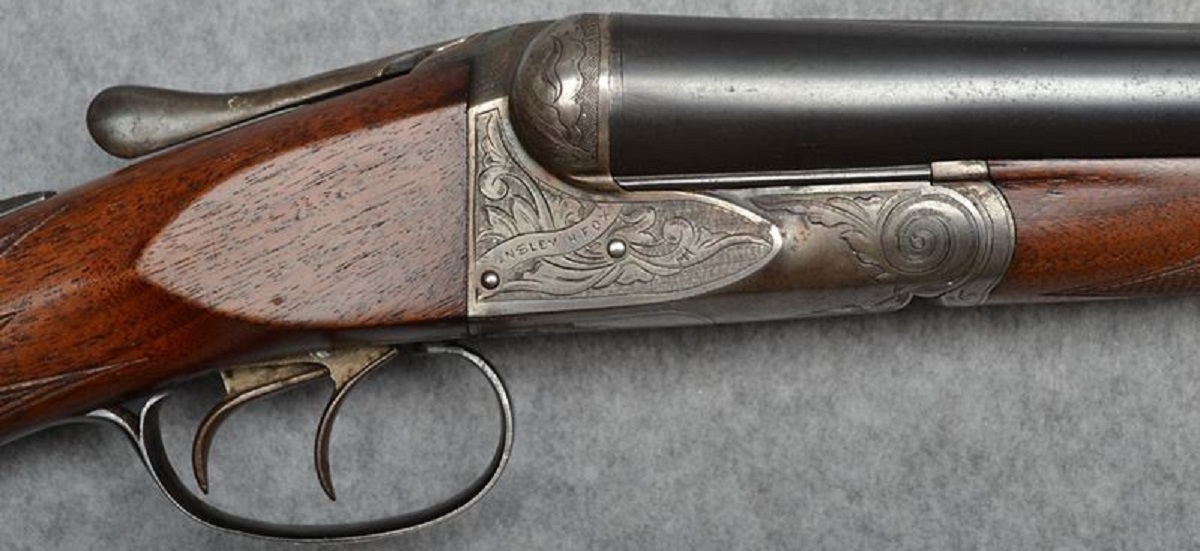

Can SP barrels be fitted on to an A Grade Savage Fox?
I have an A Grade with 32 inch barrels and would like to add some shorter barrels.

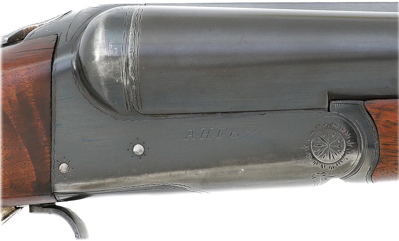

I would imagine the SP-Grade barrels could be fitted to an A-Grade frame, but they are profiled differently along the bottom.
