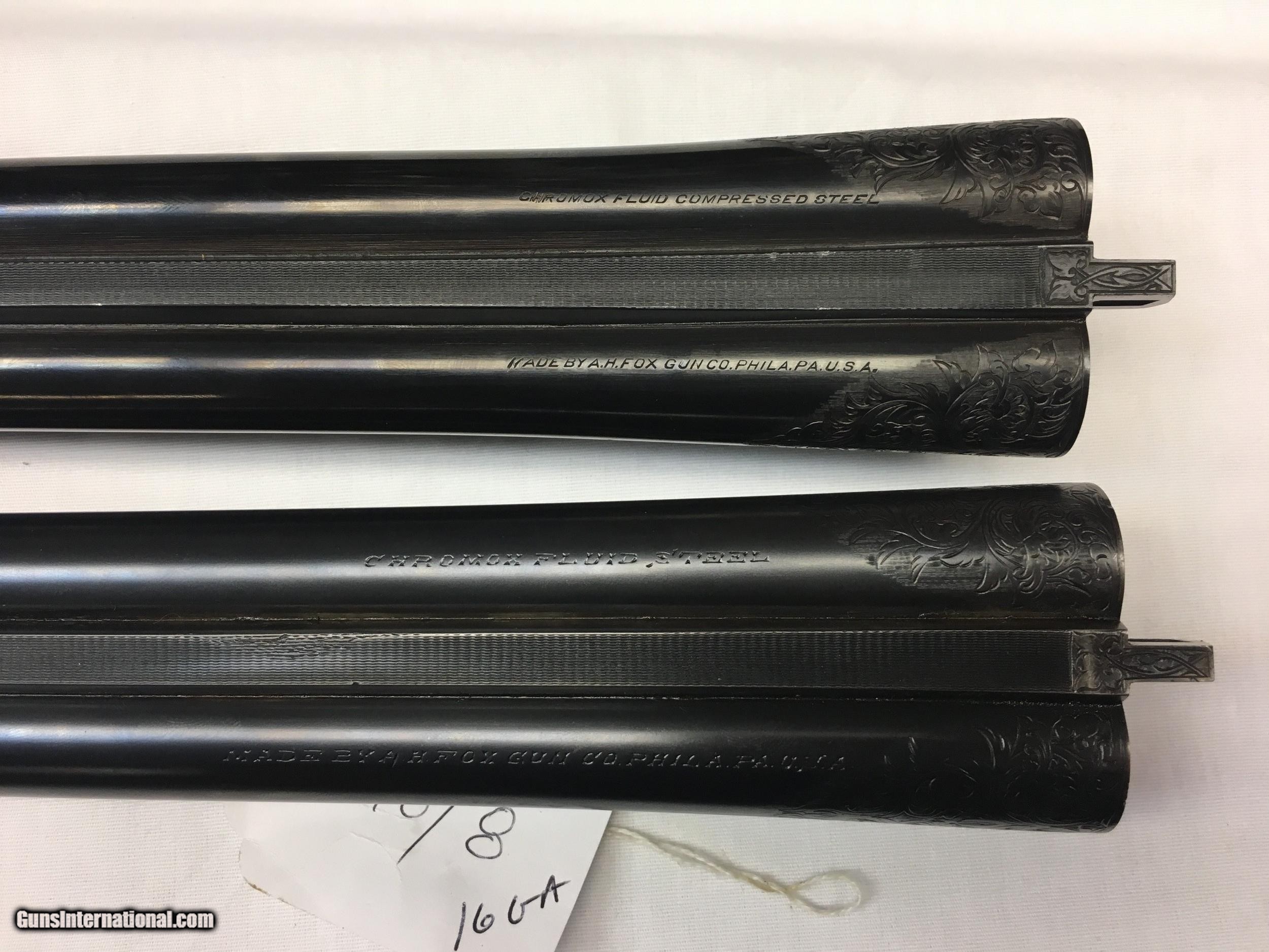

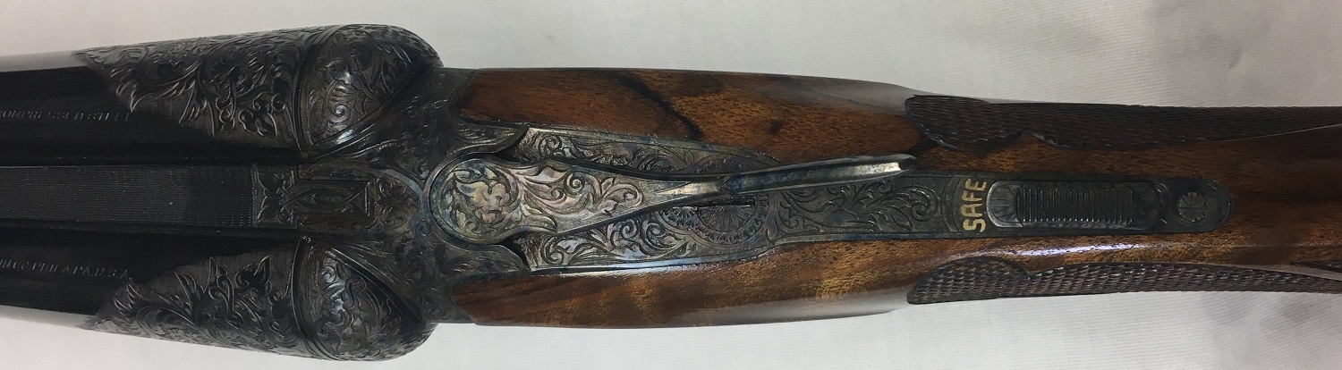

Serial number 301227 is a 16-gauge DE-Grade that went to Bob Smith Sporting Goods. It was on the market a while back, fully refurbished, with a set of 20-gauge barrels that have the roll-stamping on the top that smacks of Mitzie to me. The original 16-gauge barrels have the engraved legend on the top typical of many D- & F-grades.

Hard to see on Dave's second pic of 301227 even when expanded but the proof stamp appears to be sRp/oval instead of the typical Savage-Utica SP/oval proof stamp. Mitzie’s work ..... maybe. I've seen that sRp/oval stamp before but don't recall the particulars, and I doubt Mitzie when working on his own would be using a recognized stamp to fake a factory proof. Those other small glyphs on the barrel flats also add to the mystery. Kind of interesting to speculate but nonetheless the 301227 barrel story is likely lost to the mists of history.Researcher wrote: [snip]
