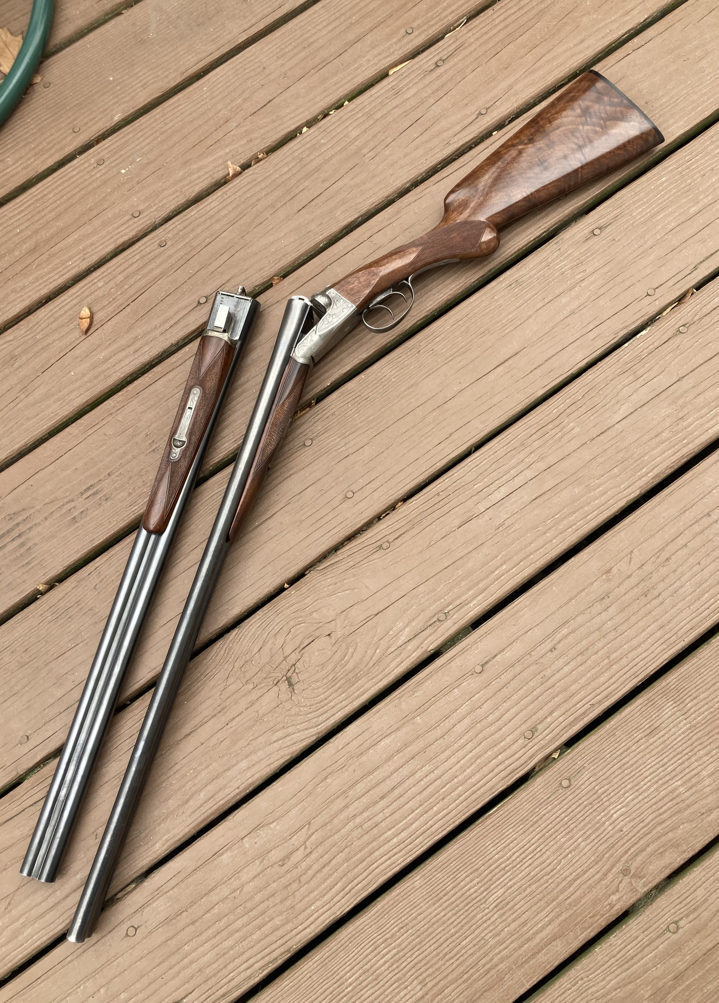

I’m certainly no expert but I’m guessing most second barrels were ordered after the original purchase. I own a 20 ga two barrel set. The original barrels are 4 wt from Philly. The second set with a matching forend and serial numbered to the original are from Savage.

That is a very nice Fox. How long are the two sets, 26 and 28 inches, or 28 and 30 inches?

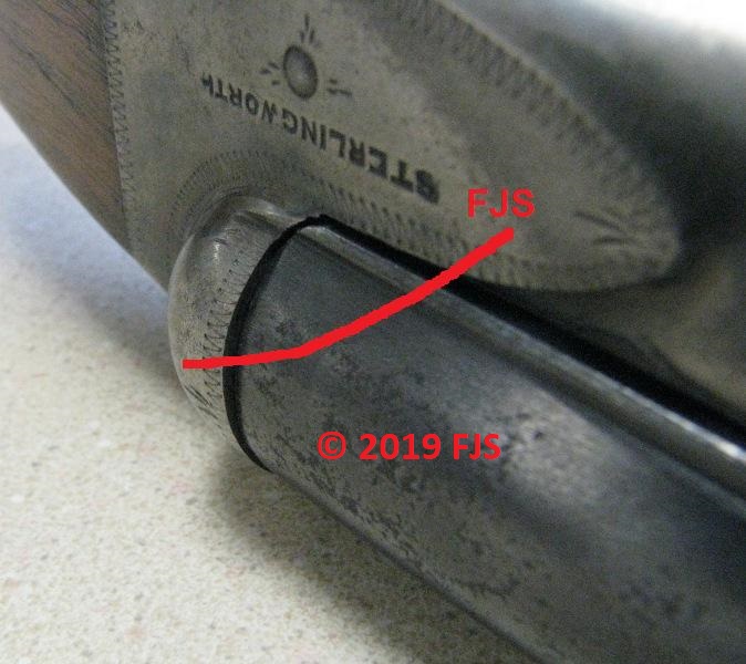

It's possible to swap/fit a 16 gauge barrel to a Fox frame made for 20 gauge, by striking off the barrel breeches to match the breech balls. On the other hand trying to swap a 20 gauge barrel onto a 16 gauge frame can be fraught with problems. Yeah I know all the hype about the Fox 20 and 16 gauge frames being the same. :lol:
20 gauge barrel on a 16 frame, anyone want to file down the breech balls to match up?

Silvers wrote:It's possible to swap/fit a 16 gauge barrel to a Fox frame made for 20 gauge, by striking off the barrel breeches to match the breech balls. On the other hand trying to swap a 20 gauge barrel onto a 16 gauge frame can be fraught with problems. Yeah I know all the hype about the Fox 20 and 16 gauge frames being the same. :lol:
Interesting......I was wondering about that. So the question would be "did the gun start life as a 16 or a 20 ga?" I suppose a serial number search would answer that question?
Would such a gun be considered altered in a way that it would reduce it's value from it's original configuration?
