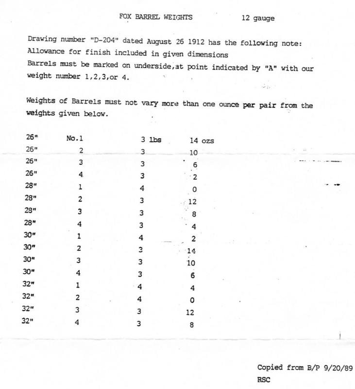

I'm recently a new member and just starting to become more acquainted with the terminology used on Fox guns. I tried to search for some answers but can't seem to find out some important facts. For right now what are the different barrel grades I hear mentioned? What are the differences between those grades, and where do I find the markings that identify the grade? I know this might require a fairly lengthy reply but I can't seem to find information on my own. Thanks in advance for any help with this question.

Thanks very much for that. What is meant when I see references to a number two or number three barrel?

Littlebear15 wrote:Thanks very much for that. What is meant when I see references to a number two or number three barrel?
That refers to the weight of the unfinished barrels.

Thanks Jason for posting. Let me reiterate your comment that the weights (mass) shown are for UNFINISHED barrel sets.
Why do I mention that? You’ll read boasts by fellas with lightweight Fox upland guns, how they had the sagacity to get one with 4-weight barrels and hence it's really a featherweight and such a joy to carry all day over hill and dale. A real feather in the cap so to speak. But in fact, many of those barrels are actually 3-weight profile. In reality 4-weight Fox barrels are infrequently seen, and often in small bores their forward walls are so thin as to be easily dented while in the field. We're not talking here about high tensile alloy steel except in some of the very latest Fox/Utica made guns.
You can typically subtract 2-4 ounces from the weights shown in the charts depending on gauge and how much steel was struck from the barrel set (during finishing) to achieve the gun's target weight.

On each of the FOX BARREL WEIGHTS sheets it states "Allowance for finish is included in given dimensions". What exactly does this mean?
