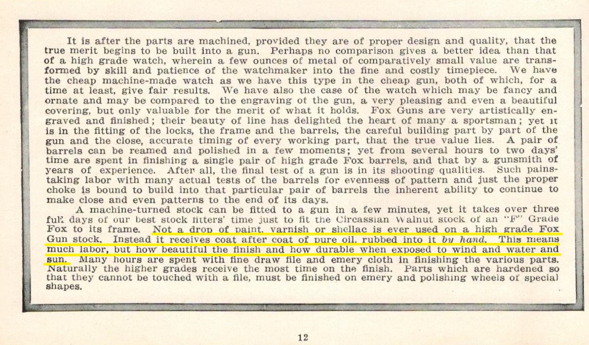

The only mention of the finish on Fox wood I've found is these sentences used in the 1923 to 1930 catalogs --
And in the 1924 to 27 catalogs where it says the HE-Grade Super-Fox stock is oil finished. While all the A.H. Fox Gun Co. catalogs from 1924 to 1929 list the Super-Fox as having an English Walnut stock, the 1923 and the 1925 Super-Fox brochures both state the stock is oil finished American Walnut.
