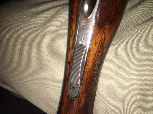

I take terrible pictures, but here are some comparison photos next to my 28" 12 Gauge. I'll try to take some more over the next few days.

Appears to me based on the pics that your 20 gauge may have been pinned with wooden dowels to most likely repair a crack in the cheeks. If that is indeed the case I'd recommend you shoot quite lite loads and stay away from 1 oz loads. Also based on the picture taken from the top showing the lever, that a screw under the lever might not be tight. Could be wrong, but worth checking before you fire the gun.

I was actually going to bring those plugs into this discussion. I have looked at those plugs with 10x magnification looking for any sign of cracking and can't see any. That doesn't mean that they aren't there but I can't see them. But that leaves the question of why they are there in the first place.

I haven't done a screw check or any disassembly on the shotgun yet. I will before i shoot it on Friday.

John, that is a nice gun and you'll have a lot of fun with it. I own a 1918 Sterlingworth 20 ga. with 26" barrels and it is a delight to shoot. Like Tom (Vaturkey), I noticed the two plugs and concluded that the stock has been repaired. Regarding your question as to whether you should use 1 oz. load, I'm betting that a few people will say "why". A lot of the members like, and recommend, using light loads. After all, we're shooting these old guns for fun. :) Enjoy your new Sterly.
