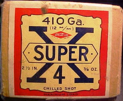

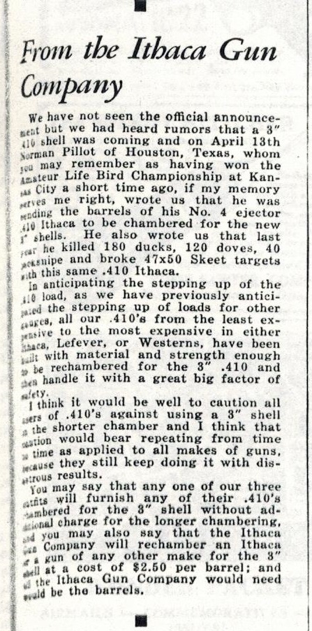

Hey guys!! All one really needs is the 3/8 ounce of shot that the 2 1/2 inch .410-bore shell carried from its 1914 introduction in North America until it got upped to the 1/2 ounce we know now, a few years after the 3-inch .410-bore shell came out.
Super-X .410 box load side.jpg (35.98 KiB) Viewed 46876 times
National Sportsman, July 1933
Norman V. Pillot won the International Flyer Championship at Kansas City in 1931.
