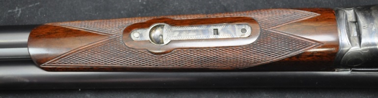

The Sterlingworth Wildfowl Grade is essentially the HE-Grade Super-Fox metal finished up in Sterlingworth finish. There appears to be two batches of Sterlingworth Wildfowl Grades. Maybe forty or so in the 1341xx serial number range. The ten that I have observed run from 134102 to 134130. Guns observed in this batch are stocked in Fox-Sterlingworth quality wood.
The second batch is the last five cards in the graded gun serial number sequence -- 35281 to 35285. While the metal of these guns is finished in Sterlingworth fashion, those observed are stocked in HE-Grade Super-Fox wood.

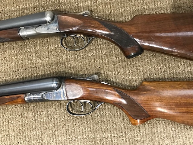

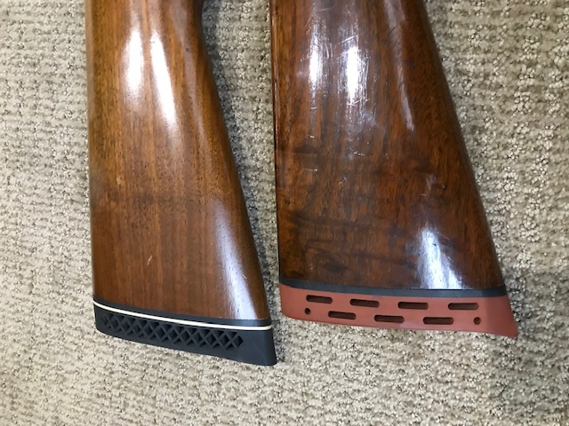

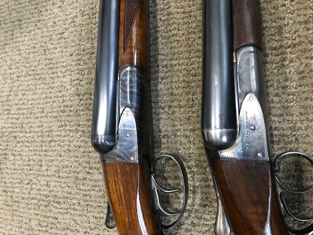

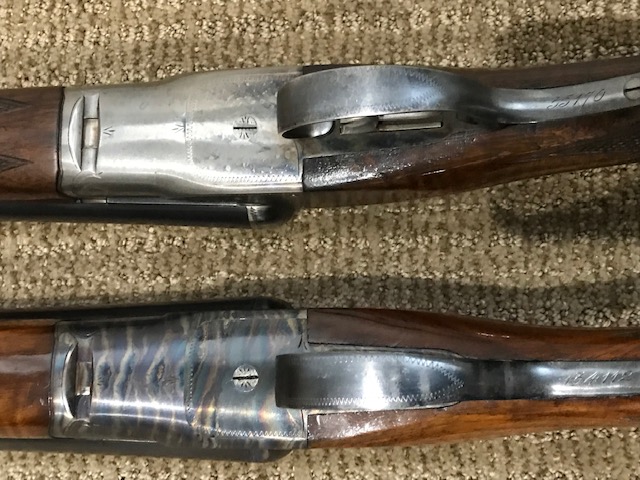

Here are a couple of pictures of two Wildfowlers from the different Serial # batches that Dave referred to in the previous post. The first gun is Serial # 35170 and is fitted with HE wood with PG cap and Jostam Pad (as recorded in the letter). The second gun is Serial # 134112 and is a later gun fitted with Savage Sterlingworth non capped PG and a Pachmayr White Line Pad. This gun is in a block of Wildfowlers that the order cards are not available for. I have seen three of these guns including one that is a single digit off from my gun and all three have the Pachmayr White Line Pads fitted to them. Notice the Tiger Stripe coloring of the second gun consistent with the late Savage era guns. Both guns have the frame polish line of the Savage era guns directly above the "worth" portion of Sterlingworth on the frame side.
I'm sorry, but if the pad is a Pachmayr, that is from well after the last Fox price list. There are a few guns in the late cards that request a "White Line" recoil pad, but in those days that would be a Fray-Mershon or The Mershon Company Inc. The Fox-Sterlingworth Wildfowl I use to own, pictured in McIntosh's book and a couple of Headrick photo spreads, had the original butt plate.
Posts: 2292
Has thanked: 1472 times
Been thanked: 1559 times
Re: Fox Sterlingworth Heavy barrels (HE weight)
Did not mean to imply that the pad was from the factory. Just find it interesting that all three guns I’ve personally observed in that batch have black Pachmayr white line pads. I know they came post the last price list but It does make one go hmmmm!

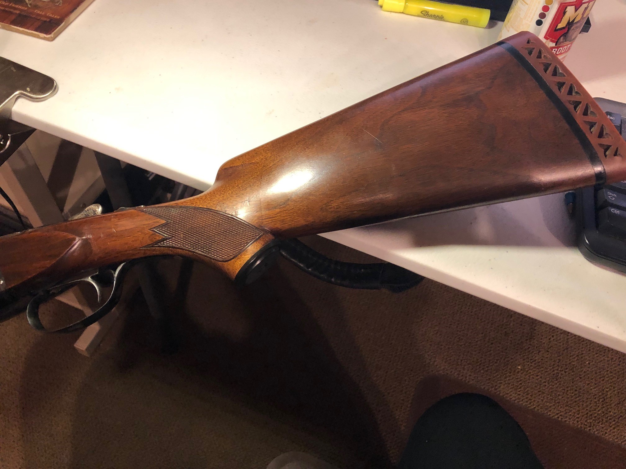

Researcher wrote:The Sterlingworth Wildfowl Grade is essentially the HE-Grade Super-Fox metal finished up in Sterlingworth finish. There appears to be two batches of Sterlingworth Wildfowl Grades. Maybe forty or so in the 1341xx serial number range. The ten that I have observed run from 134102 to 134130. Guns observed in this batch are stocked in Fox-Sterlingworth quality wood.
Dave - Apparently not all of the Wildfowls in the 1341xx range were stocked in Fox-Sterlingworth quality wood - here's a fully optioned Wildfowl, within the range you have recorded above, with a capped full-pistol grip stock and the original Hawkins pad. The Callahan letter indicates it was shipped in 1945 and says: "Of interest is the information is written on an "HE" grade card with the "HE" crossed out".

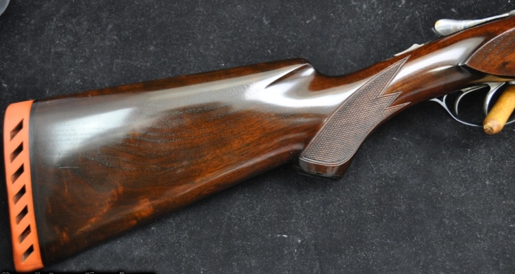

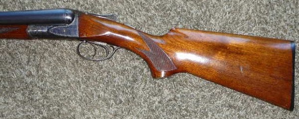

I'd like to know what type of wood is on the top gun in this ad from "The Dutchman" back in December 1978 --
