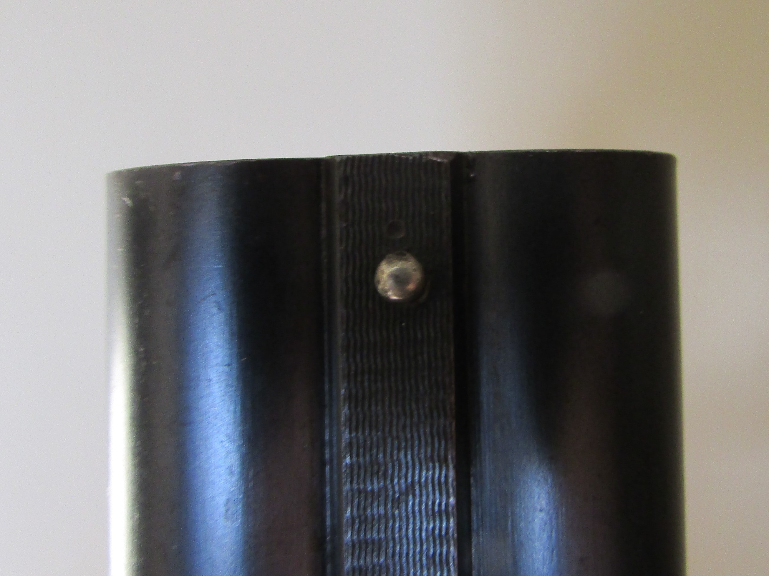

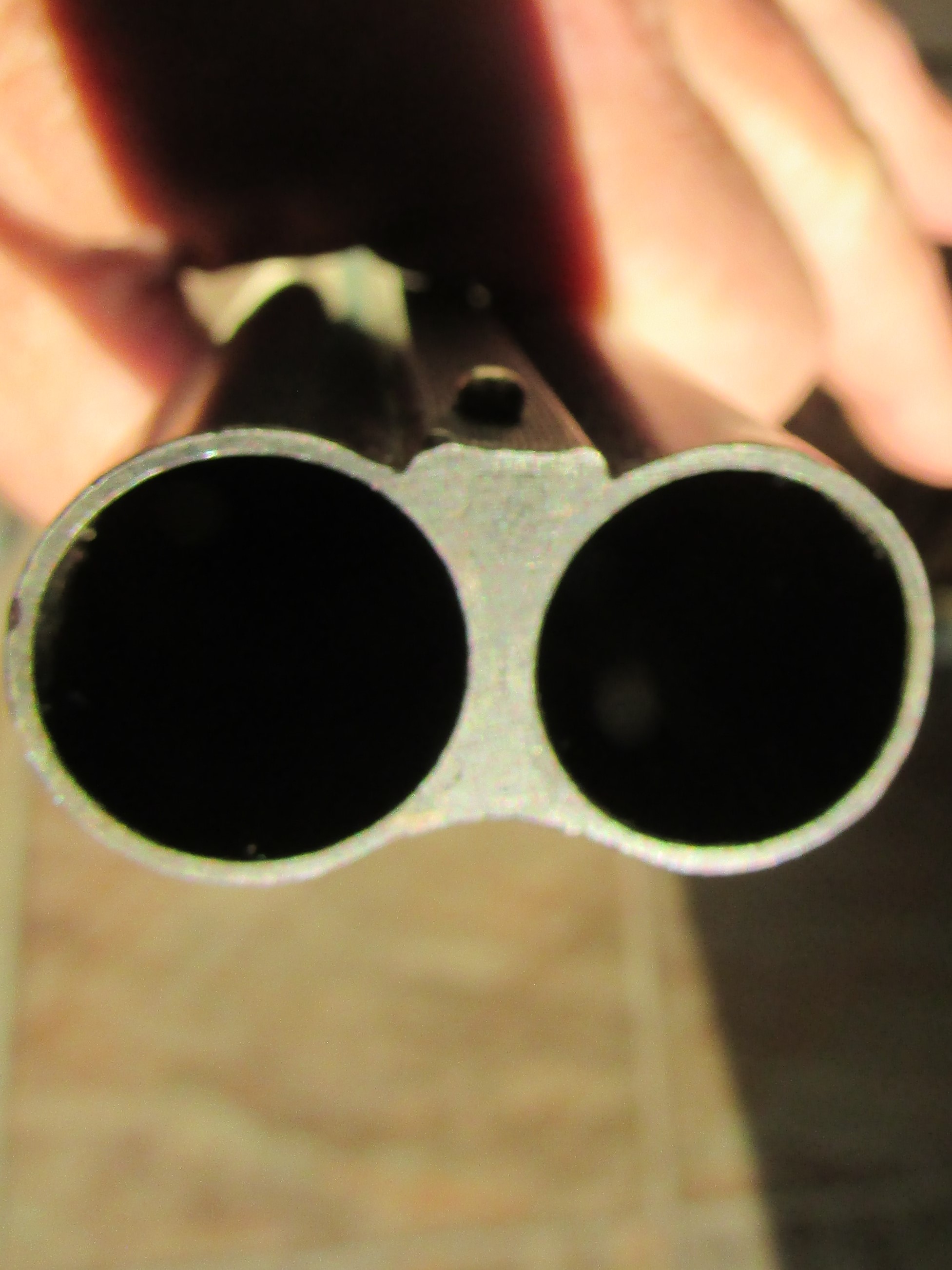

16 bore Foxes of that vintage will have nominal .659" bores (as the mean) and the taper chokes will vary somewhat in length of taper, and whether the abrupt run of the taper is leading or trailing. I'd say your Fox was likely cut from 26-inch/Mod & Full. You mentioned a metal bead and I'm curious to see if it's the regular Fox bead and also its location on the muzzle part of the rib. Thus a good macro pic would be helpful. Also while taking pics you might do a good macro of the front of the muzzles so we can see the filler pieces "keels" that are fitted between the tubes.

That doesn't look like a Fox factory bead, and the center punch mark forward of the bead looks like the gunsmith had second thoughts and moved it a bit aft. Also, the factory wouldn't have filled the spaces between the tubes with solder.
