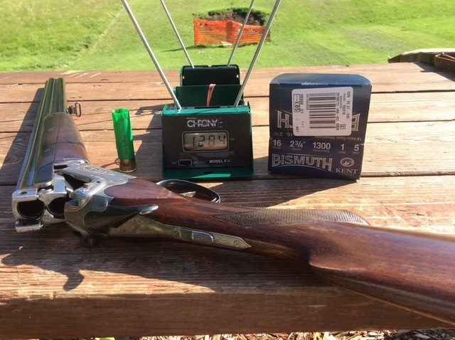

FYI- Kent's 16ga are mismarked. Dave Erickson posted his chrono results on the 16ga forum. They run approximately 1300 fps.
In case you're not familiar with Bismuth, Phil, it's roughly 10% less dense than lead. You might want to go one size larger than your normal size lead pellet to compensate.

My reference to mismarked was the velocity listed on Cabela's website. It wasn't intended as a slur against Kent. I just wanted Phil to be aware of the difference in case it might affect his decision. As he pointed out, Kent lists them as 1300fps on their company's website. I can't speak as to why yours are marked 1200fps. It seems as though the boxes are now marked as being 1300fps.
Pic of Dave's setup.

The picture shows a relatively inexpensive screen-type chronograph with a short distance between the screens, and we don’t know how far that chrono was placed in front of the muzzle. Measurement error can also be induced because the screens will determine velocity based on the first trigger event which could be a leading/stray pellet or even the muzzle flash. Such setups often show much higher shotshell velocities than the true center of mass measurement.
Industry shotshell makers generally use induction coils to measure velocity in terms of center of mass. The SAAMI distances are exactly 18” from the muzzle and exactly 36” between the coils. Note that even 35" or 37" will result in an erroneous velocity reading by -/+ about 25 fps because the computer uses 36" in its calculation. That’s because the coils (even at 36”) aren’t really that far apart. Also confusing things for shooters is that some few shotshell makers have been known to "correct" those readings to muzzle velocity which would of course be higher. Speed sells.
Presumably, any commercial 16-gauge shotshell sold in the US today will develop no more than the SAAMI 11,500 psi max average pressure spec. Standard loadings for 16-gauge are: 2-1/2 dram-equivalent (DE) and 1 ounce @ 1165 fps, 2-3/4 DE and 1 ounce at 1220 fps, and 3-1/4 DE and 1-1/8 ounce at 1295 fps. All of those velocities are averages for the center of shot charge mass and as measured with inductive coils and the SAAMI protocol.
Net, if in fact the current Kent Bismuth 16-gauge loading is 1 ounce at 1300 fps as measured per the SAAMI convention, that would equate to a 3-1/8 DE load, still not quite the recoil of the Winchester Super Speed "high brass" loading cited here earlier. I never heard anyone complain about that load for pheasants or ducks when I was a kid. :)

Silvers, did you notice his box of Bismuth in the pic shows them as 1300fps loads? I'd have to pull up the old thread again to see if he mentioned his methodology for testing. I can provide a link if interested.
