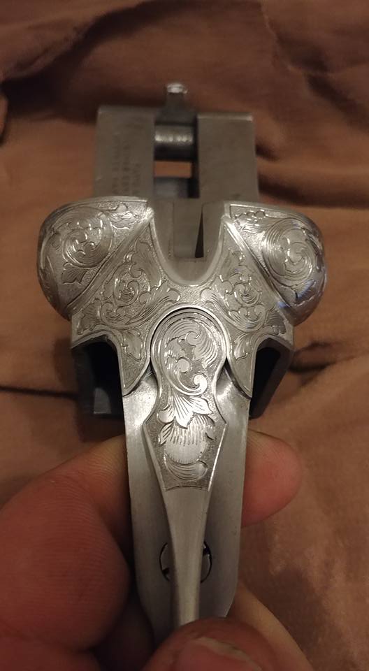

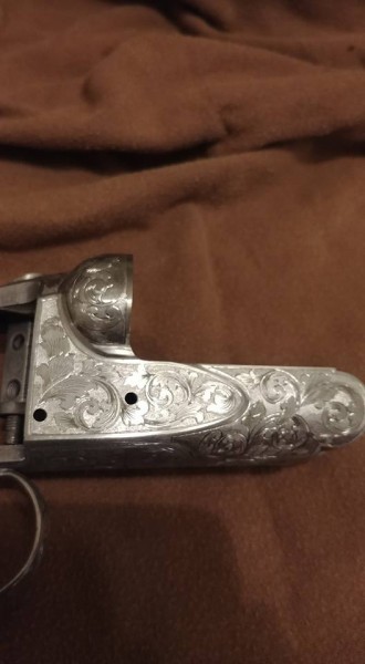

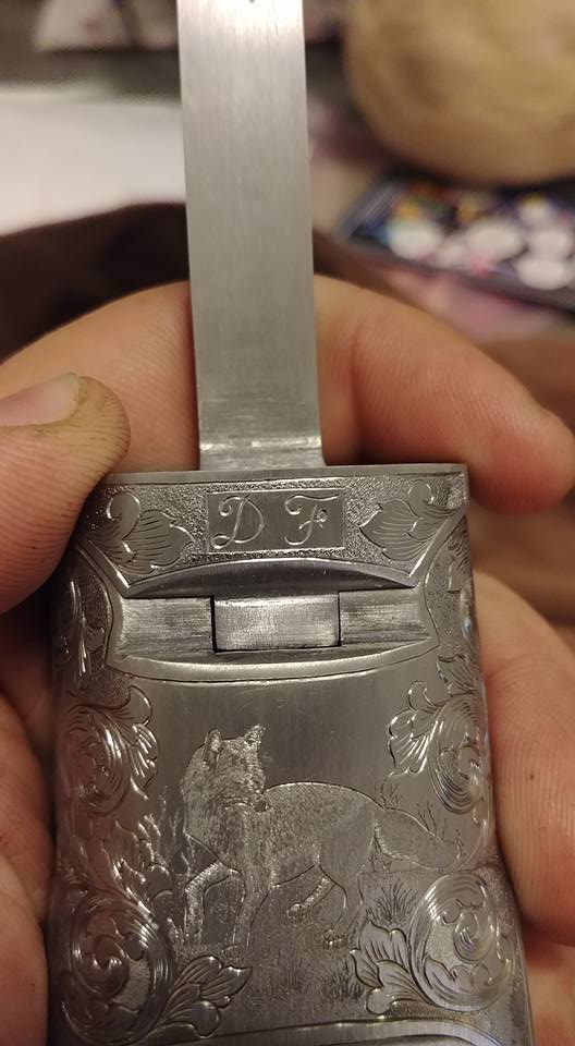

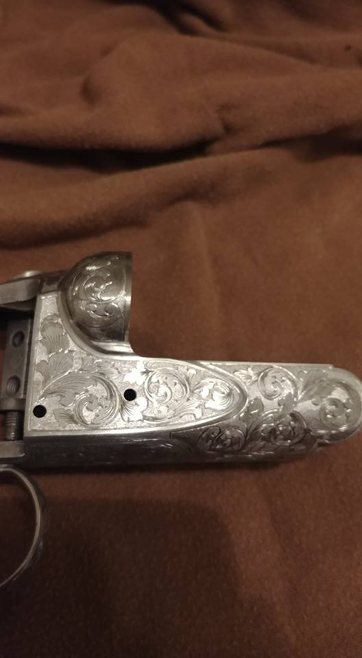

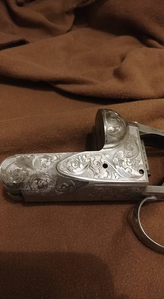

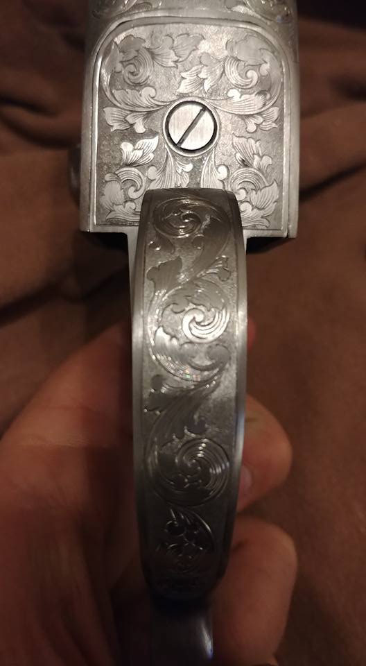

I got my gun back from the engraver a couple of days ago and just sent it out to Classic Guns to be color case hardened. Here's a few pictures:

Thanks for posting. Following this to see what the in product is. Agree with others in that this is a wonderful learning experience.
