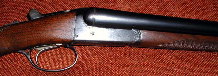

Then by about 1935, they added a bit of border engraving and little decorative flourishes --

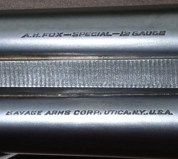

Early on the SP-/SPE-Grades had the right barrel marked A.H. FOX -- SPECIAL - xx GAUGE --

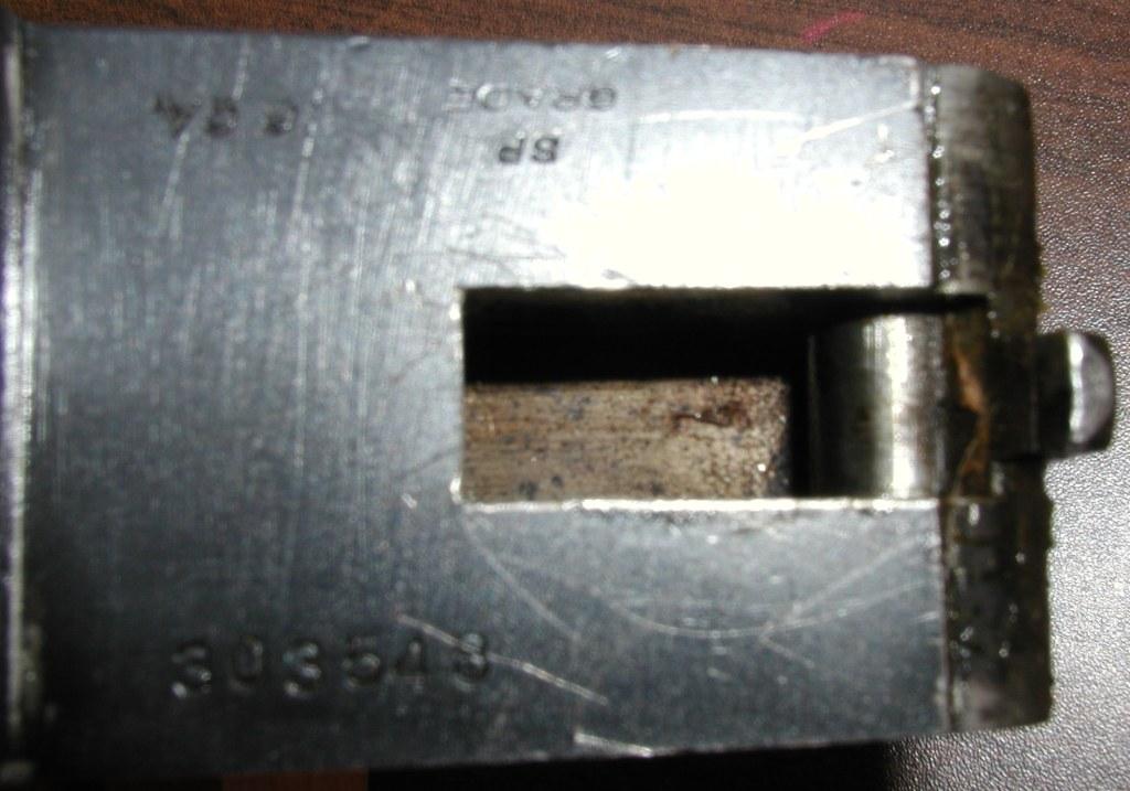

This gun also has the serial number and 16 GA on the watertable --
This gun a few hundred later has SP GRADE also stamped on the watertable --
