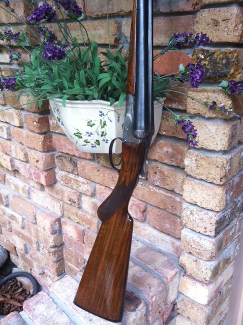

- Attachments
- Fox2.JPG (161.35 KiB) Viewed 7684 times

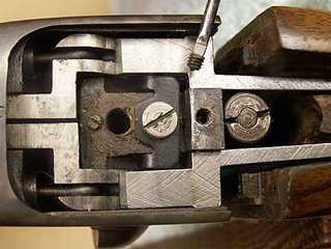

I found the the picture below on this site ... I think the wooden tab on the left side of the stock is broken on my Fox, as the stock will separate from the gun on the left side only.

Re: My First Post & Fox
David, the Fox design doesn't have tabs to keep the wood captive inside the frame. Essentially the stock head is held together by a "web" of wood inside the inletting, and by some slight compression of wood due to its fit against the frame. The inside web is easily cracked by a lateral impact such as falling with the gun held sideways. Fox is not alone in that regard. Fox reinforced some but not all stock heads with a corrugated staple aka corrugated nail, and you can search and find some threads with pictures of same. But with all that said the A H Fox design is pretty solid and I've fired one of mine almost 15,000 rounds with ZERO cracks, problems, etc. That gun doesn't have the staple feature.
Without looking at your gun I can't say for sure if the web is cracked but from your description it probably is. I've seen stocks with these cracks glued and usually they don't hold up. I work on own guns ONLY and have seen it all. If the web is intact but cracked, the fix I'd recommend is to have a competent Fox man glue it back together and bridge over the crack with a heavy metal pin that's also acraglassed in place. But if the web is split out, about the only fix is to dovetail/glue/bridge a new piece of walnut in place. This can be done without being visable from the outside as with a crossbolt. I use a vertical mill for these wood web repairs but I suppose a very steady hand can do a passable job with a die grinder.
I know you asked who can do an evaluation and good repair. Most competent Foxsmiths have way more work offered to them than they can handle. One I spoke with a week ago and told me he has an ~ one year queue on most work. And serious Fox nuts who are getting work done generally keep their good smiths' names confidential and only share with close friends, for fear their future work will be delayed by addition of a new customer(s). I'm not saying that's right, only that's the way it is. I'm sorry I can't offer much more than this. Silvers

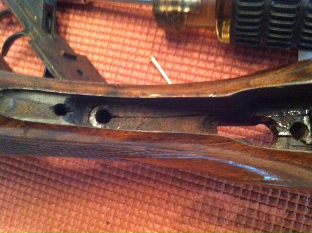

On a different computer with my pic files this morning.
First pic shows the front end of the web that holds the stock head together. This Fox has the reinforcing staple and its web is intact. But what I call the "draw pyramid" that pushes the stock tight against the gun frame is broken out (left center of pic). Gun was apart to replace that pyramid.
I've seen most everything on Foxes. Here's a top view of web on another stock, that someone "repaired" with what looks to be old time plastic wood.

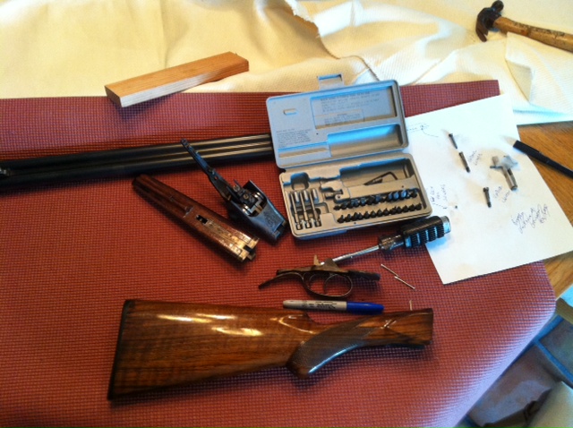

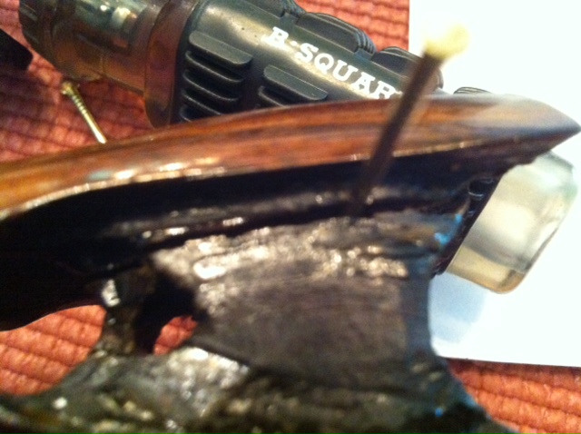

Guys,
I really appreciate all of the help ... I was looking at the gun this morning and decided to take it apart in order to determine exactly what is damaged/broken on the stock. Picked up a gunsmith kit at the local gun shop for $30 and breaking the gun down was a breeze. I used the disassembly instruction on this site
. Here are a few pictures of the pieces parts and the broken stock.
I'm not sure how a professional would go about fixing the gun, but I would think that the best "structural" fix would utilize a pin through the web ... Adding some checkering would hide the pin. I plan to contact a number of stock repair experts and get their initial opinion on the best approach based on detailed pictures of the stock. Once I have selected a shop for the repair, I'll ship the stock for a more thorough inspection in order to give the shop an opportunity to see the damage and give me a solid price for the repairs. Once we agree on the repair approach and price, I'll ship the components of the gun so they can be cleaned up and reassembled.
I will say this, for a 76 year old gun, it's in fantastic condition. When I purchased the gun last week, I was aware that there was an issue with the stock, but I only paid $1200 for the gun.
Thanks again for all of your comments. I will keep you informed on the progress of the repair and I hope to get it fixed asap ... I'm chomping at the bit to shoot this beautiful gun!

- This is a picture from the bottom of the stock
- broken stock bottom view.JPG (141.59 KiB) Viewed 7344 times
- This is a picture from top of stock ... I opened crack and inserted small nail
- broken stock top view.JPG (113.22 KiB) Viewed 7344 times
- Pieces parts
- Disassembled fox.JPG (138.16 KiB) Viewed 7344 times
