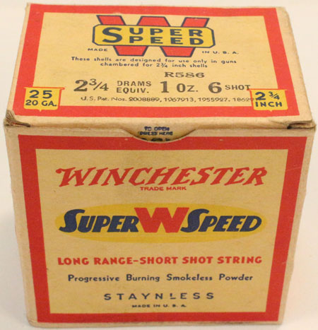

With the North American Nimrod's general "more is better" attitude these old guns probably saw plenty of Western Super-X, Peters High Velocity, Remington Nitro Express, etc. loads from the 1920s to the late 1980s. I wonder if our manufacturers began regulating their guns for those loads?

While most of our ammunition manufacturers put up their one ounce 20-gauge high velocity loads in a 2 3/4 inch or longer case, Winchester offered their REPEATER Speed Loads, later Super-Speed, in both 2 1/2 inch and 2 3/4 inch cases.
Super-Speed 2 1-2 inch 20-gauge.jpg (81.56 KiB) Viewed 8842 times
Super-Speed 2 3-4 inch 20-gauge.jpg (82.44 KiB) Viewed 8842 times
