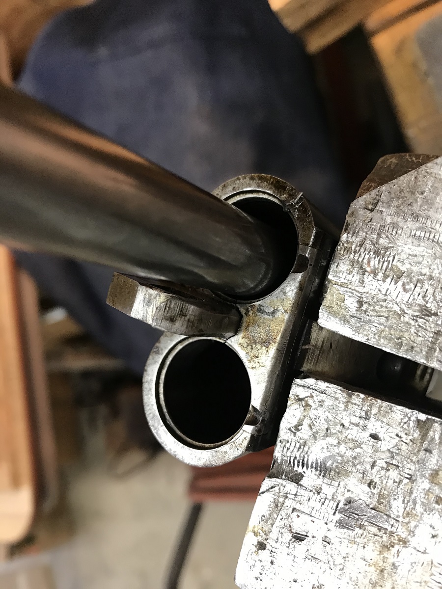

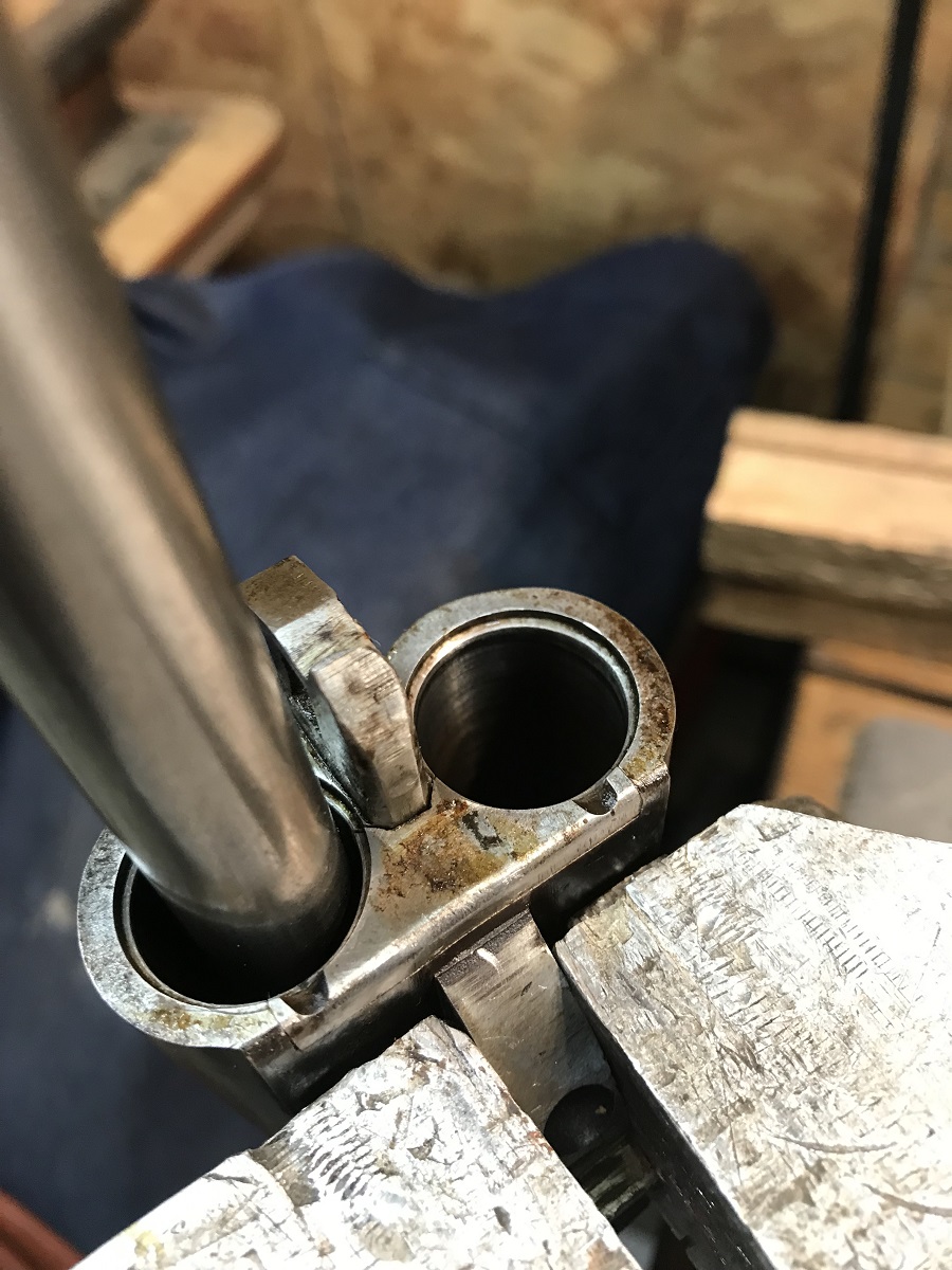

A grouse hunting friend just snagged a nice 16 bore L C Smith Ideal Grade but she was choked 26 and 29 points (Full and a bit Fuller). That won't do for PA birds. He came by this morning and we opened them to 6 and 16 points, about IC and Mod.
My choking reamer is inserted and driven (turned) from the breech end, and uses two bronze pilot bushings that are exactly sized to the bore and held captive at about 6" and 10" behind the front of the reamer. Right now I have six sets of bushings for 16-gauge and keep finding new bore sizes..
You'll see the reamer drive rod in each pic, note how it looks relative to the center of that chamber. My friend noticed that and got kind of edgy but those two pilots insure the choke is re-cut dead nuts on center of each bore out toward its muzzle. Kind of interesting to see how the centers of the chambers don't align with the bores at the chokes due to the “swamp” of the tubes. frank

Thank you for the illustration, I've wondered how barrels were joined as it seems they would be brought closer to parallel around 8" from the muzzles or so, then the exteriors filed for external straightness of line. Either that or the chokes would be cut so as to reduce the angle of barrel convergence which would show itself at the muzzles.

Matt, this was a later LC Smith and they were typically furnished with a taper - > parallel choke profile; hence I did this one with a parallel reamer to match with the factory work. After reaming I lightly hone just the parallel run out to the muzzle and then faux age-color it. On the other hand Fox chokes as furnished are full-tapered out to the muzzles but with varying length depending on the constriction, and I wouldn't have used a parallel-cut reamer if this had been a Fox. Parallel choke out to the muzzle (while that works) is generally a dead giveaway that a Fox choke had been opened post-factory and for many Foxers that's a key consideration. .
