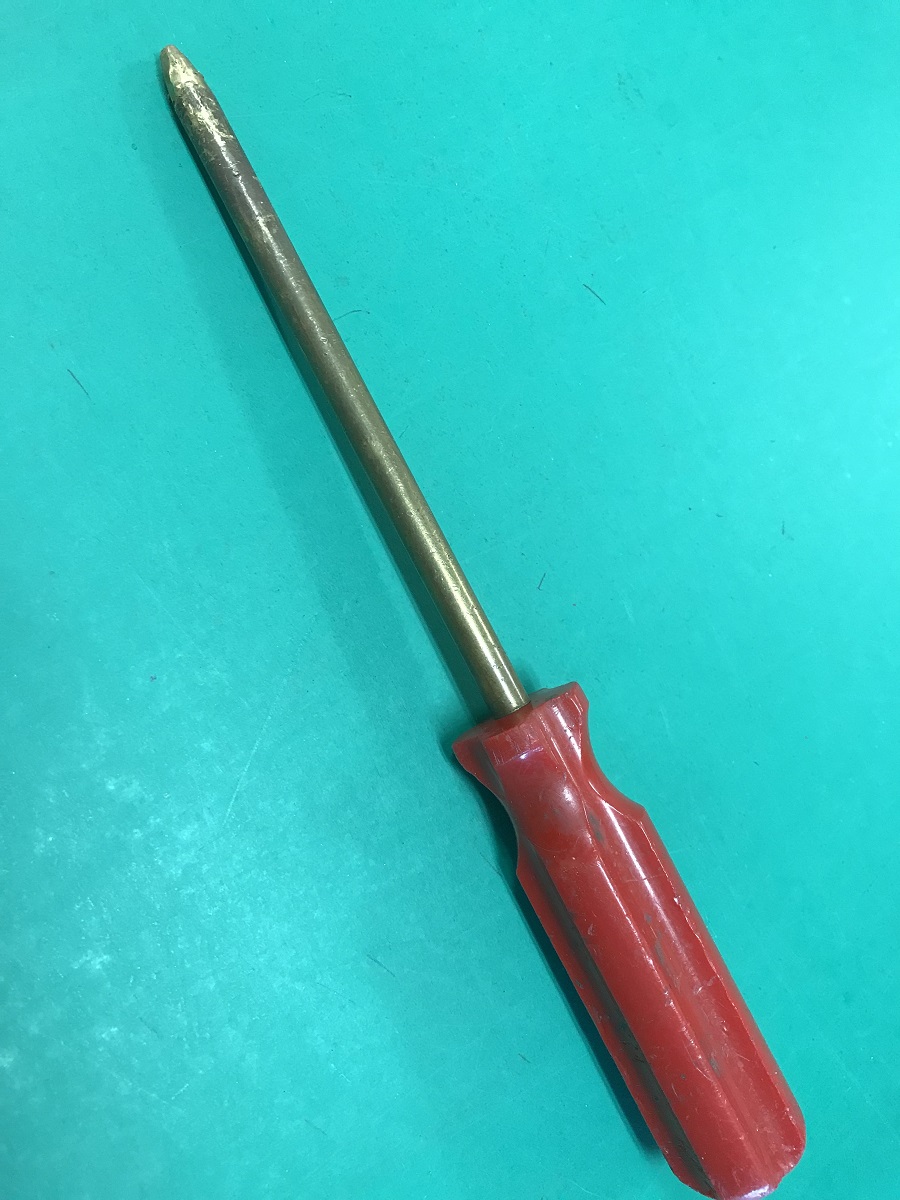

Your "tool" setup sounds interesting and I'd like to see a pic. Actually I've long used a hand tool for replacing the hammers; it's a blasting cap/dynamite punch from my youth. Just a 5/16" diameter brass rod with a push handle and the tip has a somewhat blunt point. I am attaching a pic. A similar one could be easily made with a piece of brass rod and a file handle. In use the frame is clamped upside down in a padded vice and the brass tip presses against the notch area of the hammer, pushed in and a slave pin is used to secure the hammer, later replaced with the regular hammer pin. Easy as pie once you've done a few. :)
