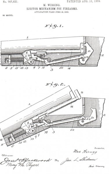

Previous to this gun, the 84 Philadelphia Arms Co. guns (or parts thereof) that I've recorded have serial numbers from 59 to 1846 and are all extractor guns. The one ejector gun that has surfaced has a serial number in the 26xx range, and its ejectors certainly aren't of the Max Wirsing design from Patent No. 767,621 that was assigned to Philadelphia Arms Co. Neither of the known Philadelphia Arms Co. catalogs, 1904 and 1905, mention or price ejectors, but the order form in the 1905 catalog has the line "Ejector or Non-ejector__________________________________________".

Patent No. 767,621
Patent No. 767,621
