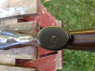

Looking at your third pic, the break lever appears to be a little too far right which likely indicates someone installed a new locking bolt but without properly fitting it. You might want to get a good Foxsmith to look at that.

Silvers, Thank you for your reply, and boy I hope you are wrong. Unfortunately for me you are probably not. Who would be a good fox smith? I live in the greater saint louis area. One reason I bought the shotgun without holding it was that pic....I really do not want to learn the hard way on my first fox. I will say that in my recent internet google picture research LOL, I have seen photos of top levers in the same position on fox guns, anyway live and learn I guess. Is there anyway to tell myself that the bolt has been replaced without taking it to a smith or not? Obviously any repair would need to be done at a smith.

Posted: Mon May 28, 2018 4:39 pm
by Silvers
When properly fitted the very end of the break lever will be slightly right of centerline of the top tang. Farther right than that often indicates a replacement bolt/improperly fitted, maybe one of the factory reject bolts on the market, or possibly that someone has jimmied up the bolt camming slot in the barrel extension to get the lever farther right. Whatever, then when firing heavy loads the barrels will often pop open because the camming contact isn't proper. I do all my own mechanical work on Foxes but can recommend Brian Dudley (NY) and Dan Rossiter (PA) to inspect your gun once you get it and can discuss with one or the other. I see and talk with both of them at SxS shows and shoots. You can look up their contact information by using the search function (upper right hand corner). But with that said there are plenty of gents here who can step up to get you contact info for Brian or Dan, or alternately to recommend a gunsmith they've used for similar lockup work.
