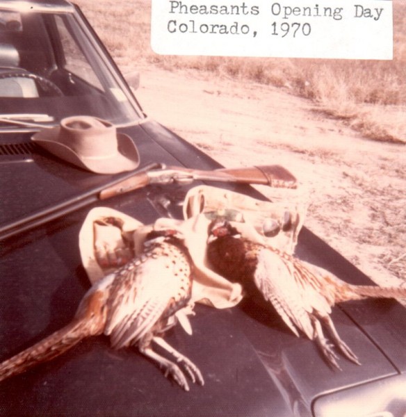

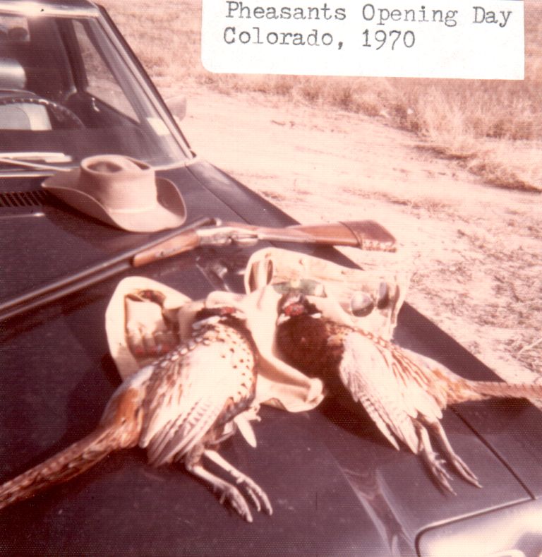

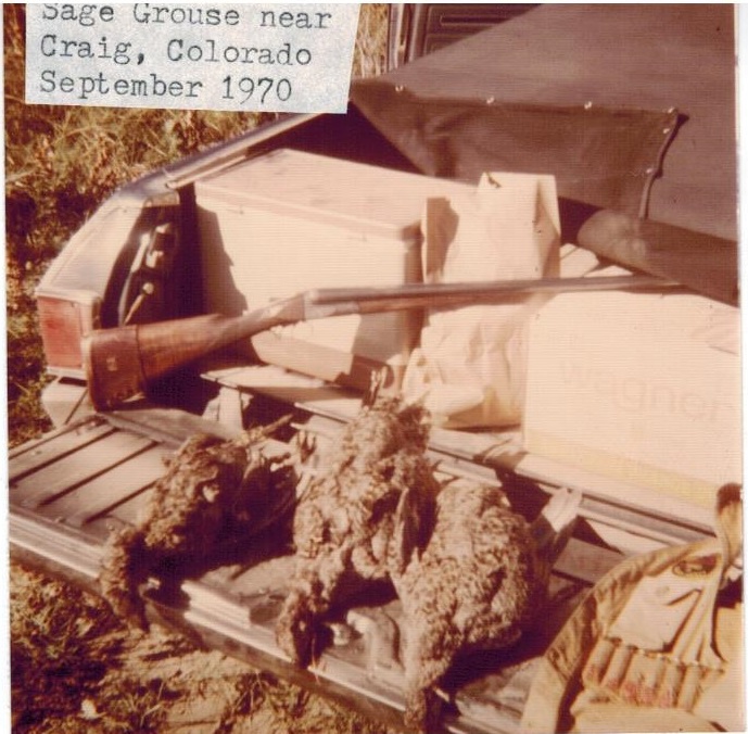

"Meat-in-the-Pot" (12-gauge A-Grade 28-inch Krupp 3-weight barrels with a straight grip) left North 18th Street and Windrim Avenue in 1914 choked improved modified in both barrels. I got her in the summer of 1966, almost immediately had the right barrel opened to improved cylinder and have never regretted it one bit. I was going to school in Colorado in 1970 and MITP had lots of fun there --
September 1970 near Craig, Colorado
Opening Day, Colorado, 1970

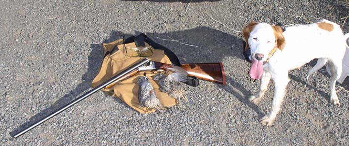

Similarly my favorite 20-gauge Ansley H. Fox for hunting is a 1913 vintage 28-inch barrel A-Grade, I've had for 25 years, that left the factory full and full, but an old Annapolis, Maryland, Quail hunter had opened to .004" and .016". It gets out and about much more often then my 20-gauges with .031" in both barrels or another with .027" and .032".
Unless it is a near mint condition "collectors item" I'm in favor of making the gun useful for what you want to do.
