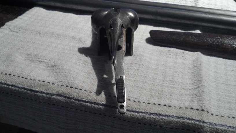

I recently had to take the stock off my shotgun because the pin holding the safety assembly disappeared. Upon replacing the pin and reassembling the gun the barrels are not locking correctly. The safety, triggers and barrel leaver all jam once the gun is cocked. Even without the sears, triggers and safety the barrels still do not lock in correctly, but nothing that I removed or adjusted relate to the locking mechanism as far as I can tell.
Anyone have any ideas on what might cause this?

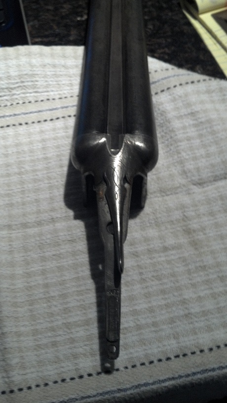

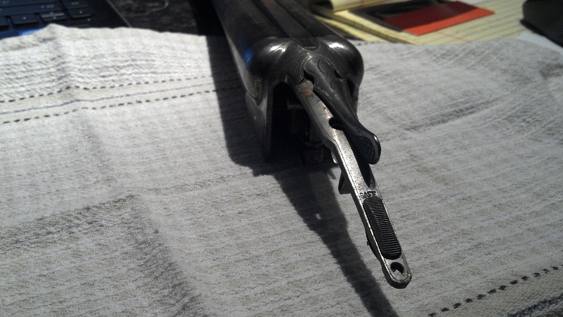

I do have the spring and the plug. the Barrel will not lock beyond the picutre with or with out the spring. In pics, you can see that the locking lever is stopping a few degrees short of centered. That happenes with or without any of the other equipment installed. For those pictures I held the lever off to the side and closed the barrel and the lever cannot close all the way.

With the top lever trip and spring installed ,does the top lever remain to right when you open the gun? if not top lever trip may not be installed correctly in rotary bolt. Bobby

hmm, that is a puzzler, assuming the above piece is in the proper orientation,
the lever not centerring isnt normally an issue, its being a little to the right is generlly preffered.

Is the barrel set closing all the way (the barrel extension should be flush with the top of the receiver). If it's not closing completely make sure there is nothing under the extractor keeping it from seating completely. If that is not the problem something must be binding in the lockup.

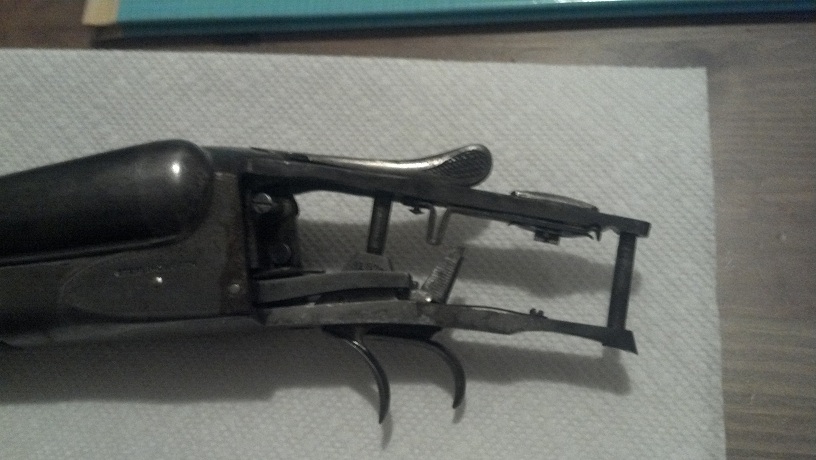

I figured it out, the triggers locking up were unrelated to the barrels at all, I put everthing back together without the stock and the triggers and saftey functioned perfectly. I had to releve the stock a little to allow the saftey to move and everything is up and running. Thanks for all the suggestions everyone but, it was good old operator error (as usual).
