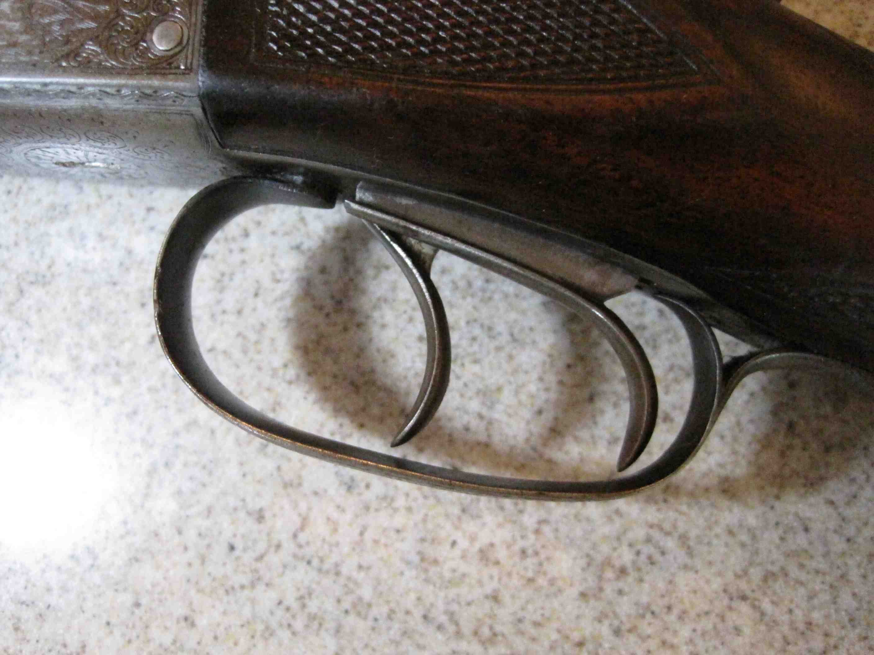

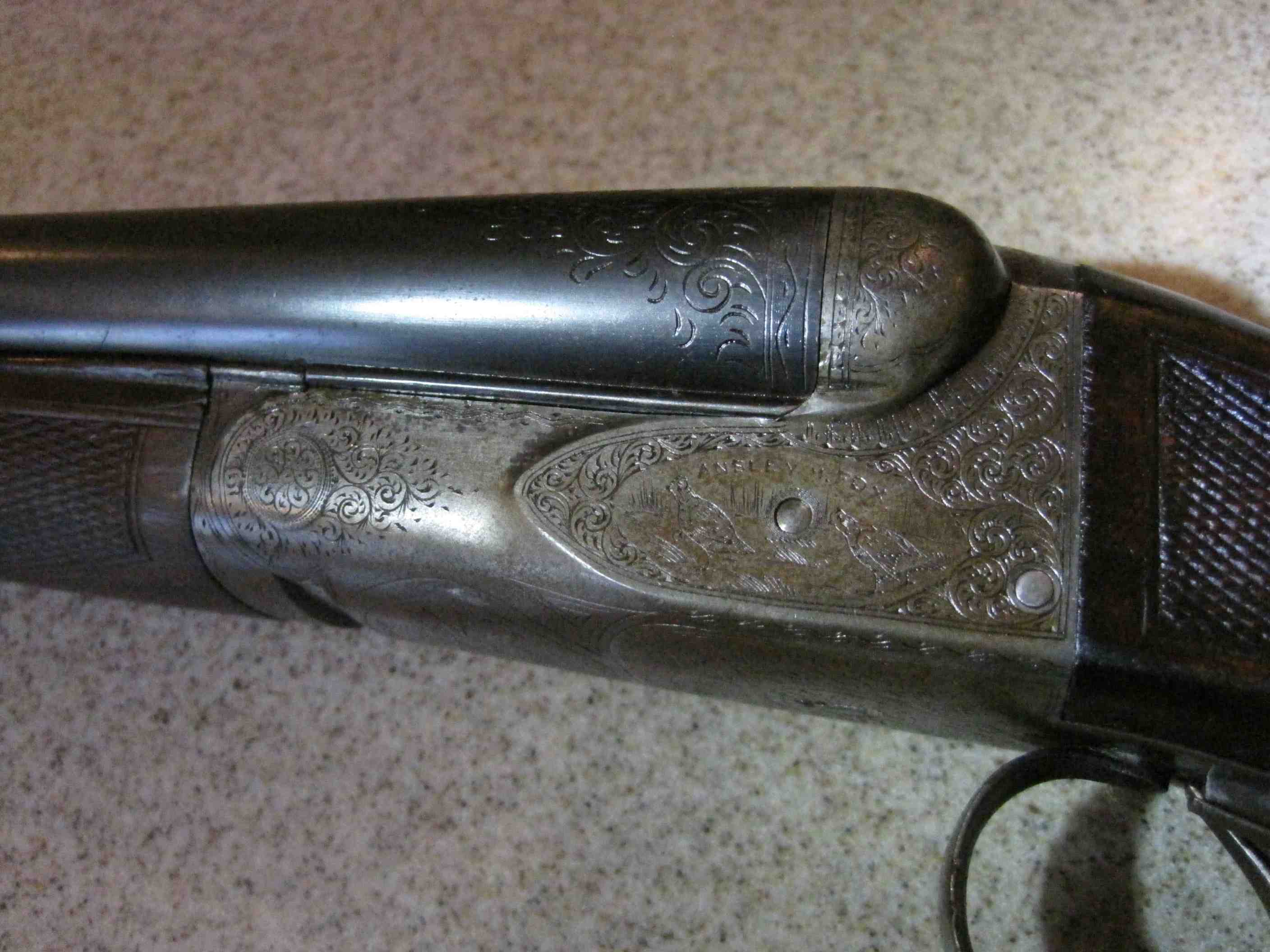

The serial number is 2001xx. It seems like I can only post about 3 pictures per replay so I'll send a couple of replies with pictures. I'll start with some of the gun and then I also have 2 tags that were on the gun when delivered so I'll send images of them too. Sorry if I'm going overboard posting too many pics.

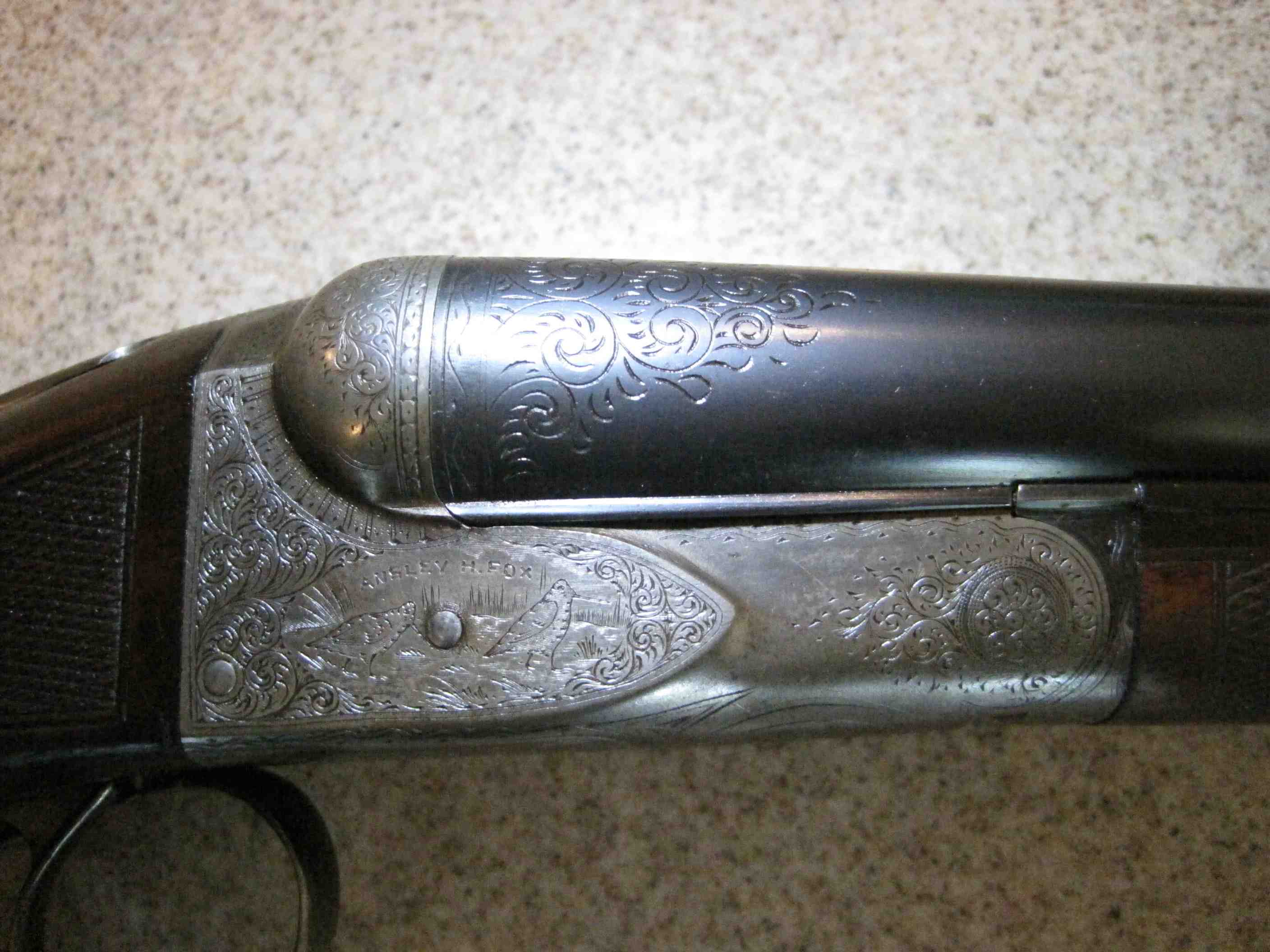

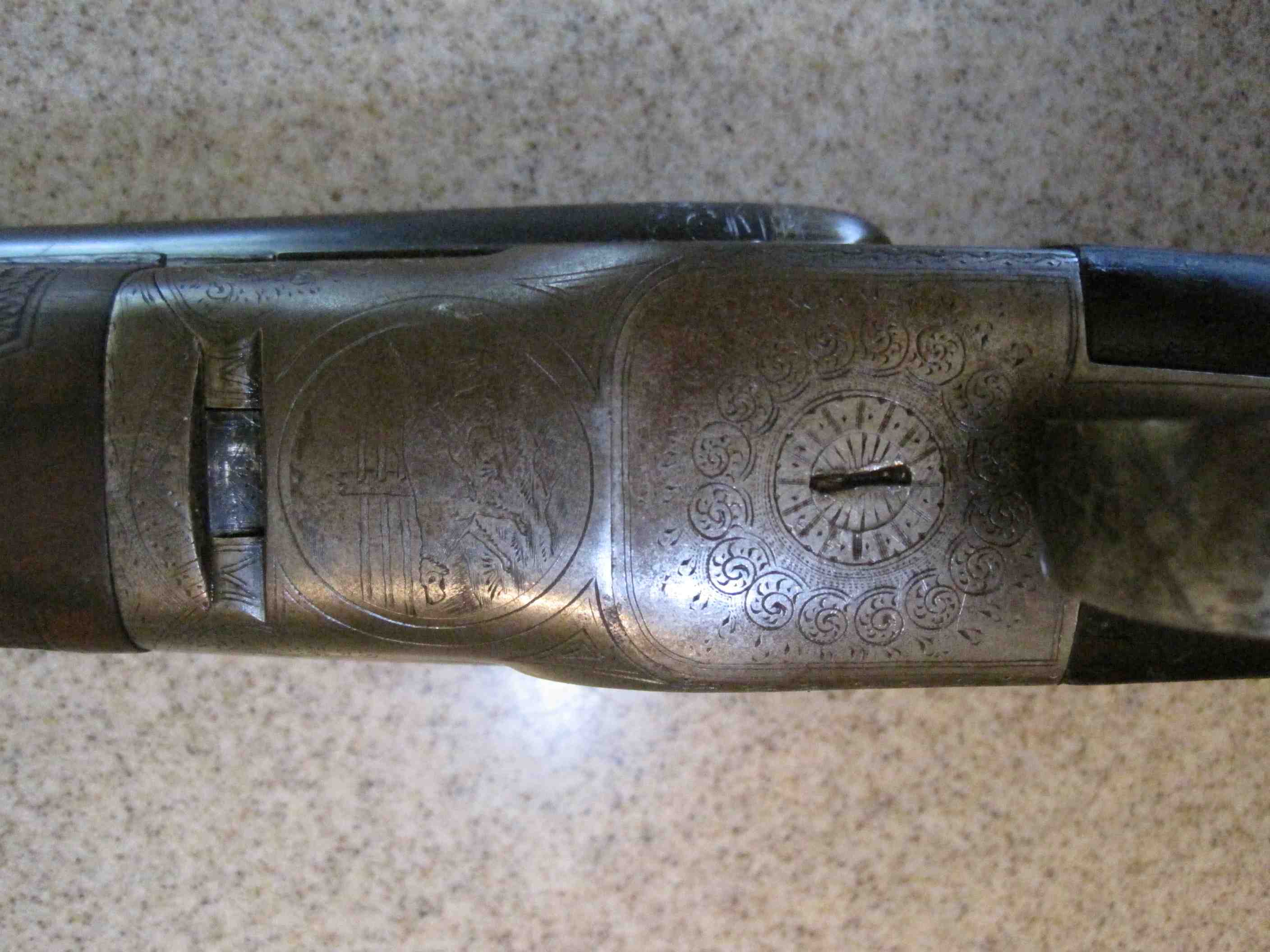

Here are 3 more.

WOW thanks for taking the time to post those. I love the detail in your photos. Making photos around 800 pixels would make it easier to get more per post.
