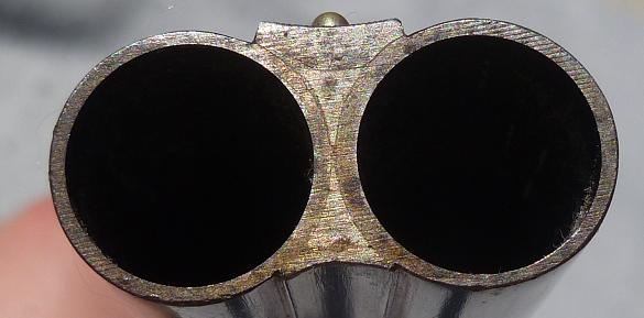

Did Fox sterlingworth barrels come from the factory with muzzles left bright or were they blued?
Re: Are factory Fox sterlingworth muzzles blued?
Posted: Wed Jan 28, 2026 9:53 am
by Researcher
Bright.

Ok, great info, i was worried it was an indication a barrel was cut.

On the longer barrel guns the tubes normally are touching or very nearly touching at the muzzle. A 30-inch 20-gauge --
252318 06 Muzzles.png (198.11 KiB) Viewed 10188 times
The muzzles of four guns that letter as 26-inch showing a bit of a gap --

Good info, and I appreciate the pictures for comparison, I had been looking for an image like that so I could get an idea of what an uncut muzzle looks like.
