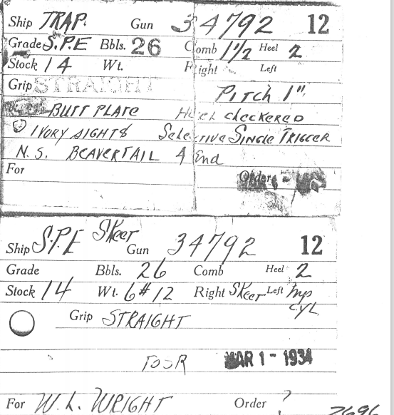

by Sporrns
Here are 2 cards for the same SN gun; it appears as though Mr, Wright, as Savage executive at the time, couldn't make up his mind as the gun was being built if he wanted a skeet or trap version. The gun wound up being built in skeet configuration with all specs on the "TRAP" card fulfilled but in Skeet configuration. Kevin
