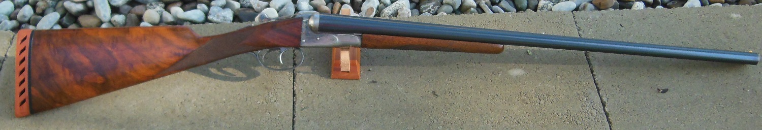

My 16-gauge, 26-inch, S&UGG, 374152, shipped in May 1938 --

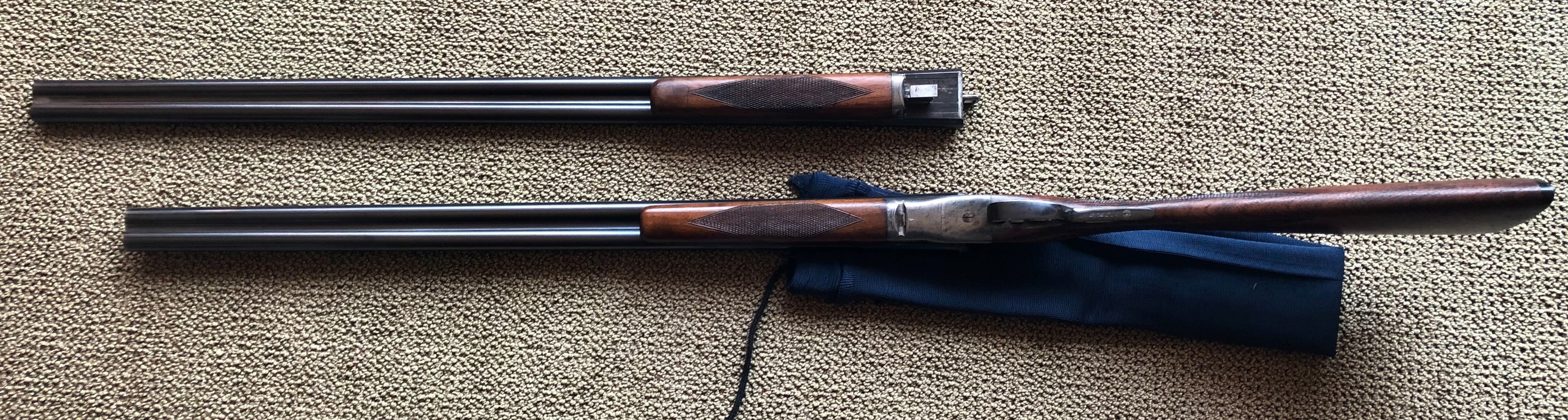

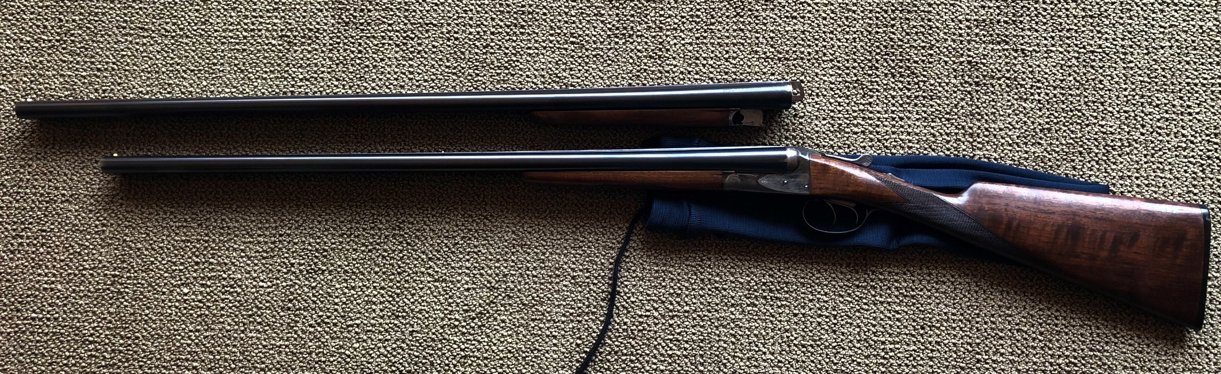

Keep in mind that Fox (Philly and Utica) would make any length of barrels upon request from potential buyers.
Here is a 16ga SW S&U with a matched set of 28" and 32" barrels and forearms.
The gun shipped with the 28" barrels and went back to Savage later for the 32" barrels.
It's a nice combo for upland birds (grouse, quail, pheasants) and migratory birds (dove, ducks).

Foxnut, the 16-gauge Fox-Sterlingworth Skeet & Upland Game Gun you pictured is the mate to mine 374152 --
