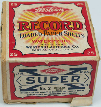

Checking a September 1978 Winchester Western Ball Powder Loading Guide, the WW compression formed 3-inch 12-gauge hull with 1295 fps 1 3/8-ounce load of 35 grains of 540 and a WAA12 wad was 9500 lup. How this relates to these shells --
Early style 12-gauge 3-in Super-X Record.jpg (83.41 KiB) Viewed 6662 times
I have no idea.

Allan, back to your question. One period reference shows the 3-inch Super-X with 1-3/8 ounces of shot at 4.5 tons average pressure, that's "long tons". Thus 4.5*2240 = 10,080 with the lead crusher. Now, it's generally accepted that modern piezo transducers will indicate 10-12% higher pressure than lead crushers and hence 10,080*1.11= about 11,200 psi or just about at the modern SAAMI service pressure spec. But with all that said, keep in mind that the period powders were single-base straight NC, and modern powders are double-base. Pressure rise with single base was slower than with DB, and recoil will be somewhat quicker and feel sharper with modern shells at the same payload and speed as were the period Super-X's. frank

Super-X 2 3/4” Field with 1 1/4 oz. and 40 grains powder No. 4 shot = 8,871 psi + 10 – 14% for piezo transducer numbers
Record 3” with 1 3/8 oz. shot and 42 grains powder = 10,080 psi
In a 1927 Western Cartridge Co. flyer “Super-X The Long Range Load” by Capt. Chas. Askins the 12g “Duck Load” (not specified but presumed to be 1 1/4 oz. Super-X “Field”) is described as 3 1/2 dram (38.5 gr. DuPont Oval Powder = 11 gr. / Dr. Eq.); at 1400 fps (at the muzzle rather than 3 feet) and 1000 fps average over 40 yards, with a breech pressure of 3 3/4 tons or about 8,400 psi + 10-14%
3” Super-X “Record” with 1 3/8 oz. at MV 1400 fps with 4.25 tons = 9,520 psi + 10-14%
Super-X 10g 1 5/8 oz. “about 4 1/2 Drams” No. 2 shot Full choke 32” barrel, average velocity over 40 yds. 1030 fps; “up to 13,000 psi” by crushers = about 14,500 psi by modern transducers.
Super-X 3 1/2” 10 Gauge Magnum in Ithaca Gun Co. with bore .795” with 2 oz. shot; pressures “about 5 Tons” = 11,200 psi + 10-14%
